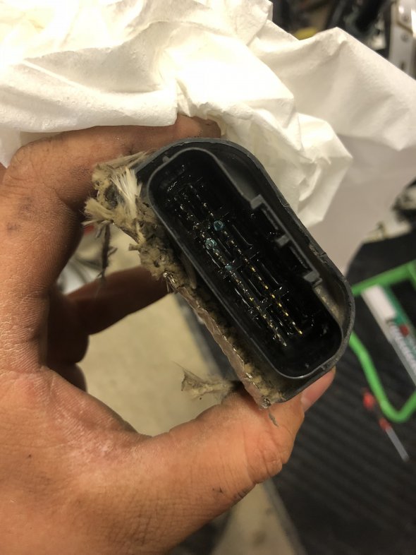

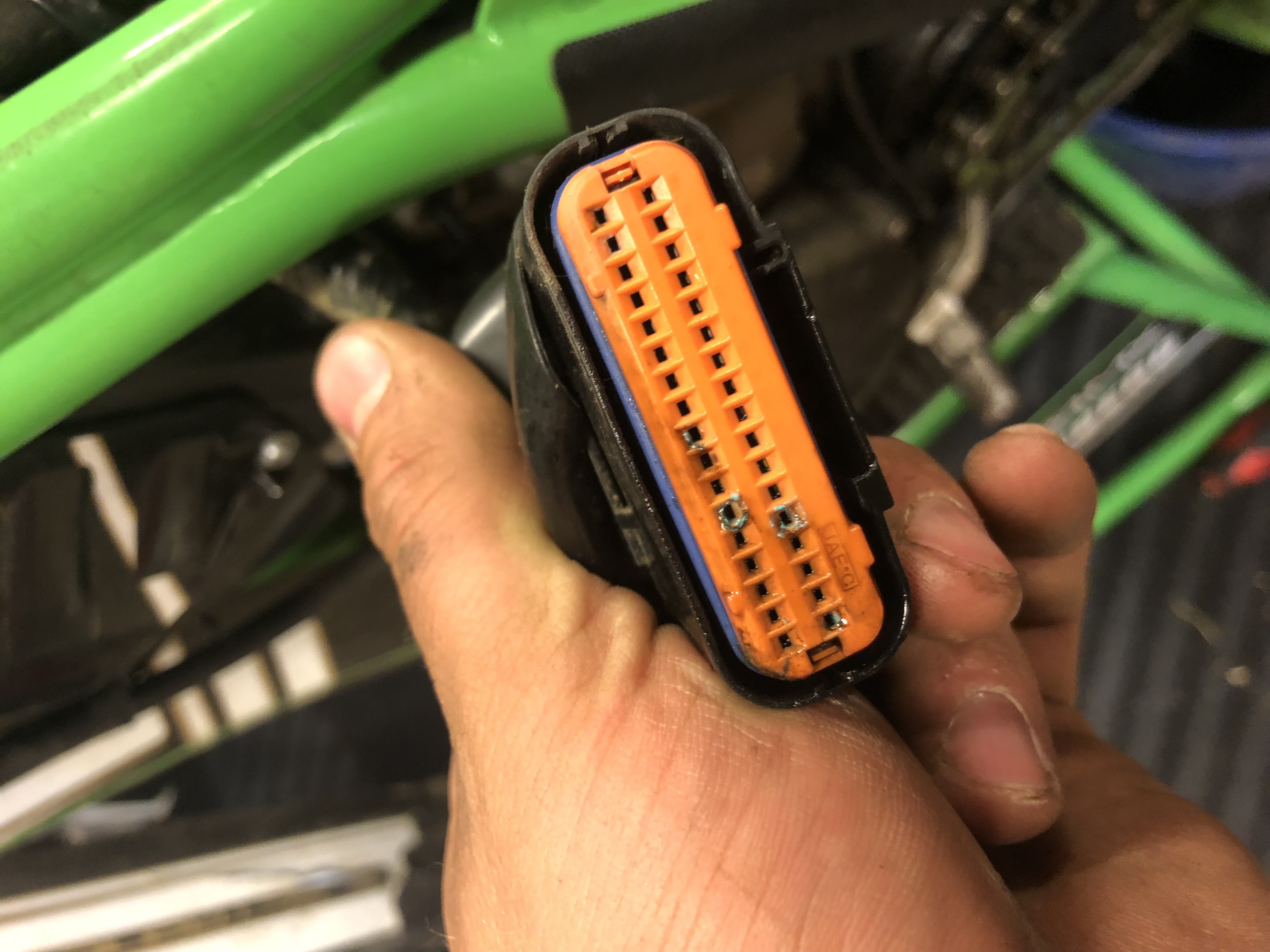

Hello.
Im hoping this is my issue and not a cracked cylinderhead. Found some corrosion. I’ve cleaned it out with some cleaning spray,  but I need to find some contact spray or grease. Took it for a test after I cleaned it and still no fan. It went a while longer before it boiled now, but that could be because of the chill evening weather.

Hi xull, looking more like a simple connector problem, that was a lot of corrosion on the ECU pins, definately squirt Wurth type OL in there, both plug and socket. As the bike was fine when put into storage, it is very unlikely that there is a head crack or O ring passing. The ECU takes the temperatrure reading as an input and will output a signal, probably a 12v signal, to the fan relay to operate the fan. This relay is located at the right side of the voltage regulator just below the "tank" cover. It has been know for these relays to work loose and therefore not operate, they are a plug in unit. Pull it out and inspect the relay terminals, they may also be corroded. It wouldn't hurt to disconnect all of the wiring connectors, spray them with type OL and assemble with dielectric grease. Good luck with this. Bye, Peter B.
I'm with Peter on this one... stick with the electrical stuff a bit longer. Look for good contacts at the relay and that the thing is earthed correctly, from memory it has it's own connection to the chassis. Since you have managed to confirm that the fan will run when powered directly try one step back and check the relay will drive it. I have successful used the little "Christmas tree brushes" you can get from a dentist or chemist (for between your teeth instead of floss) to clean the connectors,  fuel pump in my case, but they're all similar.  Good Luck :-)
