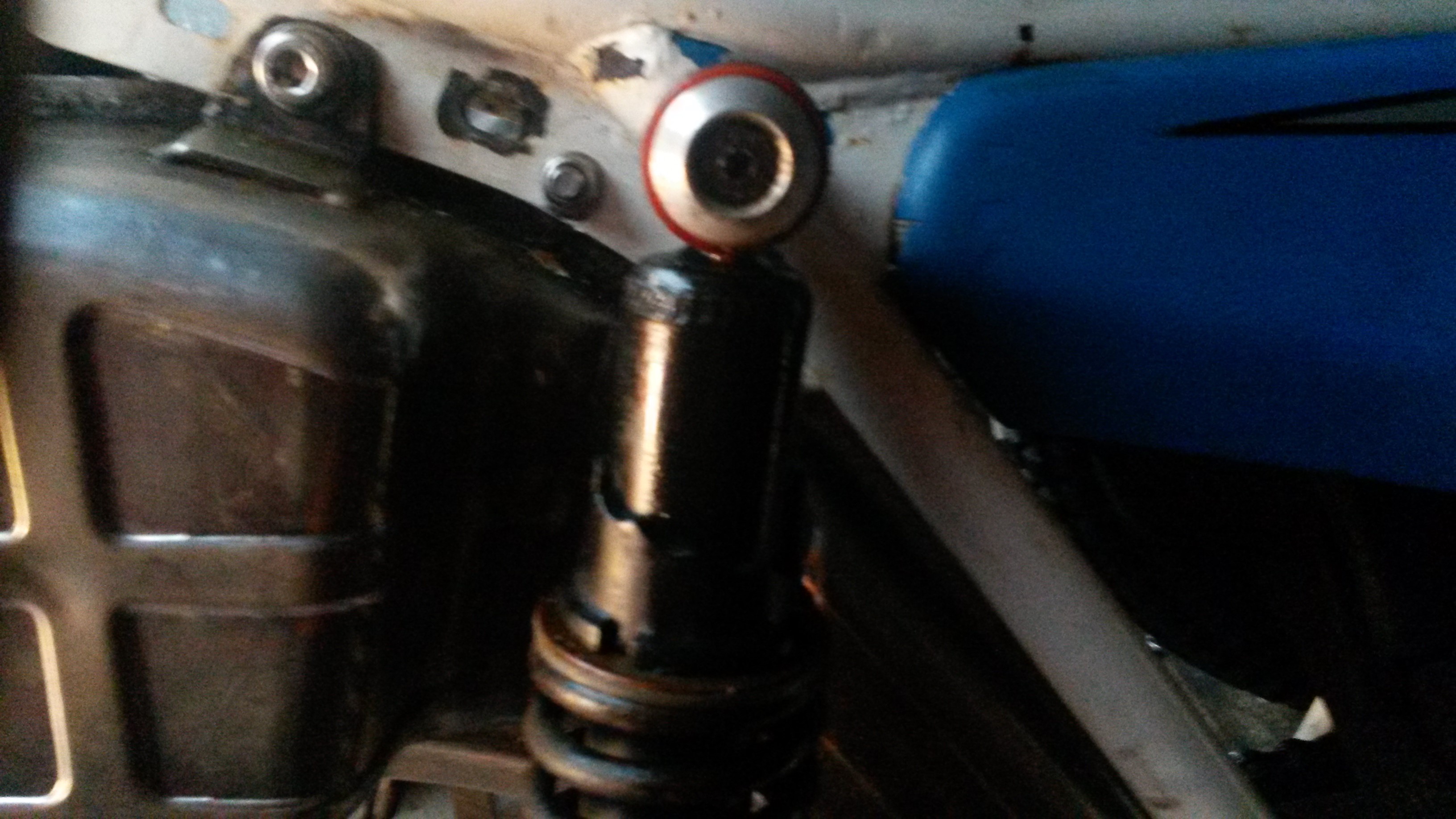

3.Swingarm shock absorber mounting fixing cant release  one upper allen key fixing as picture, it was badly rounded.Tried loads of release oil, shocking and a little heat with no luck. I need to replace unserviceable existing shocks.

About the countersunk screw....When rounded  sometimes you can take a hammer and bang in a torx bits. Not perfect but can work.
If the torx fix don't work, then I would suggest to grind a Slot (parallel groove) and use a big screwdriver, the thread might be shot, I would the insert a time sert thread form Würth, done so to the shock mount of my Sherpa.

That damper mount shouldn’t be that tight, try using a centre punch on the flat surface of the bolt to try and turn it....once t moves you can use an Allen key....the torx bit suggestion may work..has done for me in the past. Have you put correct amount of oil in gearbox?? Some Bultaco owners use 500cc others go to 600cc...either way too much oil and it’s going to leak out. Gearbox out put shaft seal can be replaced by first removing timing side engine case 4 hex socket bolts...note the one next to sprocket should have a fibre washer or similar between case and mounting post...now the gearbox chain sprocket, there should be a lock tab that will need to be freed...leave chain on you will use this together with back brake applied to hold gearbox sprocket still while you undo the sprocket retaining nut, this should be tight so a long knuckle bar should help with the correct size socket. Slide off and clean area thoroughly, now with great care prise out the oil seal ensuring that you don’t damage the seal housing. When you fit new oil seal take care not to damage seal lips...lubelips with either silicon grease, oil or high melting point grease...just to aid the seals life!

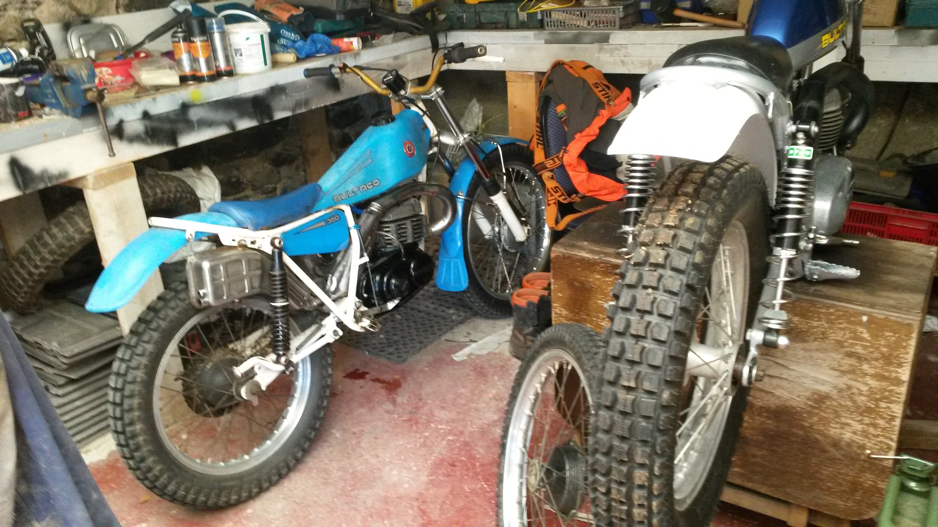

From the look of your workshop I’m guessing you already know quite a bit.

Gear lever looks to be mounted a bit on the low side.

  Shock absorber fixing. I tried torx bit hammered in, unfortunately slipped before loosening fixing. Hacksawed a slot next and tried with loads of pressure and a slot width fitting screwdriver,  head sheared off fixing under load. I am left with a tiny stub of fixing protruding from female threaded part. Looks like drilling out and rethread or Wurth insert? or cut off entirely from frame and reweld a new mounting boss as last options.
Oh well, There is always one.      Stuart.

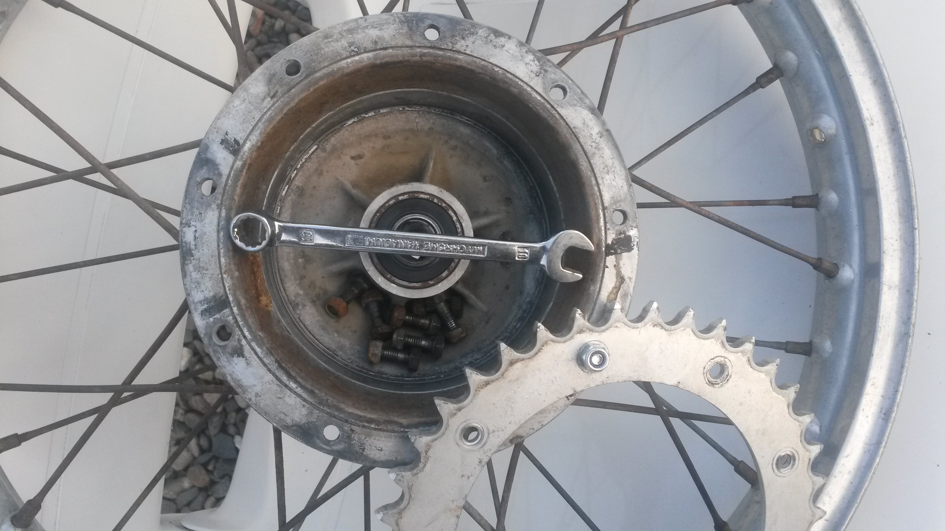

    I am now refurbing rear of bike. I have stripped rear wheel and brake hub, got a couple of broken spokes need replacing on the shorter hub/sprocket side as well as bearing, brake shoes etc.The hub side spoke ends are covered with a circular pressed? shroud/cover, Does anyone know best way to remove/replace it to allow access to spoke ends.i have looked at manuals but no mention.Tried gently levering with no luck, dont want to damage hub.heat?Any knowledge much appreciated.Will post a photo later.

To remove spoke cover disc, first remove sprocket. (Apologies if you've already done this).

   thanks for reply, i have now attached photo. its the cover touching both ends of the spanner.
