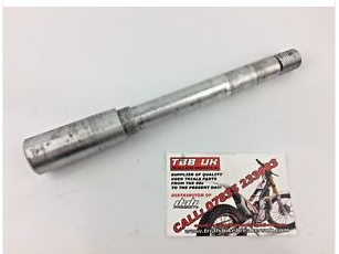

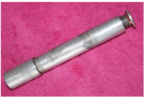

July 29, 20188 yr Depending on what year your bike is: You will need to remove the bolt that holds the shaft in place. Or you will need to unthread the shaft from the opposite fork tube ** both photos from Ebay listings bymdyztri and trialsbikebreakersuk respectively **
July 29, 20188 yr Author Ok thanks, so I think I have the first one, as it has a large Allen key cap in the end. So do I do the clamp bolts back up and then unscrew this cap, then undo them and withdraw the shaft. Really odd set up if you ask me...
July 29, 20188 yr 44 minutes ago, Fatboydel888 said: Ok thanks, so I think I have the first one, as it has a large Allen key cap in the end. So do I do the clamp bolts back up and then unscrew this cap, then undo them and withdraw the shaft. Really odd set up if you ask me... it is not an odd set up at all ,its designed to be as easy as possible to remove and replace the front wheel........it could not be more simple........if the spindle is threaded and screws into the fork leg then there is a chance of damaged threads while rushing the job spoiling the party and it is slower to get back together ...not what you want hallway through the Scott or SSDT trial. Yes obviously tighten the pinch bolts on the right fork leg [kick start side]to stop the spindle/axle from turning but have the left side pinch bolts loose then remove the end cap by turning it anti clockwise[ normal threads]that is there to stop the spindle from falling out if the pinch bolts were left loose or snapped . Edited July 29, 20188 yr by oni nou
