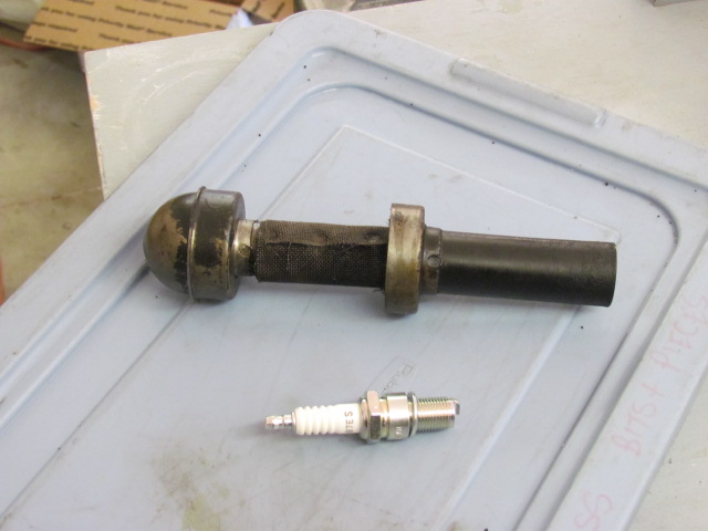

If its alloy you may melt it, steel is ok to burn.

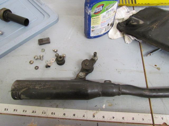

This one is steel outside including the tail pipe, but i will check to see if any of the end covers are something else.  I think there is a rubber gasket and a rubber flap just at the joint between the two pipes?Maybe that is part of the air box, and there is a rubber shock mount thing on the tail pipe that will have to come off before the fire gets lit. And some hardware etc etc.  No problem, but thanks for the heads up. I think I did see one TY at the last trials event with an aluminum tail pipe "box" and yeah that would not be something I would put in the fire anyway.  I have some 15 years as an amateur machinist and now I'm getting into aluminum foundry work so I have a pretty good idea of how thin aluminum can be damaged by heat.
So if I read your description of the area ?that you ride correctly you’ll need the following.
1 a big hand gun of some sort?say a Magnum and ammunition....for the bears. 2 a very loud screeching horn....for the Wolves. 3 a sat phone like Lone Survivors team used ( Mark Wharlberg) 4 comprehensive first aid kit ?with snake ? bite serum.  5 a good camera? so you can make us all envy where you live with all that scenery. Bottle of water and food.??☕️

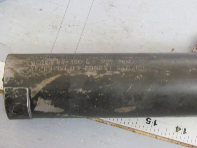

If your tail pipe is the genuine Yamaha item made of steel then it should be classed as a spark arrester....to be legal will you not have to comply or are your cops lenient. If your bike is noisy will that in itself drive away any bear of wolf pack, it would be very scary to have to stop and repair your bike only to have a Grissly passing you tools?? and the wolves making camp to watch⛺️

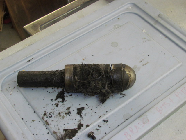

Standard TY250A end muffler has a cast aluminium swirler inside that is part of the patented "Yamaha-Krizman" spark arrestor mechanism. If you burn this muffler out, the swirler usually melts and the motor then runs much better

I cleaned a few muffler by burning them, but I never '' played '' with the baffle, I have a couple on the shelve coming from different basket case I bought a few years back. That's why my comment started by I don't think.
True on all that equipment except the snake bite kit.  No snakes up here.  The hand gun is too heavy to lug around. I will take some pics of the innards of the tail pipe and you guys can tell me if there are any parts missing as far as a spark arrestor.  I did not see anything like that inside, but there was just the oil soaked packing material that looks like fiberglass and the tube assembly that holds it in place.

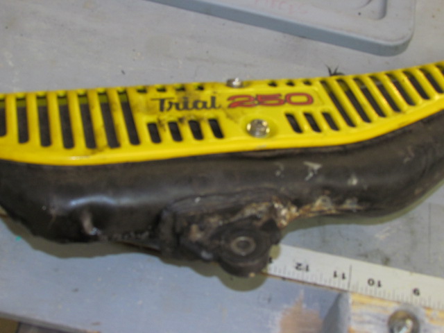

  I started a thread asking about cleaning the tailpipe and got side tracked a bit.  Can anyone look at these photos for me and see if that intake side port opening looks damaged or modified or normal? in some way?
It looks to me that one side of the opening is lower than the other, and somehow it might have been caused by someone in there with a grinder?  The right side of the image is much shinier than the left side as well, so I don't know why that would be the case.  All I did was wash the whole jug with water and a solvent and I did not scrub this area on the right any more than I did on the left side.  So something has been in there either with a lot of heat or what is your esteemed opinion?  Before it was washed there were also tiny beads of silver colored metal stuck to the intake port surfaces but only on that same side.  These beads were on the order of .005" in diameter and resembled weld spatter from a MIG welder.  Any ideas?  I had some detonation issues while decelerating with the throttle closed (My bad) as I was thinking that the engine would cool itself down better with the throttle closed than by blipping the throttle with the clutch pulled in.
I was emailed by Millenium Technologies today.  (8/22/18) They changed what they were going to do to the cylinder and instead of a bore and Nikasil they are going to re-sleeve it and hone.  The price dropped about 50 bucks so far from the original estimate.  I will try and call them tomorrow and see what happened to make them change the order, but I would think it was the abberation at the intake port.

Guys,
  Well, Millenium got a look at the original cylinder and decided to pass on it.  They said it could be re-sleeved, but the aluminum part of the cylinder had been modified and would not be an economical candidate for further repairs.  The problem would have come when trying to make the aluminum part of the cylinder match the original contours under the liner which had been cut away by the modification of the previous owner.  So rather than pouring more money into something that may not work, I bought another cylinder on Ebay.   I inspected it for signs of damage or deterioration or modifications and there was just the normal wear.  The intake port was symetrical and had not been modified. So it's on it's way to Millenium now.
