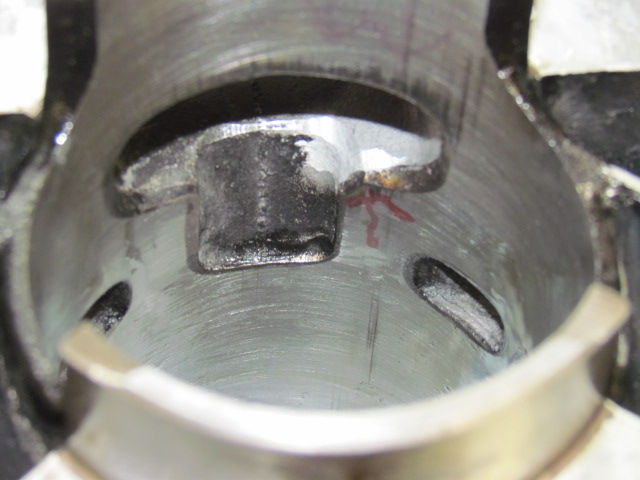

  I started a thread asking about cleaning the tailpipe and got side tracked a bit.  Can anyone look at these photos for me and see if that intake side port opening looks damaged or modified or normal? in some way?
It looks to me that one side of the opening is lower than the other, and somehow it might have been caused by someone in there with a grinder?  The right side of the image is much shinier than the left side as well, so I don't know why that would be the case.  All I did was wash the whole jug with water and a solvent and I did not scrub this area on the right any more than I did on the left side.  So something has been in there either with a lot of heat or what is your esteemed opinion?  Before it was washed there were also tiny beads of silver colored metal stuck to the intake port surfaces but only on that same side.  These beads were on the order of .005" in diameter and resembled weld spatter from a MIG welder.  Any ideas?  I had some detonation issues while decelerating with the throttle closed (My bad) as I was thinking that the engine would cool itself down better with the throttle closed than by blipping the throttle with the clutch pulled in.

thats just a tidy up with a small grinder, maybe at the factory
Looks normal.
Look like the sleeve as been changed and they '' matched '' the new one with the cylinder

  Now that makes more sense than anything I could think of.  Reason I'm asking is that I have that cylinder sent out to Millenium Technologies for a rebore and Nikasil.  I don't know how many hours it has had on it, but when I had it in a local MC shop they ran a hone thru it to take out some of the scuff marks from the piston and rings.  The shop owner said the cylinder was a little out of round and you could hear the hone speeding up and slowing down presumably from the out of round condition.  I measured the bore in one spot above the output port and it was still right at 70mm, so I think the sleeve that is in there now has not been re-bored oversize.  But since that area on the right has been modified with a rotary file or some abrasive tool, it does probably mean that the aluminum outside the sleeve was not touching the liner so they ground down the liner until they had full support from behind.  I wanted to get as many eyes on that as possible before they call me from Millenium and say whatever they are going to say.  I am about 50-50 on trying to find a better cylinder to put the money into, and I think a re-sleeve would be several hundred dollars where maybe a cylinder that was worn but in better shape could be re-bored as is and end up costing much less out the door because it would not need to be repaired first.
personally, I think you may be nuts! do you see any other edges that do not line up like a factory cyl? re-sleves are not that clean.

All the other edges in the cylinder line up perfectly. It was just this one spot that was low (high) because the pic was taken with the cylinder upside down.  I am not a 2 stroke authority at all, but I know that the rattle was getting LOUDER the more I ran the bike.

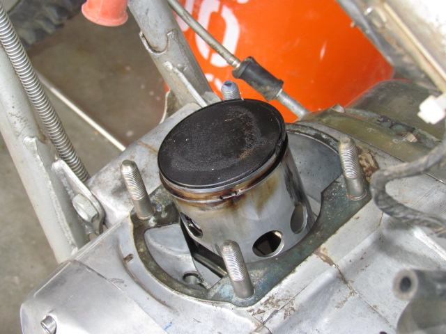

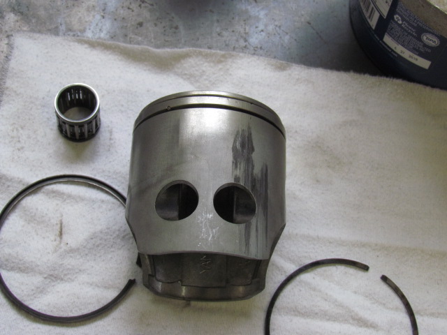

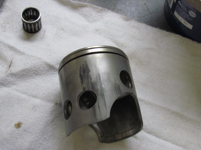

If the piston had come out of that bore clean, then I would not worry, but it had an  area on the rings and directly below that about 1/2 inch wide and extended down the piston most of the way to the edge of the skirt. In that area the piston had seized before.  I don't know when, but it had seized at one time or another.
I don't have pictures of the rings, but they were nicked in 4 places near the ends where they pass by this red arrow area in the cylinder. Also some micro beads of metal were stuck to the inside of the intake port. (same area)
Knocking - I think that was my fault. The more I read on here the more it sounds like a bad idea to do any engine braking with a 2 stroke. And I was definitely doing that.
Rattling-  Well the rattling was getting louder and added to the loud bang when the cylinder would fire with the throttle closed.  It seemed like a good thing to go inside and have a look.
As it turned out, the piston to bore clearance was at the max limit after I had the bore honed to remove the glaze.  So at a minimum it would need a new piston and rings and an overbore anyway.

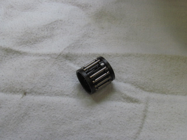

Then when I looked at the small end bearing it was missing a roller!  WTF?

When you ride with throttle shut you restrict petroil mix from the piston and hey presto you get piston nipping and score lines on the piston skirt. The porting photos look like there may have been a weld repair done and then a clean up. The honing marks look a bit course from the photo and what appears to be cleaning rag fluff. The port itself would benefit from a gentle clean up or smoothing.
