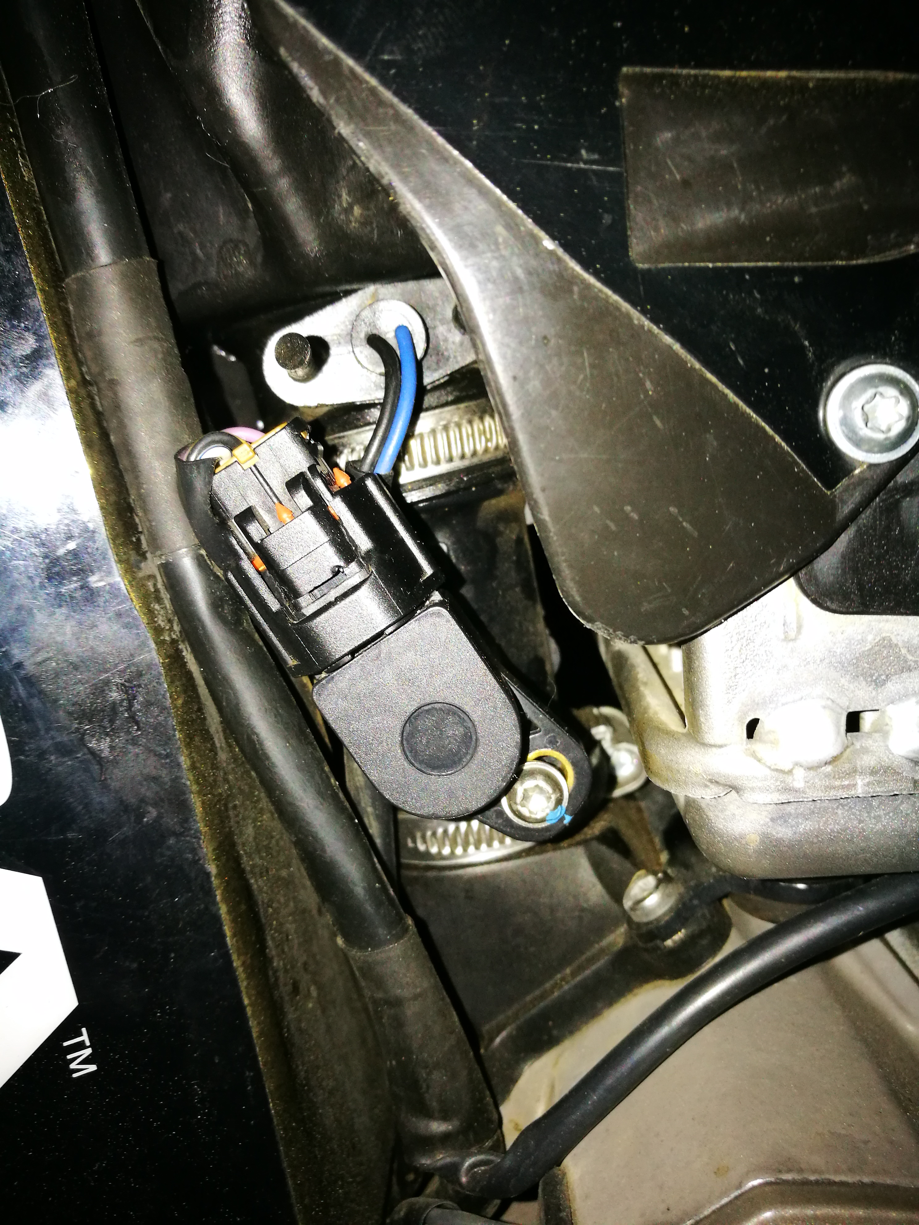

move the position of the sensor affects the carburetion?
Do not touch! Yes this is the throttle postion sensor..It is VERY sensitive.
I had taken it to clean the filter in fact now the carburation is fat, the spark plug is black

Ciao, il sovrafiltro l'ho già montato, stavo facendo manutenzione straordinaria visto che il precedente proprietario era quello che era, da sciocco ho tolto il sensore, ora devo regolarlo con kscan

Yes, the TPS is VERY sensitive and critical to have as correct as possible.  I find I need to reset it about every 100 hours to keep the bike running properly. You must have the software and cable to set it.
