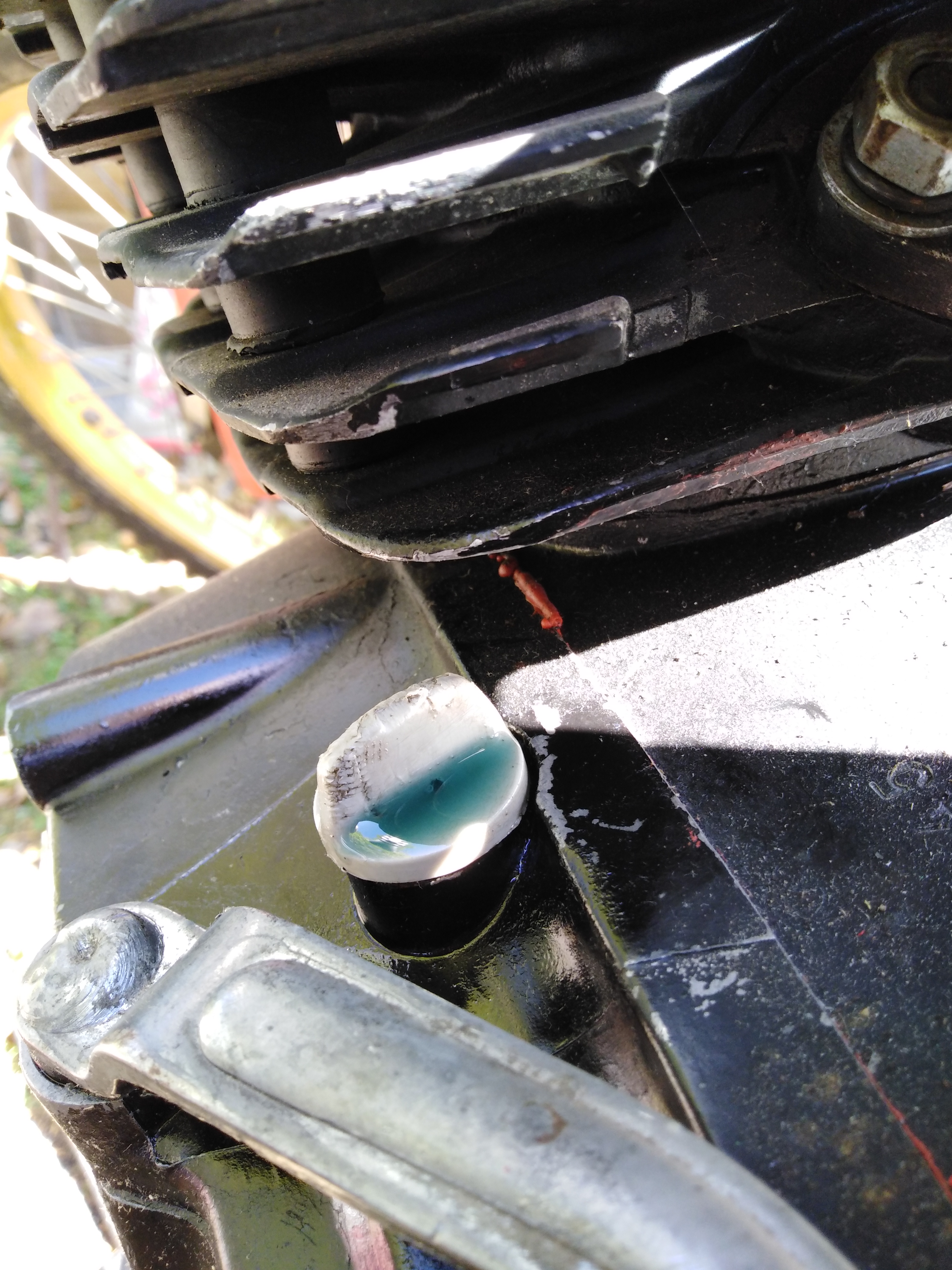

Just drained this out of my Cota 349 as mentioned in a previous post. Should I pull the clutch cover off or just wash it out, refill and see?
Cheers.
Not a big deal. A common sight on a trials bike that has ridden a wet trial. I would just fill it with fresh oil. Next time you ride in water it will probably do it again. Sometimes wet oil affects the action of the clutch but if you didn't notice, then I guess yours doesn't get affected.
It hasn't really seen water apart from damp grass. I"m washing out with white spirit at the mo'

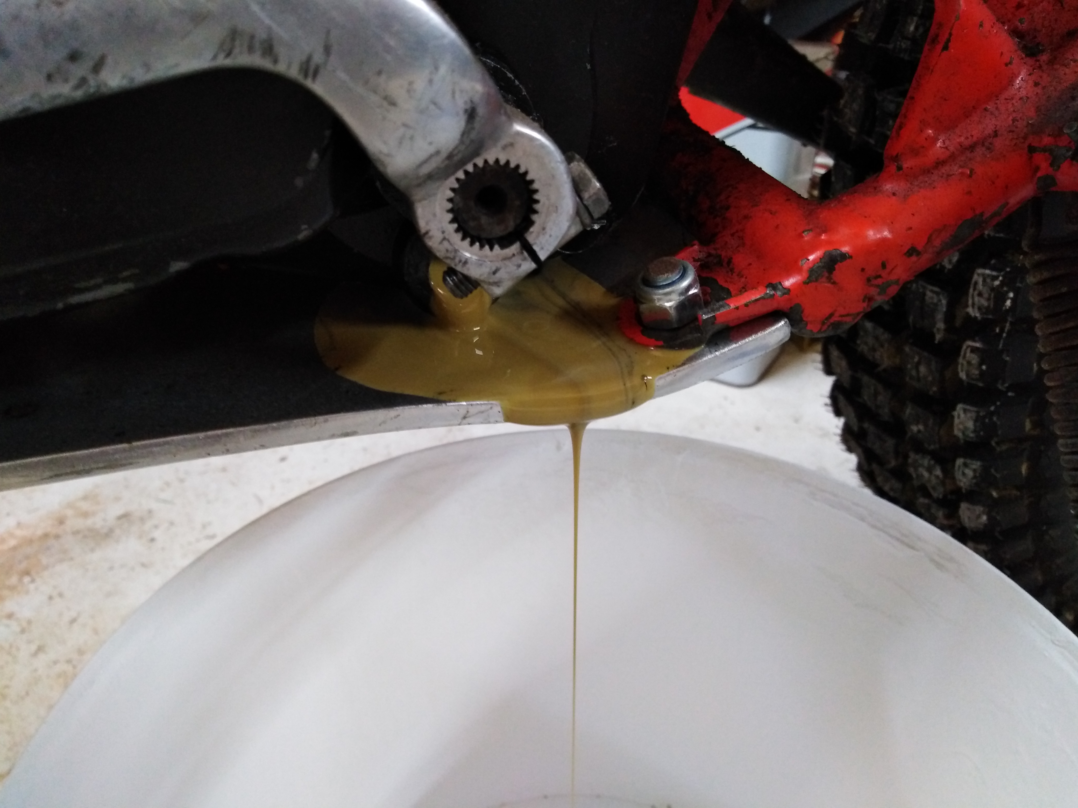

What did the gearbox oil look like?
Golden and lovely. Where would the vent be? Someone said it could be blocked which could have caused the bubbling from around the clutch arm when it first happened.
I've washed out with white spirit and refilled. Slightly milky seepage from gear and clutch lever shafts. Undid filler and it is under pressure. Where's the breather?

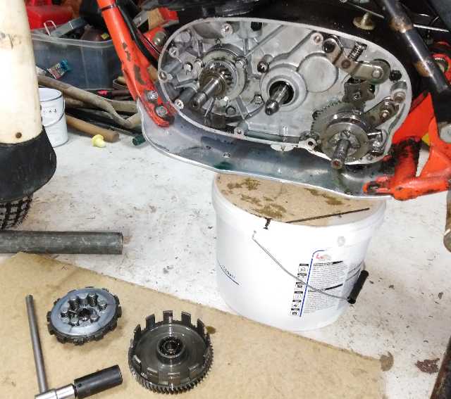

Had a short chat with the guys at InMotion who reckon it is the crank seals. Pulled everything off with remarkable ease. I love the design of the clutch assembly which came off in one piece. Need to get a puller for the gear on the crank in front of the seal.
I will be interested to see if you still think it is easy to work on after you get the primary gear off
Well You will have the last laugh....
Any sage advice for this recalcitrant bugger?
Make or find a puller that doesn't damage the gear teeth. The usual two or three arm puller will likely not be able to pull hard enough and will damage the teeth. A suitable puller will pull against the back side of the gear without touching the teeth and it will pull on the whole surface, to spread the load better. I made a tubular puller that is in two halves. There are discussion threads on this forum that cover this job in detail. I can do photos again if the thread has disappeared.
