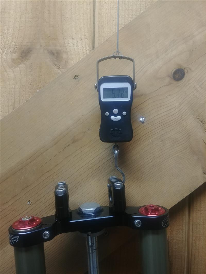

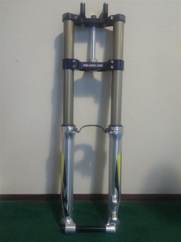

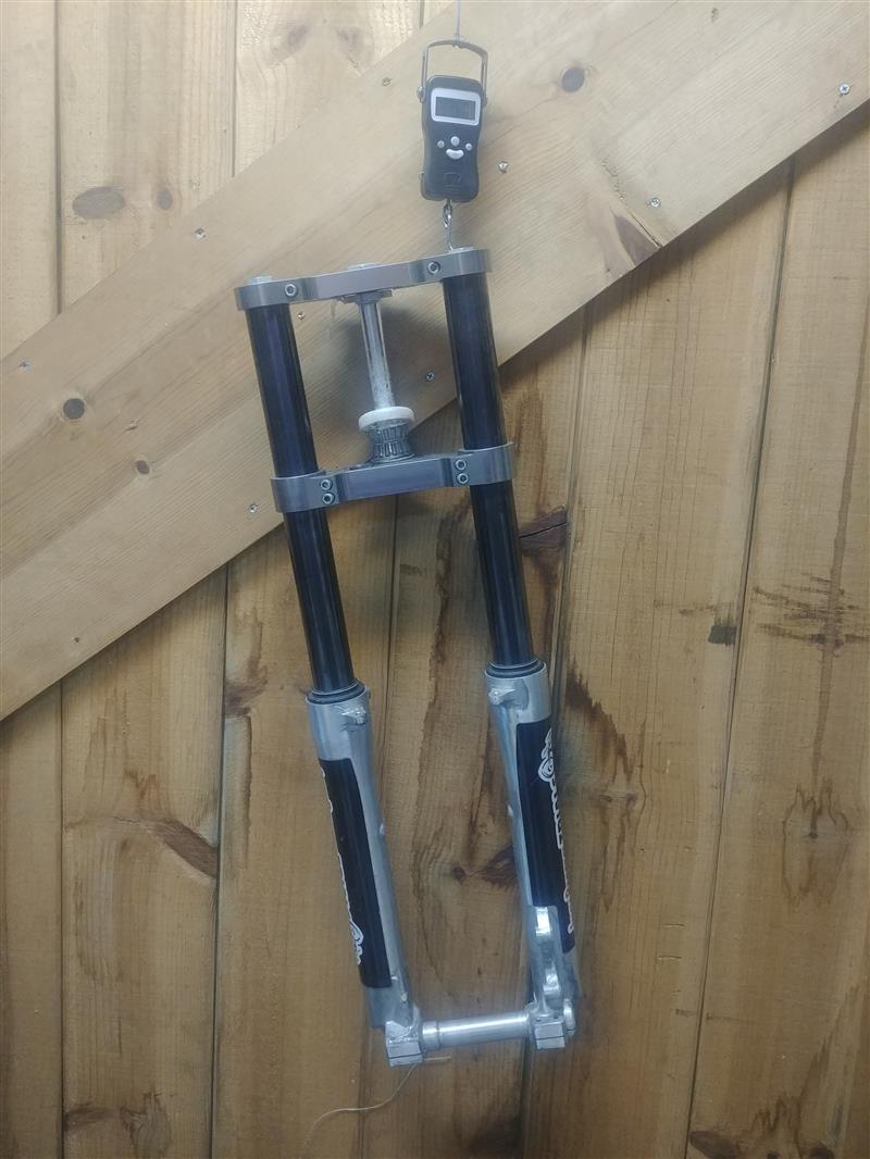

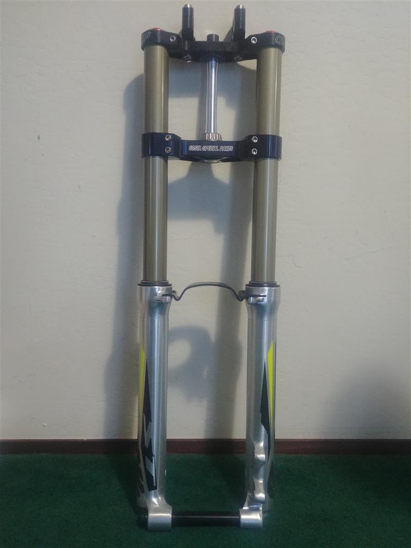

November 1, 20187 yr Author For those who are curious... I just weighted both the Tech and Marzocchi fork and here is what I got: Each assembly was with the fork, front axle, triple clamp, steering stem, bottom bearing, steering nuts. Triple clamp for the Tech are Costa Special Part units The Marzocchi is the older model without the slimmer tubes in between the two triple clamps. Tech - 5.72 Kg / 12.6 Lbs Marzocchi - 7.6 Kg / 16.7 Lbs So close to 2 Kg / 4 Lbs advantage to the Tech fork. Not bad!
