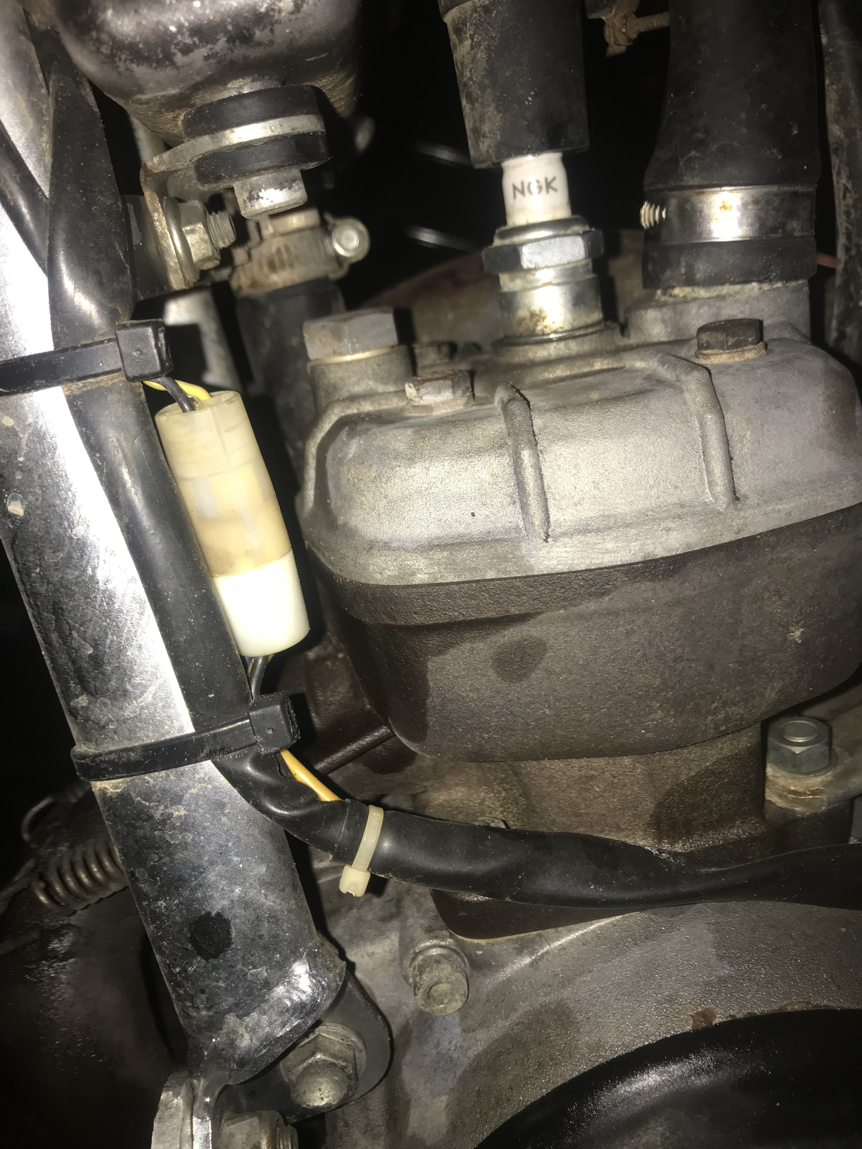

Then, I noticed this:
I guess that'd cause it to be hard to start, huh? Gas was squirting out of it and the head pipe while trying to kick it..
Anything else y'all can think of to check first before ordering parts? Spark is good, it's wanting to start. Compression is 165psi. Seems high for a head problem. Rings, piston and cylinder look fine but I haven't measured ring end gap yet; just a quick look through the exhaust port.
