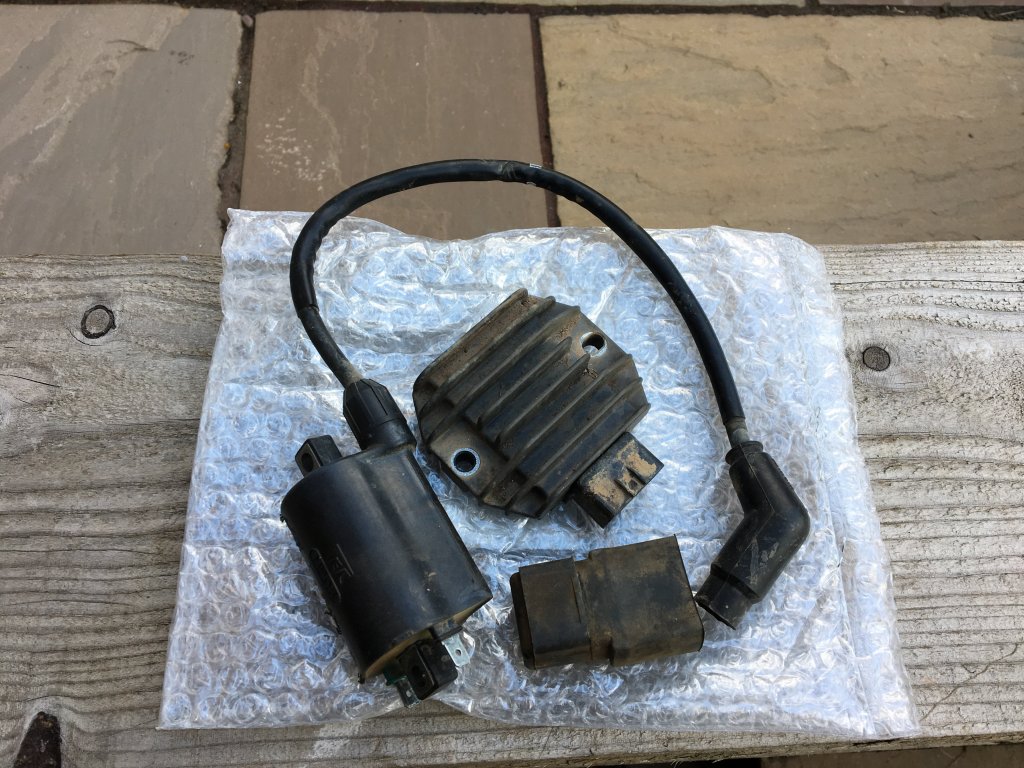

Hi Richard, yes my bike has ran perfectly since, The Inch Perfect Guys first changed the thermostat switch but then I still had issues and they believed the issue with me dropping the bike damaging the thermostat had as John says caused some sort of spike, Matt sent me 2 components to fit as they was sure it was one or the other, I fitted both and have since been living the dream ?
Look at the photo
