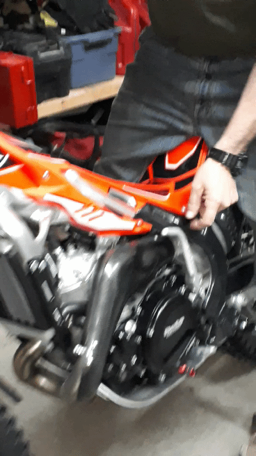

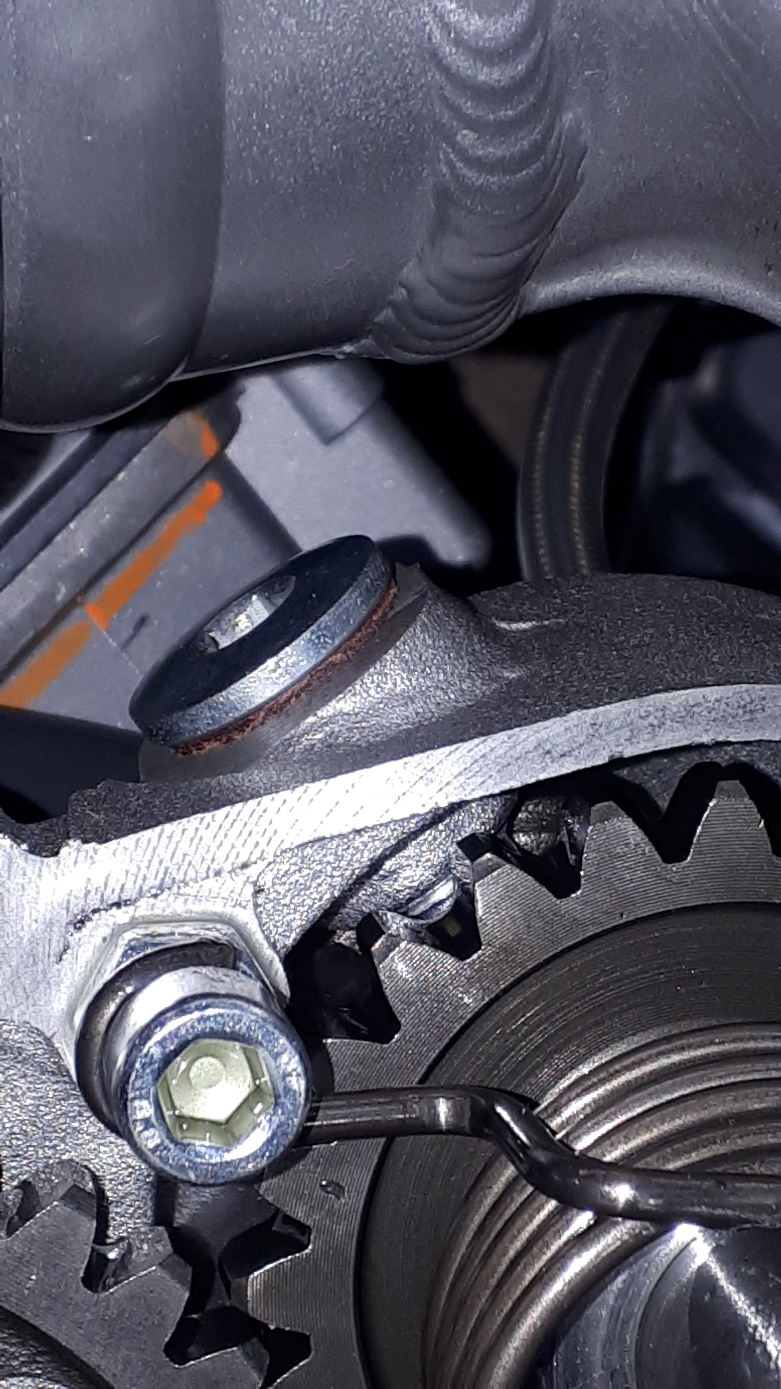

Also took cover off to see anything obvious but no avail. Only thing I see is the "position/retainer bolt" above the kickstart assembly (see pic) seems to be putting a lot of friction on the last part of the ignition sleeve/stopper tab that impeeds a full easy return. I also attach a GIF as to the "nuging" into most forward resting spot.

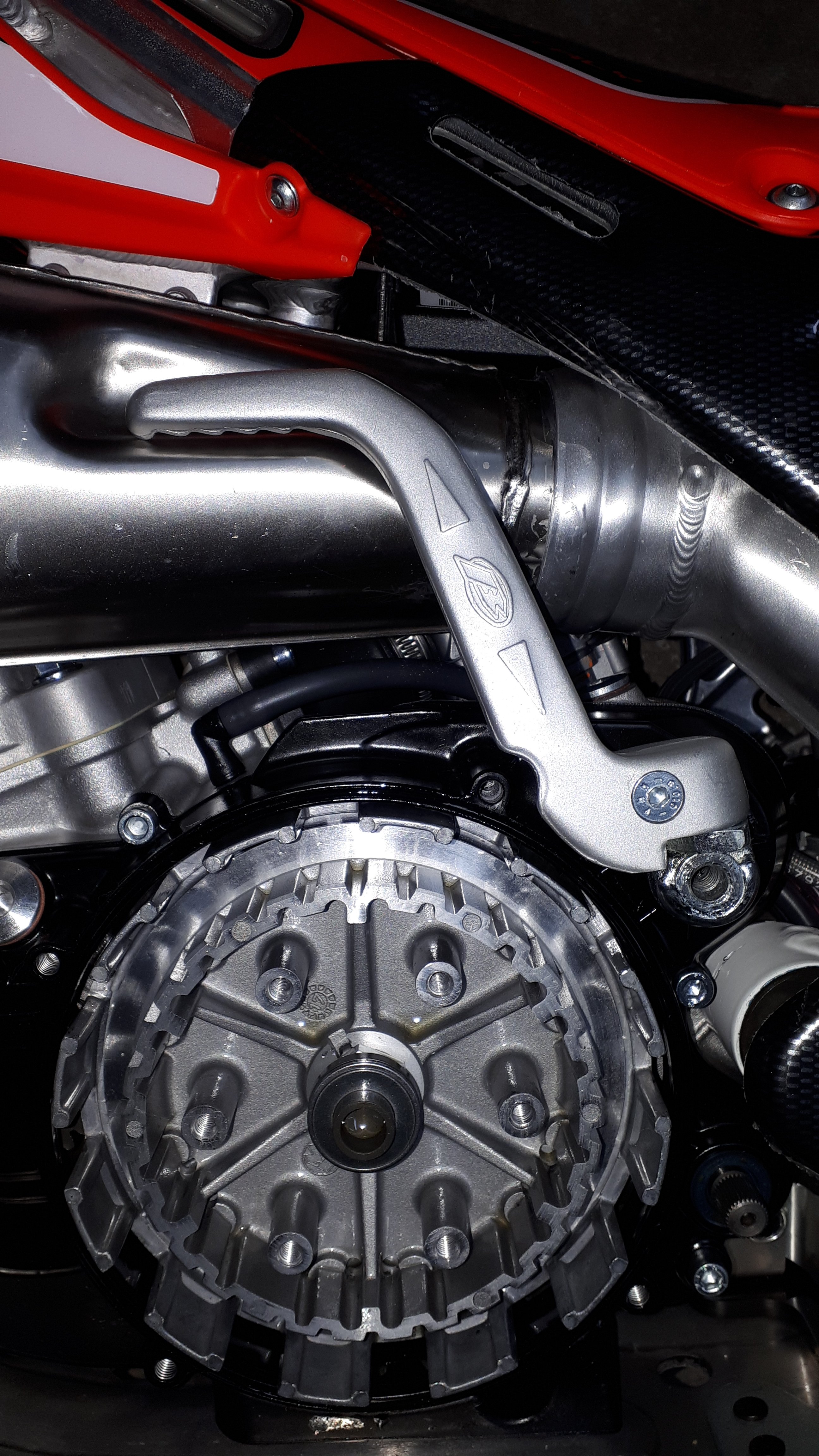

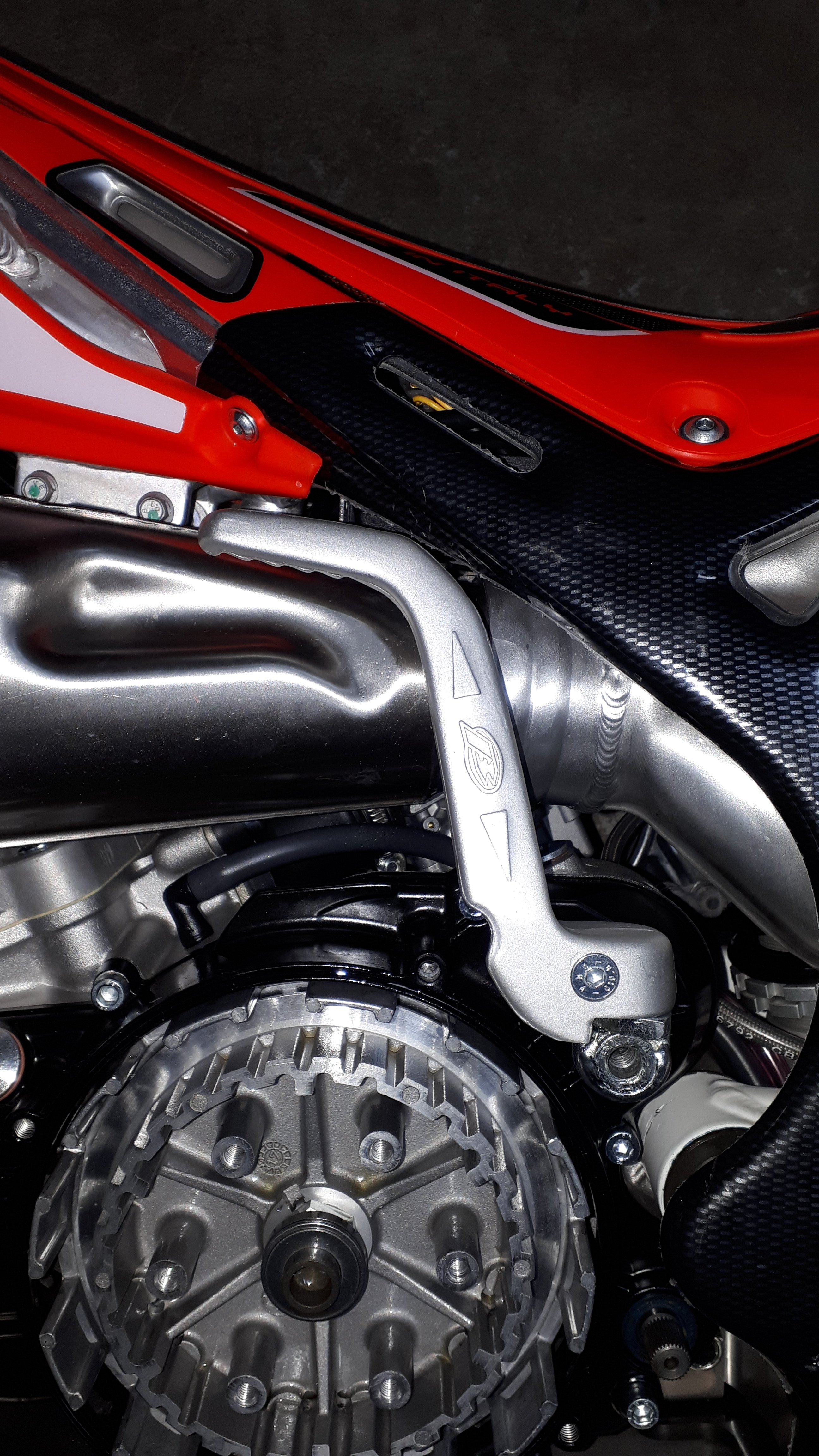

It looks to me like your kickstart is fouling on the big exhaust cover that you’ve got fitted , have you tried it with the cover removed?
The issue was present before all the guards added. The kickstarter is about 1.5 inches away from the cover.
I need to push it back into it's original most forward position until it reaches its stop lip. And nothing to do with the bringing inwards in stow away position.
lineaway sounds right, what happens if you rotate the lever one notch forward, does it go straight back to the correct position then?
Seems like normal function by watching your clip there. The kickstart ratchet gear has a small ramp on it that slides in behind a metal tab and the casting is usually not very smooth and your bike is brand new. Try let your kick lever snap back on its own with the spring loaded...will loosen up with some use. :)

I am not familiar with the bolt above it in the casing. Does this hold the assembly in place? As I am looking at this bolt, this is where the ratchet gear/ramp/stop seems to "nuge"onto it.

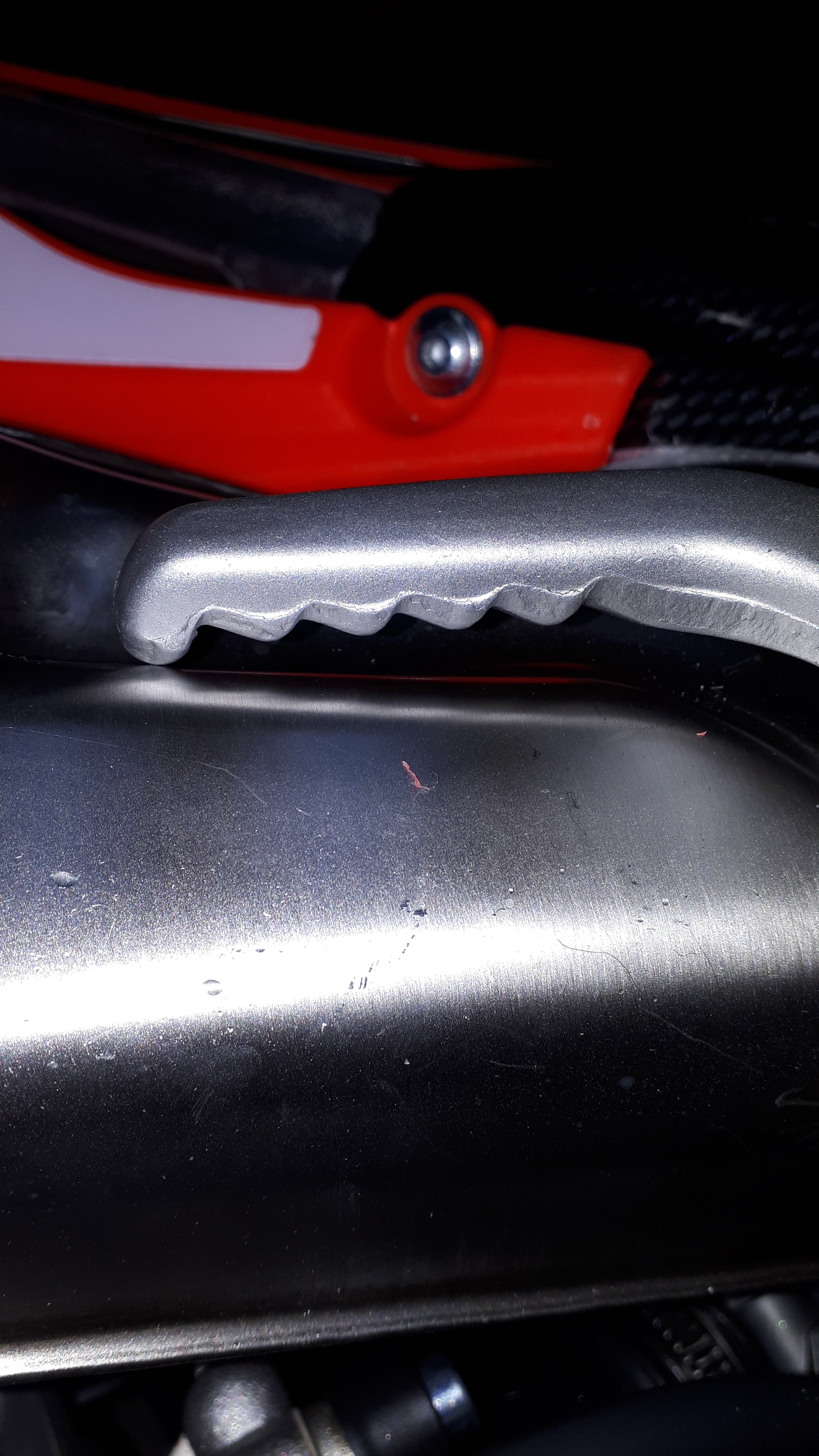

 Had loads of Betas & never had any bother with kickers of gear levers. Carbon fibre pipe cover a complete waste of time unless you have a 4 stroke, in which case they are essential to stop you burning holes in your pants  Kickstarter supposed to sit so it folds into the recess on the pipe. I think that's what BETA intended, but have seen plenty of kickers in the wrong  location. Gear lever main section wants to be more or less horizontal.

 I am sure he removed the bolt, which is the detent for the kick start sleeve. Now it has to come apart and be reassembled properly. Which means removing the clutch. People do this all the time. Not reading the service manual before they start removing bolts. Beta keeps this well hidden under the mid pipe. It is not hard to fix, just time consuming. In fact it sometimes can be done just pushing the KS pedal halfway down and ibstalling the detent. But since he opened the case, the whole thing is better off coming apart. Great way to get to know your new bike.

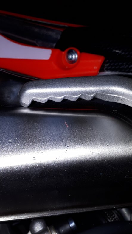

If I moved the kicker one cc it sits on and not in the crease dinging the expansion chamber/pipe. See pic below. These are the only two position offered on this bike. The later one is how I got.
Didn't touch the bolt. When I took the cover off I did notice that it was holding/position something. Looked at service manual I have on hand and no mention of this bolt. That's why I am trying to get as much info to be better prepared. In my 20 some years in different moto disciplines, I've learned to be well informed before taking on certain tasks. Most service manuals are lacking some info.
