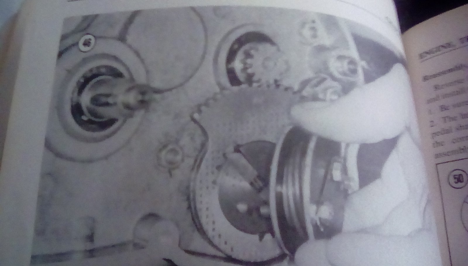

Also it only selects 1st and 2nd at present, after the previous owner did some home maintenance. He didn’t split the cases so I assume it’s just a case of getting the selector set up right. I know there are a few posts on this subject.

If memory serves, your selection problem is caused by the drum in which the pawls slide having been put in upside down. The groove for the pawls is offset from centre.
This is correct: getting 1st and 2nd only is the classic symptom of the pawls carrier being upside down. The slot is not quite central, but appears to be at first glance.

I'm a little bemused by the selector issue in as much as i've taken the primary casing off and i've found that the line and dot correspond when in neutral.
BUT, ive looked at other images of similar Montesa selectors and found some with a spring loaded wheel mechaism which is missing on mine.
My frame number is 51M 3188 which i believe it indicates it to one of the early batches of production, is mine missing this part????????
The first image is my bike the second is an image ive borrowed to ask the question, am i missing this spring loaded mechanism?
If I am missing this id like to bring it to the attention of the gentleman i purchased it from asap.
Thanks everyone.
Try undoing those flat-head screws to remove the shifter return spring assembly. Behind it you should see the spring-loaded pawls in their slot. That carrier needs to be removed and put back the other way up. Photo below shows the set-up on the Cota 247, which is similar.
