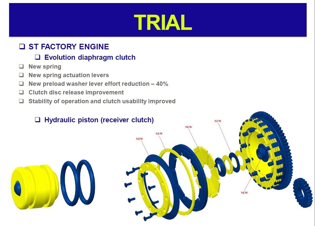

Am assuming diaphragm clutch.  Gotta say, I'm not a fan.  In my experience, seemingly small dimensional changes cause large changes in operation.  I admired Sherco for sticking with what worked for so long.

I'm assuming the diaphragm clutch Shercos use mineral oil in the hydraulic system, so this thought is predicated on that being the case.  If you're seeing a swelling of seals, this indicates a cross-contamination of fluids.  Historically, Sherco used DOT4 in the clutch hydraulics.  If, at some point in the bike's life, someone inadvertently put even a small about of DOT4 into a mineral oil system, I could see it causing symptoms like what you are experiencing.  If it were me, I'd do a complete flush of the hydraulic system if I found swollen seals.
I've also attached a page from Sherco's 2019 press release.  Looks like they changed a lot since the prior model year.   Can you find a specification for the clutch pack thickness?  What does yours measure?

Unless it shipped with dot4 in it, which is unlikely, it's only ever had mineral oil in it.
Clutch pack would not be relevant to the symptoms.
