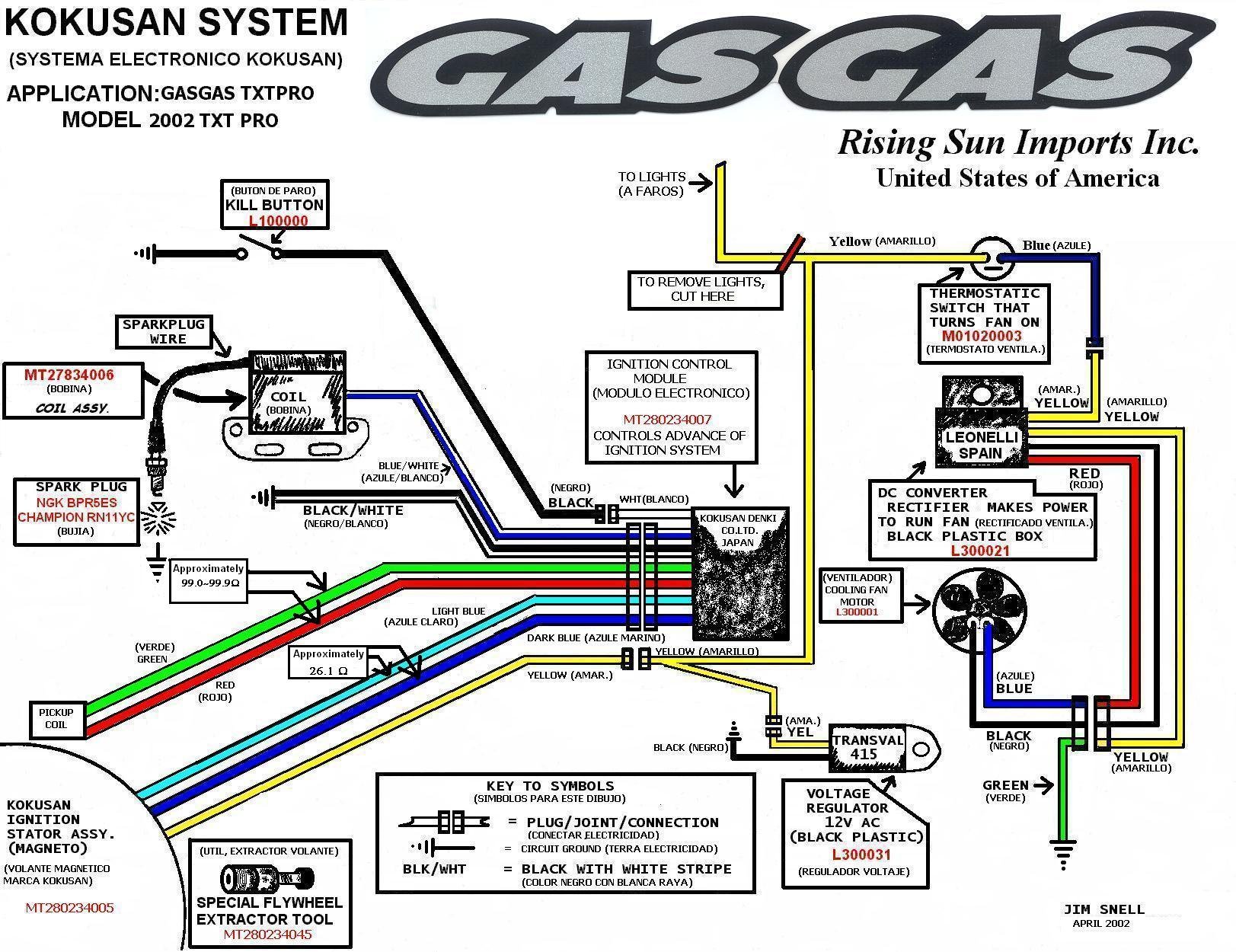

just wondering if anyone can help me with this. I have a 2002 Gas Gas txt pro which has a V5 so I have a number plate for it and technically it could go on the road.
Although I can’t for the life of me see how it would get through an MOT. Did these bikes come with indicators and brake lights originally. I’ve had a look at a wiring diagram for the bike and it just shows one wire that it says to cut if you want to remove the lights
Any help with this would be grand

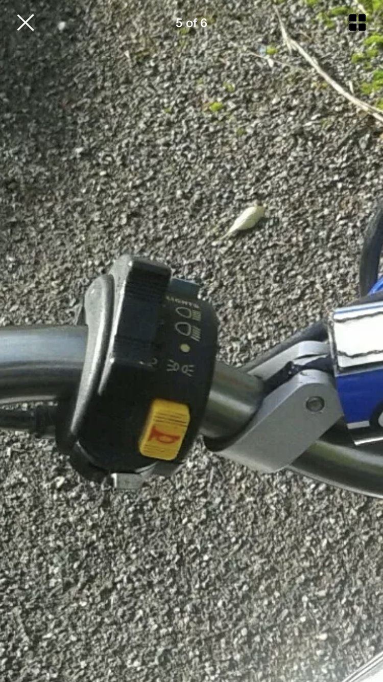

Hey thanks for that, this bike originally came with lights and switch gear which I was going to try and source to put it back to original but they seam a little allusive to find.
I believe it looks like this.
I was told one just sold on eBay but I missed out
I thought they would have at least had to have a rear brake light but the wiring diagram doesn’t seam to show anything like that.
That thingy is difficult to trace but not impossible be prepared to pay around 100 - 150€ for that lights / flash lights / horn / engine stall combo!
Very period correct if colorful, there are new ones just in black available for the same price range!
I have them on my bikes too:
See on the Aprilia and the Montesa and on the Bultaco, (no near Image, the ones on the Montesa
and Aprilia where mounted from the beginning on the one for the Bultaco where back then mounted
by the German importer because we needes to have a different switch, the original Bultaco was back
then not sufficient):

I’ve been looking for a while for them. I’ll see what I can come up with and take it from there.
Here is one available:
https://www.offroadracing-pilz.de/Teile-Shop-fuer-GasGas/ARTIKELLISTE-ERSATZTEILE-ZUBEHOeR-FUeR-GASGAS-NACH-ALPHABET/S/Schalter-Kombischalter-HS1-fuer-GasGas::10765.html
Time period Right is a Marathon of asking Dealers if they have them still in the inventory or if they know someone that might still have them, that is they way I traced them so far.
Edited by pschrauber
