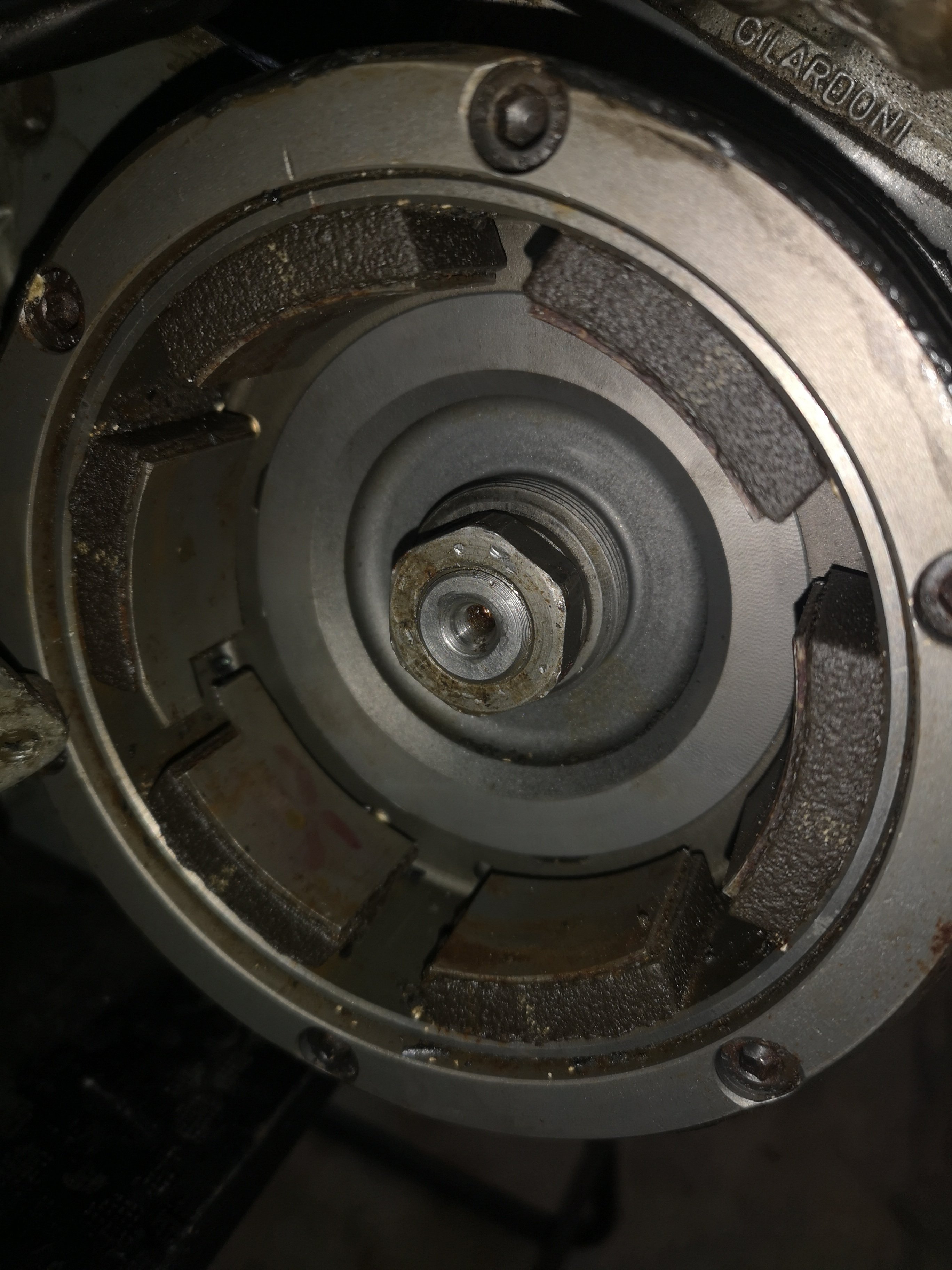

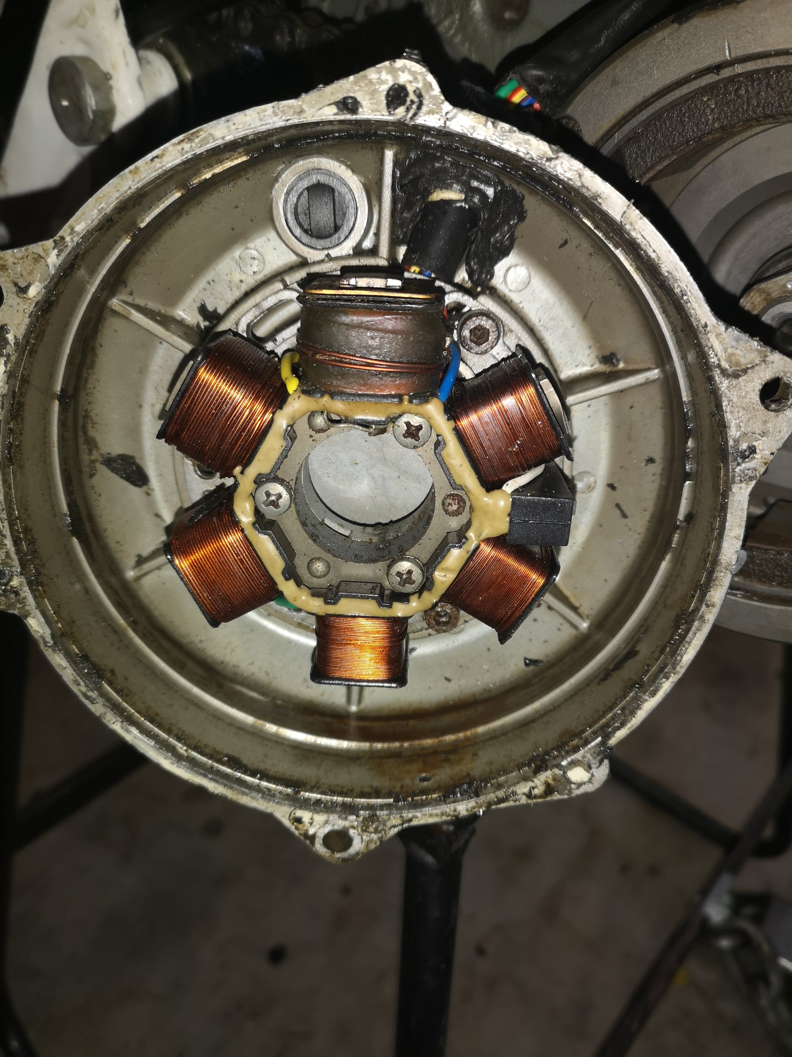

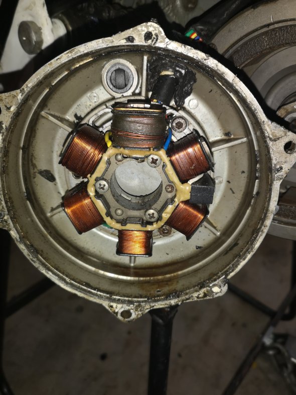

So after the weekend trial had issues with the bike bogging and cutting out after 10 minutes of riding ......I've stripped the carb I'm gonna ultrasonic it this week but I checked the Magneto see pics some rust and damp in places is this an issue could it cause my symptoms
Whats been going on with that flywheel locating nut, looks to have been punched with few blows to possibly make it a tighter fit (staked) with regards to coming undone. The waterproofing where the loom passes through the case looks as though its been compromised and certainly moisture will cause running issues. The rust will eventually have an effect on efficiency, although in your case it doesn’t look too bad....certainly clean it up and the face of each coil but be careful to not break any insulation sort the waterproofing as well. These ignition systems do suffer from coil break down so as everything warms up then a minor break in a coil winding opens up to interrupt the circuit....hence your 10 mins of running and then dead. There is a thread on GasGas trials central about this issue, you may be lucky and it might only be the ignition coil (ht) or it could be the pick up unit which is not so good. Some basic resistance testing may give an indication to the fault but have a look at the thread I mentioned. Some one else might pinpoint the fault straight away for you. Good luck.....whatever cleaning the carb is always a good thing, check the fuel flow from the tank as these can be affected by the dreaded ethanol and/or ant lining that may have been added.
Edited by section swept
Thanks for the advice so the pick up unit has one clean and one is rusty I've noticed

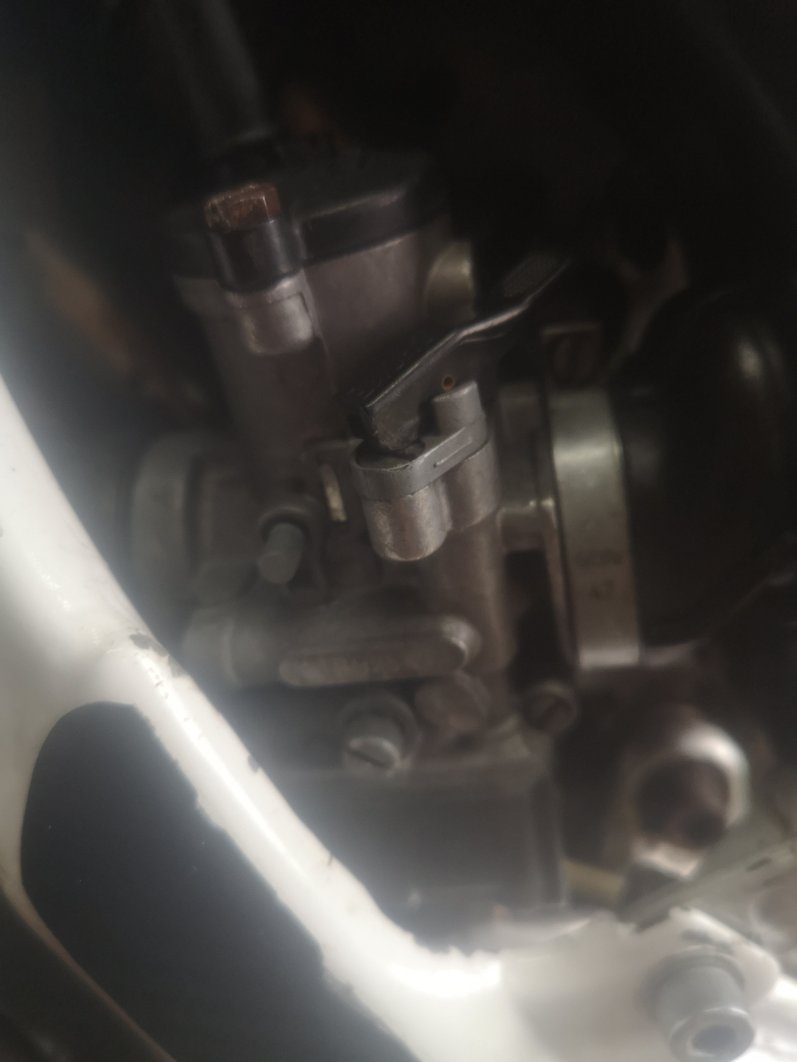

What carb is on it ? If its an air screw Dellorto they can be temperamental, try get a loan of a petrol screw one to eliminate that.

Spark is good and strong bit plug seems to be very wet it's an air screw type I've got it at 1 and half ISH out

The upper coil which is for the ignition looks to have some corrosion, would be an explanation that it did cut out when getting hot.

1,5 half turn out is much to the lean side, if you turn out the carb is adjusted leaner, if you turn in richer.
Please try out if the bike runs better with a different set up, when it is warm adjust the idle a bit higher, then slowly turn the screw in and out to the point where the engine uns with even higher rpm then before while idling. That is the perfect adjustment. You can then turn down the idle to normal set up you like.

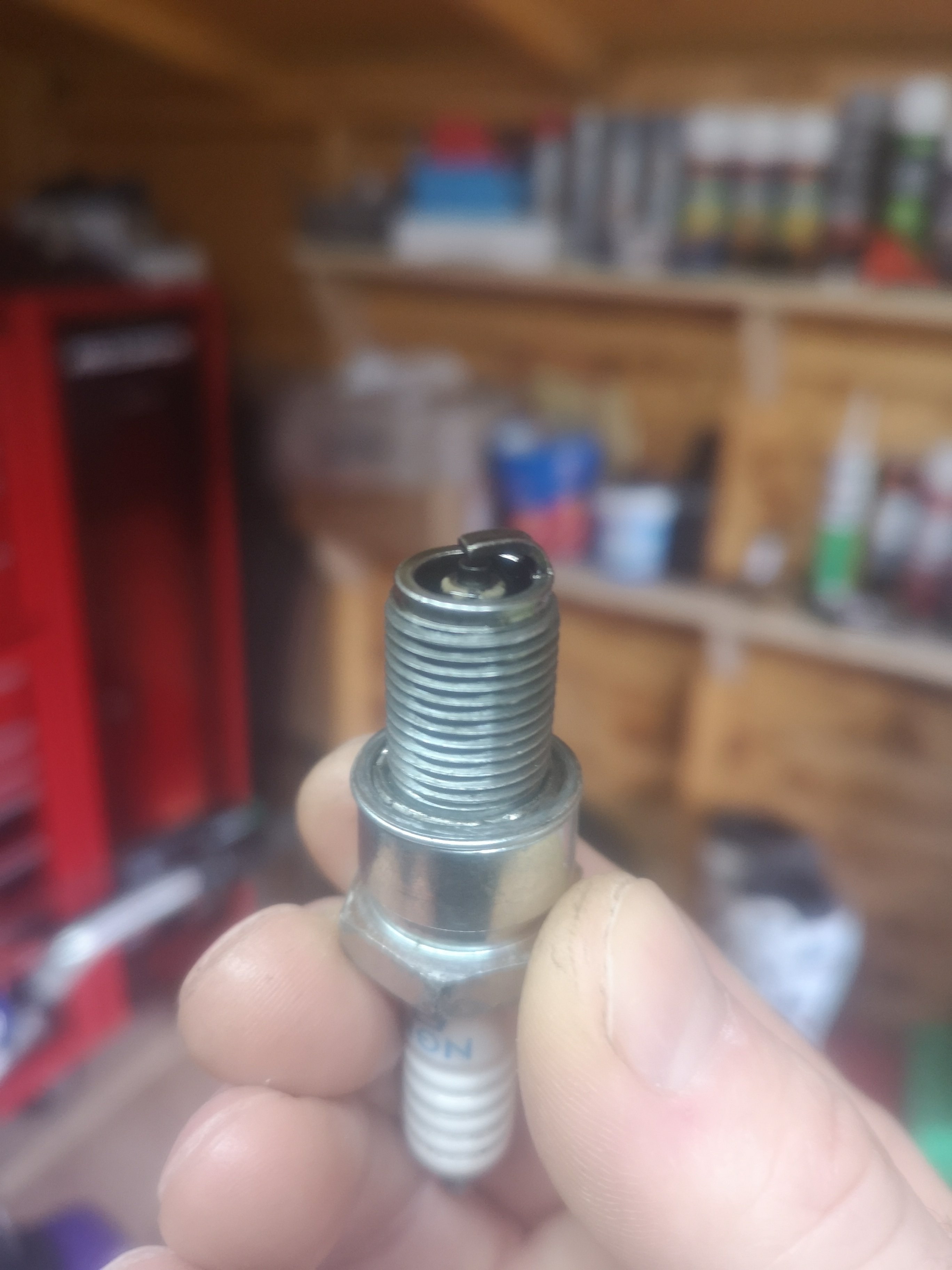

So when the bike boggs and stops, you take the plug out and your getting a good spark ?  At that stage have you tried a new plug ? A picture of the plug would also be useful.
Yeah it's black and wet I'll give it a run tomorrow and take a photo
I'll give it a go tomorrow thanks lads I've had a look at the old kill switch found corrosion on the wire so I'll sort that aswel   .....
Just to clarify it seems to bog and stop rather than straight cut out and it does restart on choke
Ok so now it's ok only running on choke it cuts out after a minute here's what the plug looks like it was clean at start
Very wet
The spark is absolutely mint really good so it must be this ****ty carb
