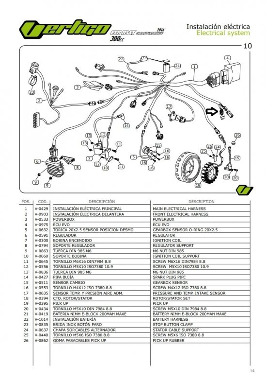

Attached parts list. Thank you for telling us which part number you connect to 12v.
Which 12v battery should I use? rc car  battery?
Sorry I do not know so much.

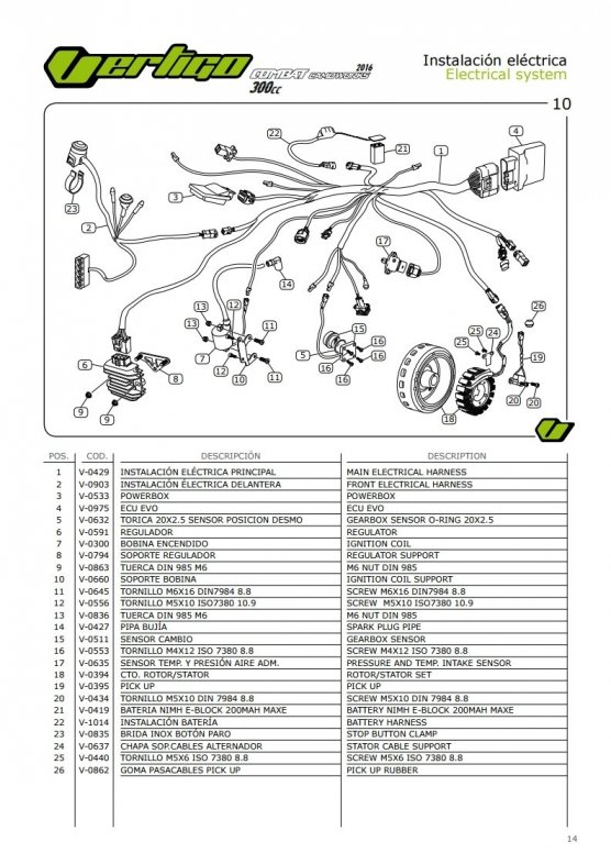

 there is a 12vDC plug under the petrol flap that you can hook in a 12v battery into?
I wrote again. I put the parts list picture
I would appreciate it if you could tell me which number to connect 12v to Can 12v batteries use rc car batteries?
I'm so sorry for not knowing

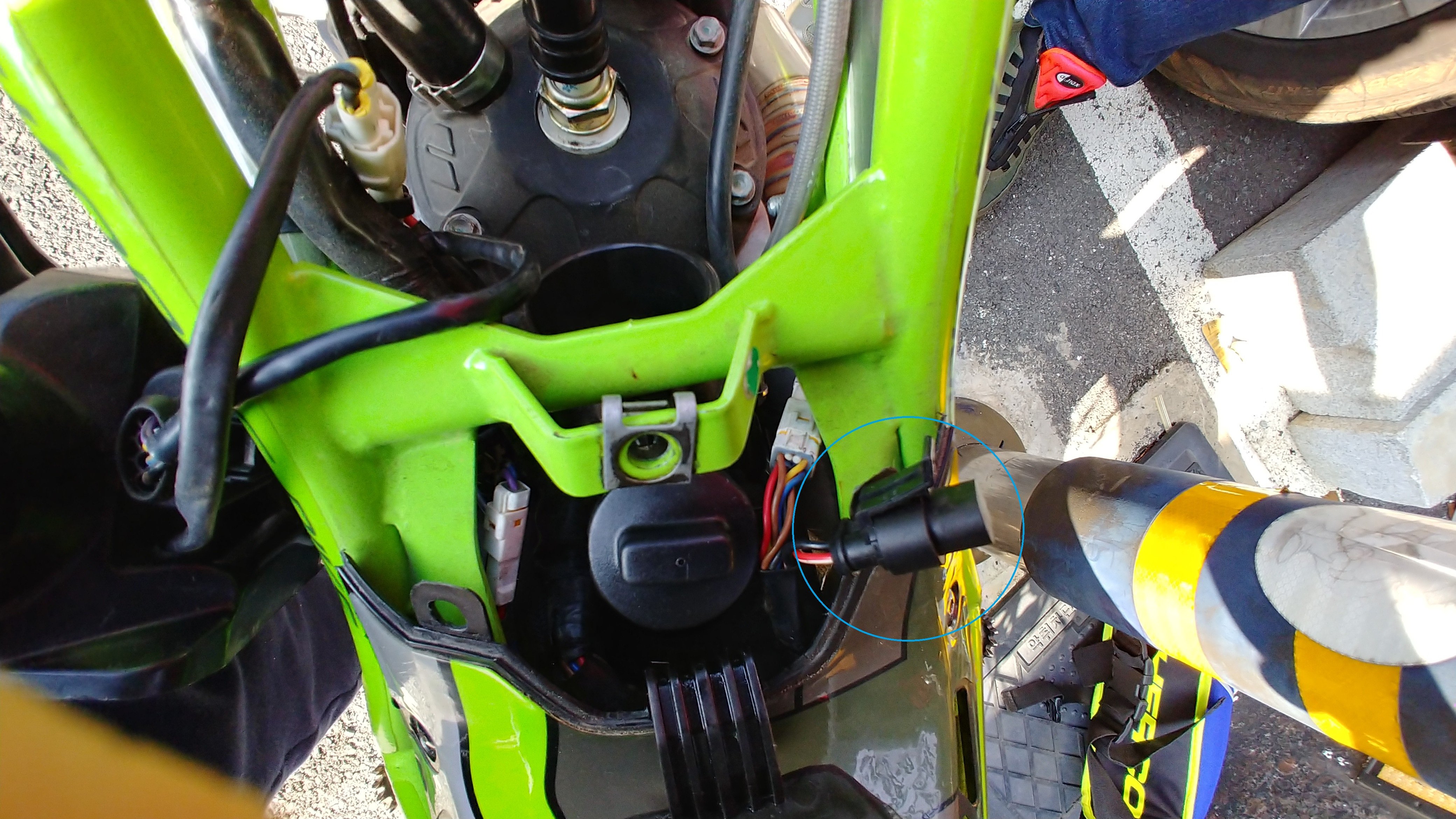

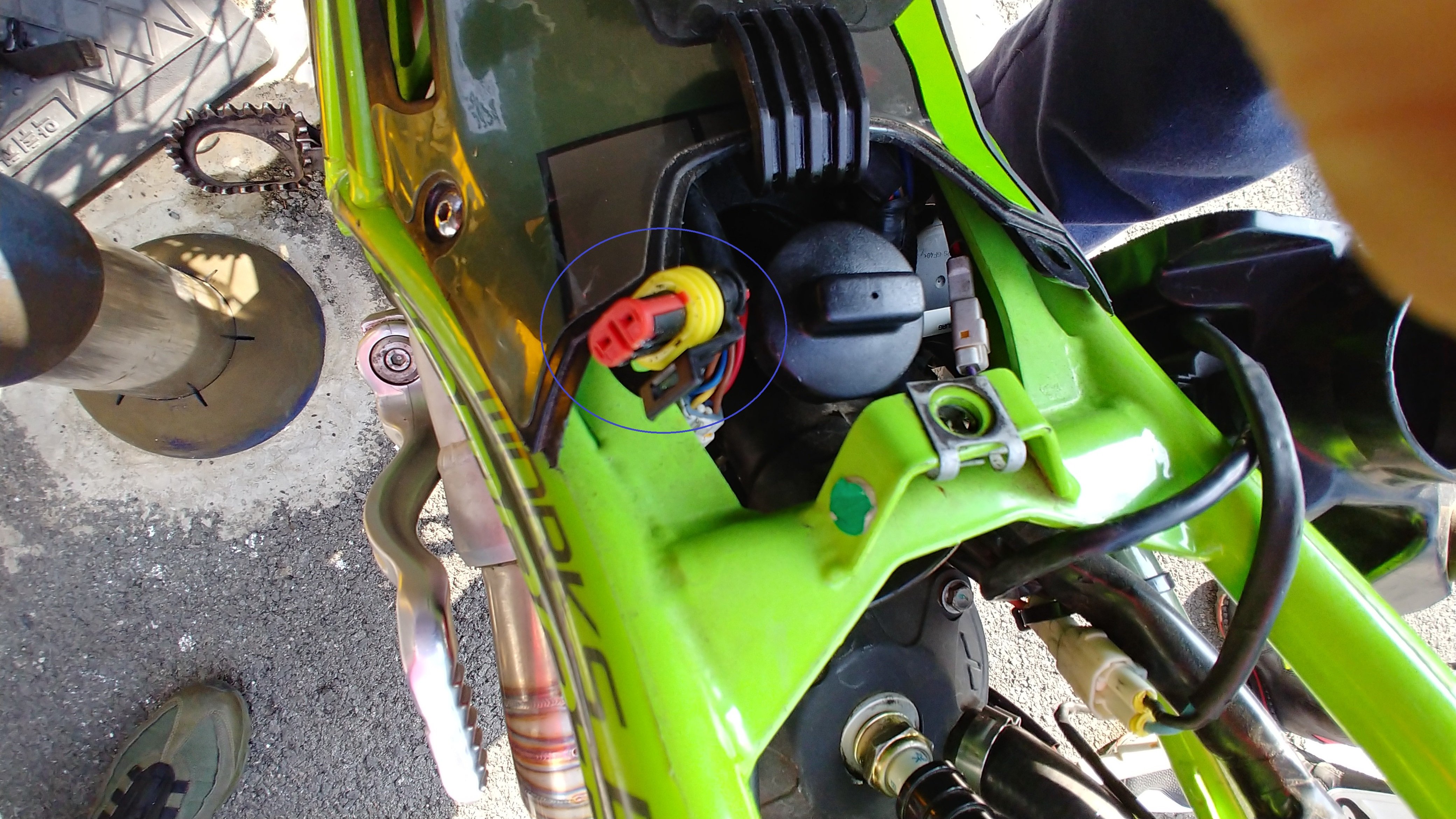

12v jack asks if it's right here
Does the circle in the picture match the arrow on the parts list?
If correct. Which 12V battery should I use?
Can I use an rc car battery?
Yes, that is the correct plug circled. Black wire is the negative, red wire is the positive. You can use any car/motorcycle 12 vDC battery to start the motor then disconnect this before riding. When you park the bike after finishing your ride, leave the magnetic kill button in place on the switch otherwise leaving it off drains the battery. Your Vertigo 9v battery should be a re-chargeable type. Bye, Peter B.
