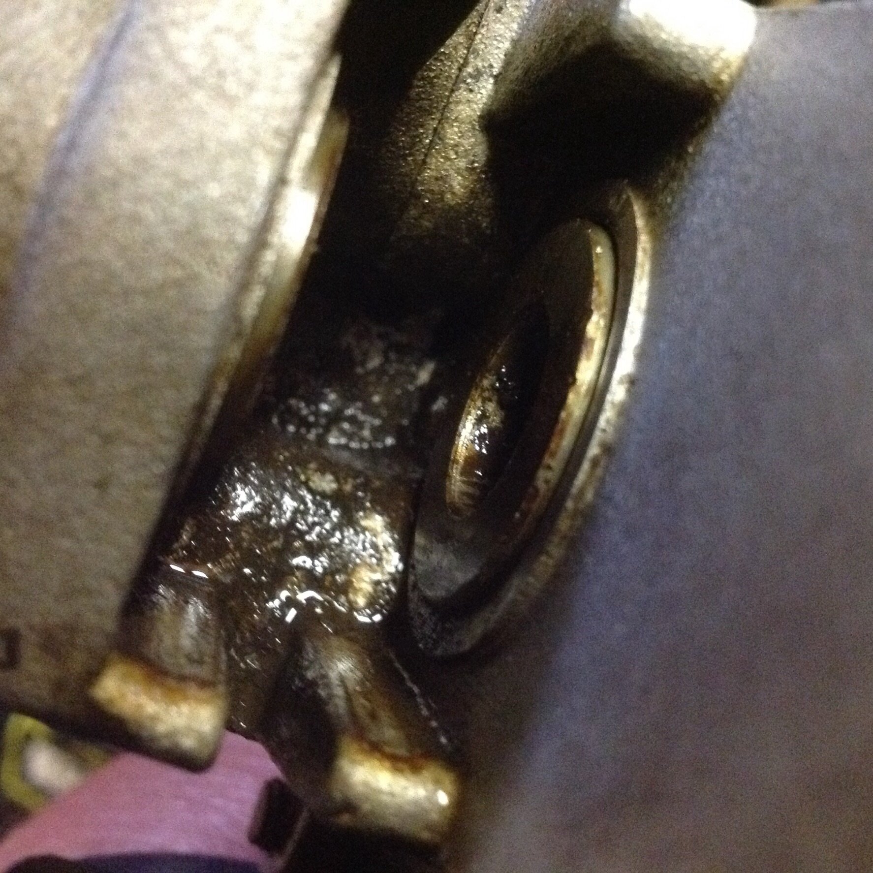

Thanks lineaway. The lack of success is taking me to that eventuallity. On looking at the rear caliper pistons, the movement is hardly noticable. Should the pistons come further out of the caliper than this? Could they be stuck?Pads are between 3&4mm.  Bled again and at m/c. Thanks for any suggestions you may have.
I would expect them to move a lot more than that... You also look like you have a great deal of fluid inside...  Might have a bad seal?
Edited by jonnyc21
The fluid is WD40 residue, I sprayed the caliper in the hope of freeing the pistons. It was dry before doing so. Like you, I think they should move out more than this. Any tips on freeing them?
