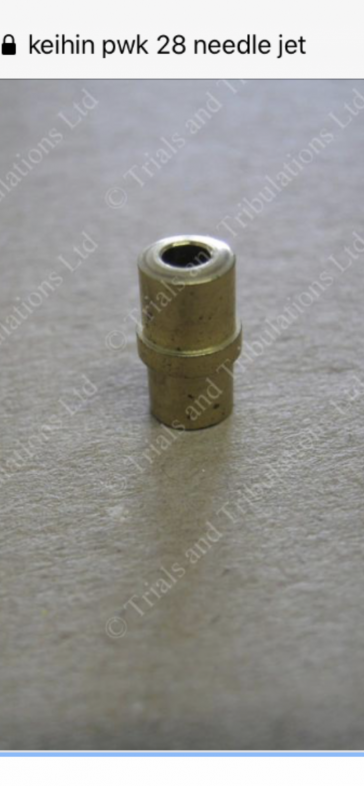

One other thing that can happen is putting the needle jet in upside down. Sounds ridiculous but I’ve done it.? The tapered hole goes up.
Thank you. Just to clarify. I’ve attached a picture. The way the needle jet is in this picture would be wrong?
