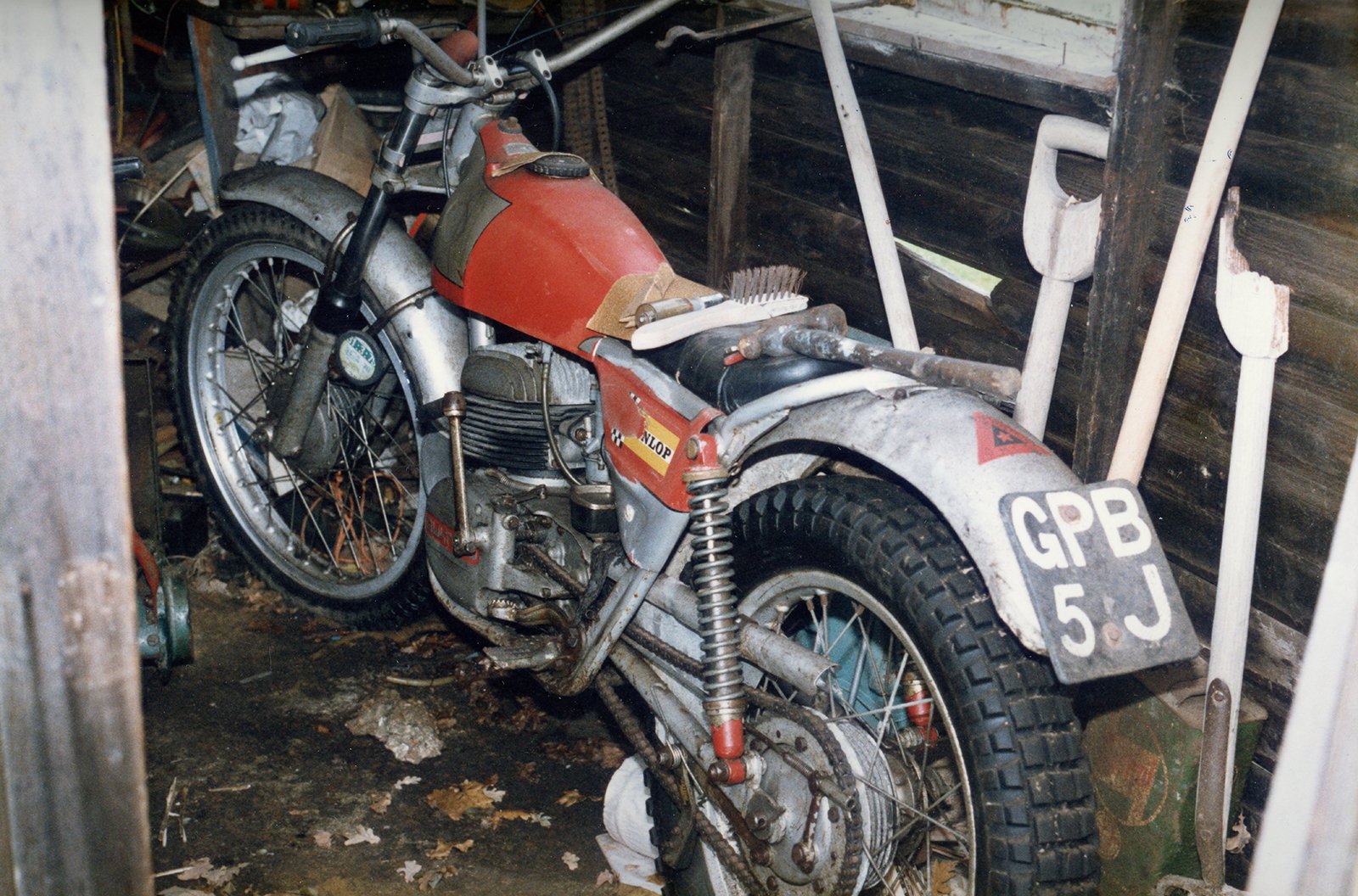

A year or two ago dad said he was going to get it back together, and got as far as stripping the paint off the frame. His plan was - I think - to rebuild it and ride the Manx classic 2-day in 2022, 50 years after riding in the 2-day on the same bike back in 1972. Unfortunately though dad left us unexpectedly two months ago, claimed by a heart attack. Whilst he knew practically nothing of this turn of events, and was gone practically in an instant, now of course the opportunity to learn from him has gone. Each time I feel myself teetering on the edge of that nasty rabbit hole called regret (at not asking more, listening more), I remember that he gave me a sound basis in engineering, that we did do a fair bit together. The principles of mechanics were firmly instilled. Everything mechanical responds to reason. Stop, look, think. Use the right tool. Don't rush. And so it goes on.
(Largely forgotten about, and as retrieved in 1985)

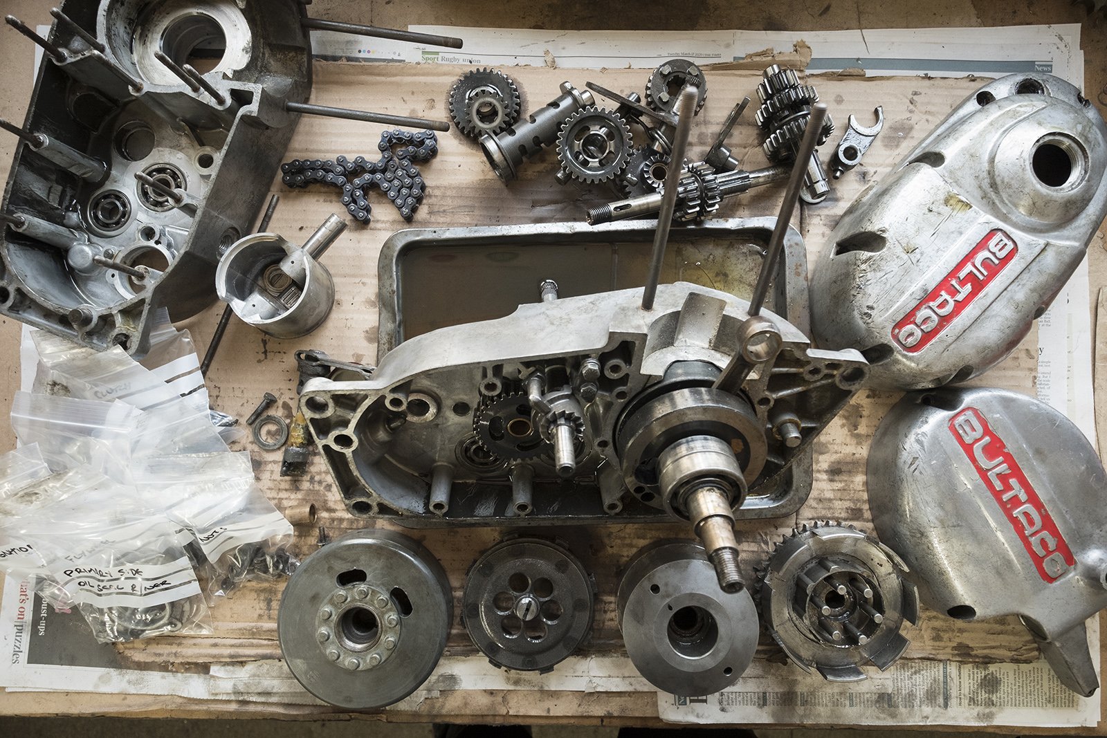

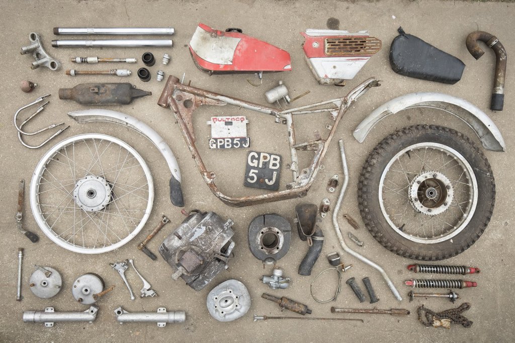

But what of the model 49? I found the bits in plastic tubs in the shed. Maybe he hadn't realised but the felt at the back was leaking, and those plastic tubs were now half full of water. The engine, top-end missing but with duck tape covering the hole, had enjoyed some shelter under a wooden shelf.
Here's most of what I found (I do have the missing bits):
It saddens me that dad will never have the opportunity to see it run again, but run again it must. I'll share my progress here, but I confess I have many questions to ask!

I've been cleaning a few bits up, and also disassembled the engine...
The engine took a bit of work, and didn't quite come apart as expected. The layshaft was stuck in the right-hand case and all the gears came loose instead of staying in the lefthand case. Then when I came to remove the crankshaft it practically fell out of the bearing (which remained in the LH case). There's some evidence that the crankshaft had slipped inside the bearing - the bearing being completely worn-out.
Talking of worn out, just about every bearing in there is knackered. The old man must've got some use out of this thing. I have a few questions at this point:
- The bearings that are pressed into blind recesses in the case - how to get them out? Presumably heat plus a special tool to hook them out?
- Are there any tricks for removing the two main bearings from the RH side of the crankshaft?
- I don't think the LH side of the crankshaft is necessarily toast (I tried a new 6205 bearing on it and there's interference) but if it turns out a rebuild is needed, does anyone here do that as a service?
- The 'detent' in the LH case seems seized in there - does it have to come out, or could I just leave it there? I'm wary of going too mad with the blowtorch.
The frame also needs some attention shortly. I want to switch to a tapered headstock bearing arrangement as sold by inmotion. Does this first require the old ball race cups in the headstock to be tapped out? As I am about to prep the frame for painting it would make sense to do this beforehand.
Thanks in advance for any help, it'll be greatly appreciated!
The blind bearings in the crankcase, heat the casing and try tapping the housings with a hide or rubber mallet or such like, as this might drop them out, if not use a blind bearing puller
The two main bearings usually stay in the crankcase, I'm guessing they didn't as the bush that sits on the crank behind the clutch weight is still in situ ? It looks to be from the picture but not sure. If it is it will hold the bearings onto the crank. These bushes can be very tight sometimes so you may need a normal bearing puller to get them off and pull the bush with them. Without the bush they would normally prise off quite easily
Not sure about repairing crankshaft surfaces as that's specialist and I've never had it done. Someone will know. Make sure you use 6205 C3 bearings on the crank, not plain 6205
The detent needs to come out really otherwise reassembling the gearbox can be awkward as it means trying to get the selctor drum in whilst holding the plunger back and out of the way against the spring. They can be tight but it should undo without too much trouble

There was a bush on the crank that took some persuasion to get off. The two main bearings are now the only things left. The Haynes manual - which I'm not fully trusting - did say the main bearings should stay on the crank as it comes out.

The remaining two bearings on the drive end of the crankshaft can be removed like this.
Ease the outer one away from the inner one using wedges between them, then when there is enough gap, use a bearing puller.
Ease the inner bearing away from the crankwheel using wedges between it and the crankwheel.then when the gap is big enough, use a bearing puller.
For both of them, heat up the bearing to make it move easier.
As for the magneto side bearing having been moving relative to the shaft, that is commonly seen with these motors. Even with the C3 bearings there is not enough side freedom for the crankshaft expansion during heating/cooling cycles of the motor and whichever bearing fit is the loosest will see movement which gradually further loosens the fit. As long as that bearing remains free-spinning and there is at least enough interference to spin the bearing, the tightness of that fit is not a problem. On some of these motors the outer race is the fit that moves which can cause enough wear to require that the casing hole be sleeved back to size.

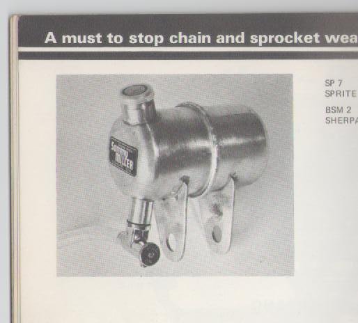

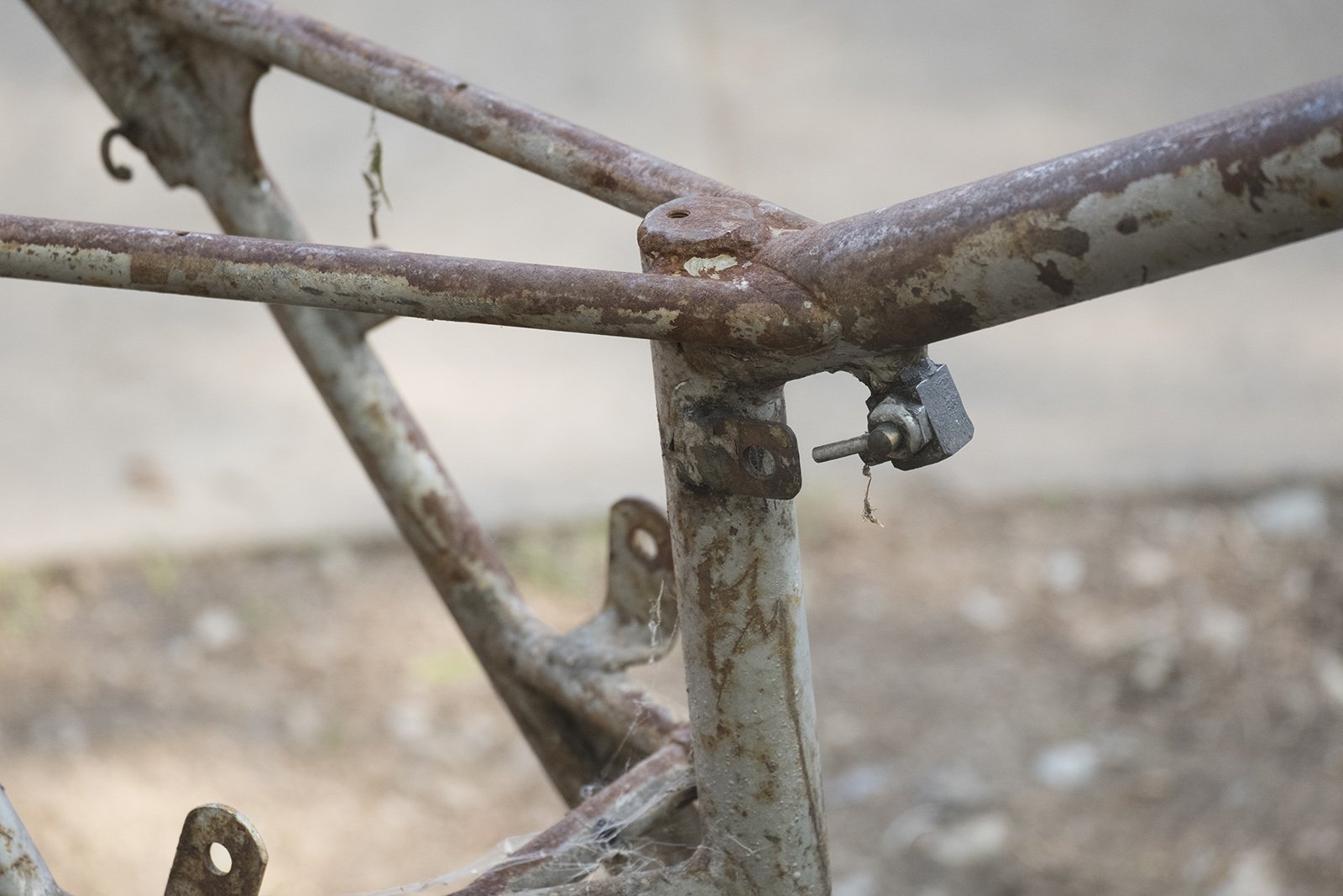

I'm now preparing the frame for some paint, and noticed something that looks non-standard...
There's a little tap mounted there, and at the top between the headstock and the petrol tank mount there's a drilled and threaded hole. I can't imagine - on a two stroke - why you'd want to store oil in the frame, assuming that's what it is. The only possible idea I had was that it might be convenient to keep oil somewhere for when refuelling on long distance trials.

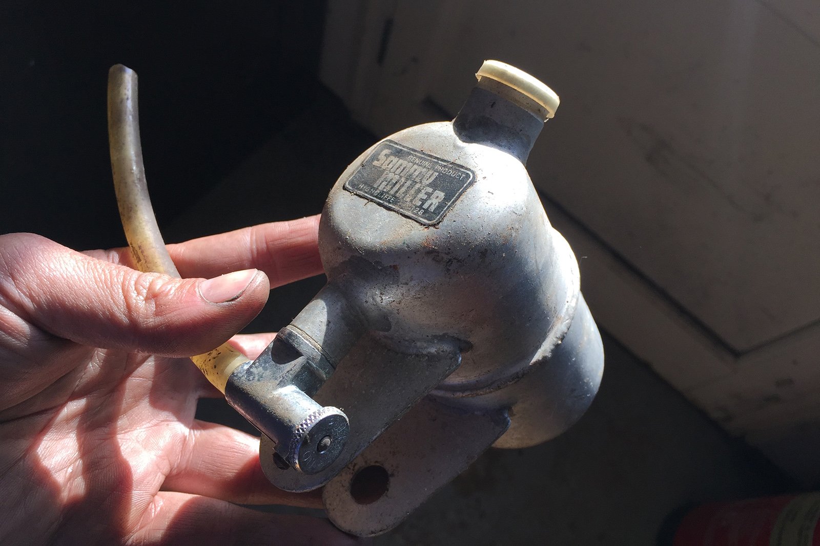

I also found this in the box of parts, same idea perhaps:
The Sammy Miller sticker may or may not be original!

Re the tap in the frame top tube : how does the oil/liquid get in there ?. The mind boggles..........
The frame-mounted tank is a chain oiler :-
(extract from 1973 SM catalogue)
Later Sherpa models incorporated a chain oiler in the swing-arm tube, from the factory..
Hope this helps.
