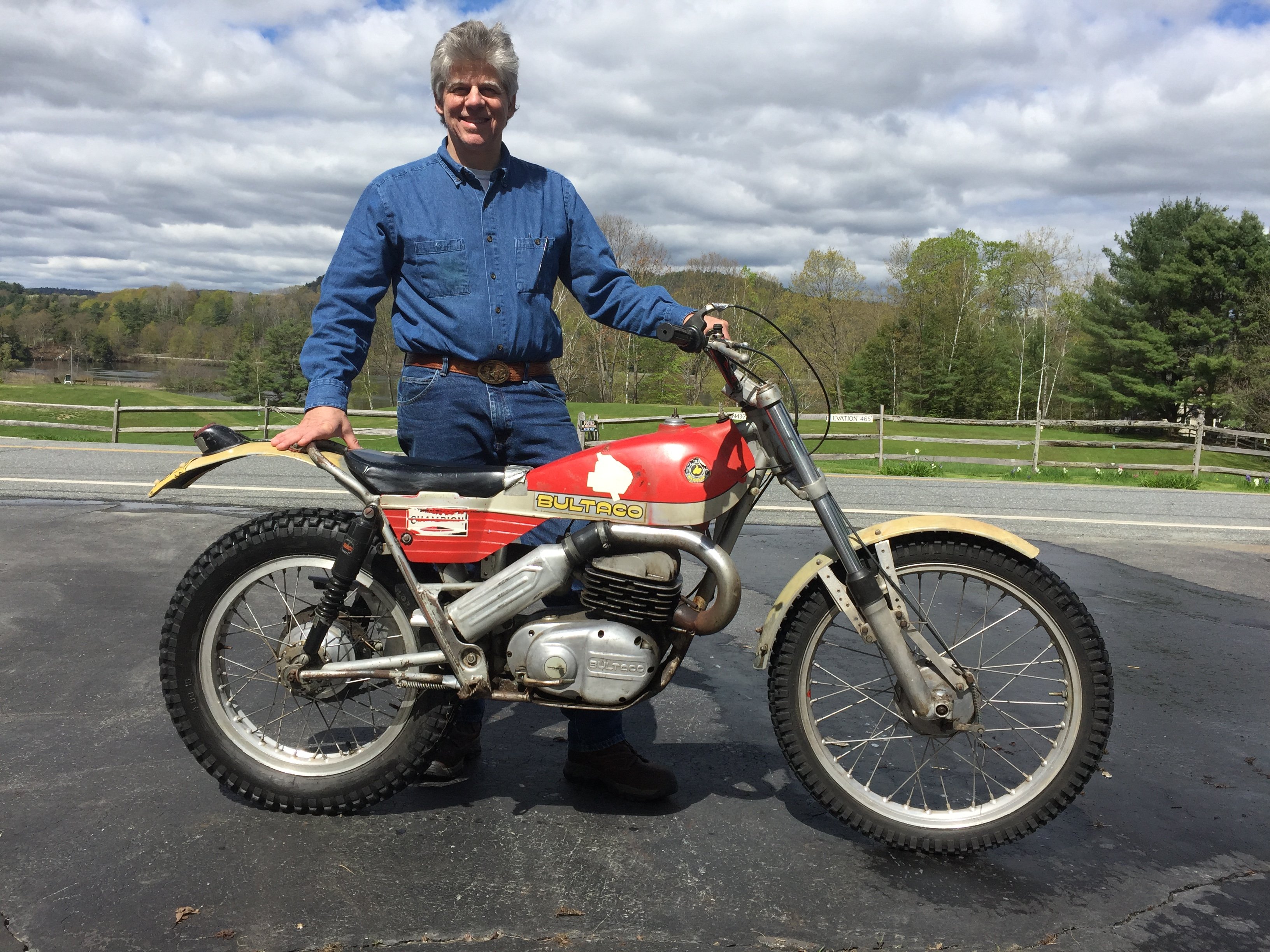

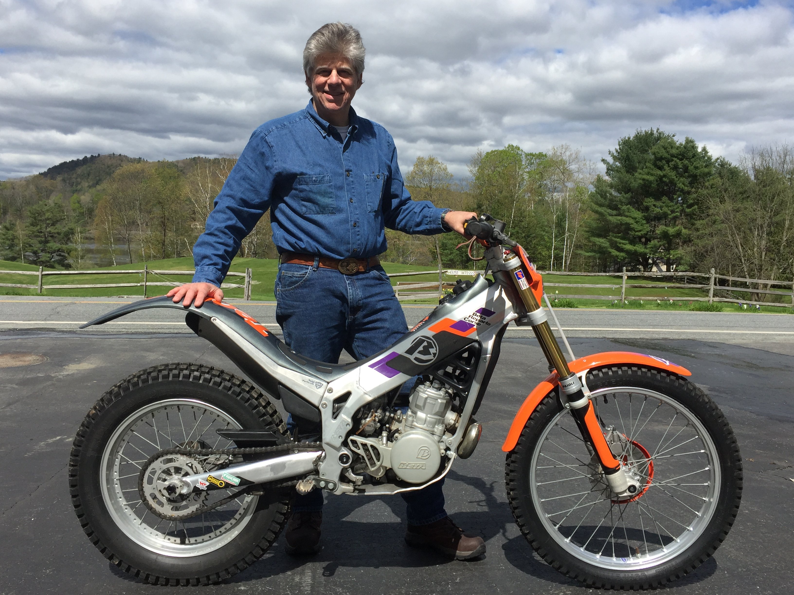

This bike is still like new. Hasn't been used much. Photos added for your viewing pleasure :)
You can see that the older Bultaco Sherpa T has even more slack steering head angle.
The techno looks nice and clean and the fork rake looks about right. if your new to trials get a slow action throttle on her and consider a fly wheel weight. Good starter  bike.
