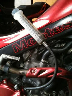

  I am getting no where trying to bleed the clutch and rear brake, tried both with normal pumping of the levers but not getting any air or fluid to move. Also tried the reverse method on both and no matter how hard i push on the syringe I am getting no fluid in, I can feel the resistance and when I let off the pressure I get some old fluid pull out into the syringe.. Any tips before I have to resort to paying for it to be done.. I only did my zx6r last month and that was a dry system with no issues..

Ah, that's not the problem then. I had trouble doing my back brake but found a really big syringe was the answer, as if the extra pressure was what was needed.

  Clutch should come up fairly quickly. You can try vacuum bleeding using a syringe. If you can’t pull the syringe then the nipple needs to be opened a bit more.
