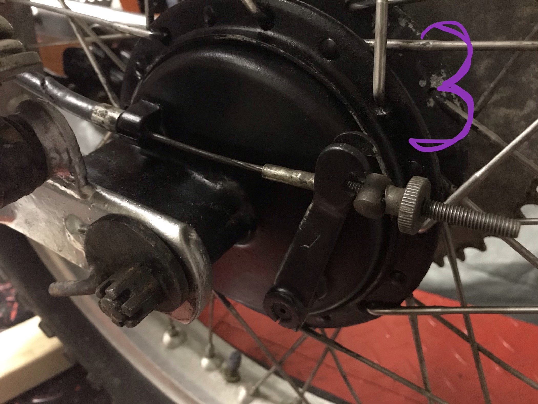

Im also a bit confused on the rear brake cable routing.. the manual I have isn't clear to me and because Im building this from bits in a box I can’t work it out. I’ve never actually seen a complete ossa in the flesh

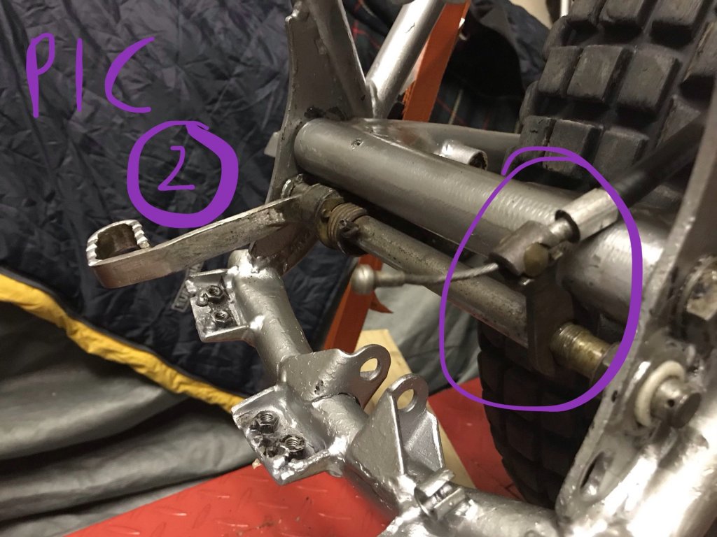

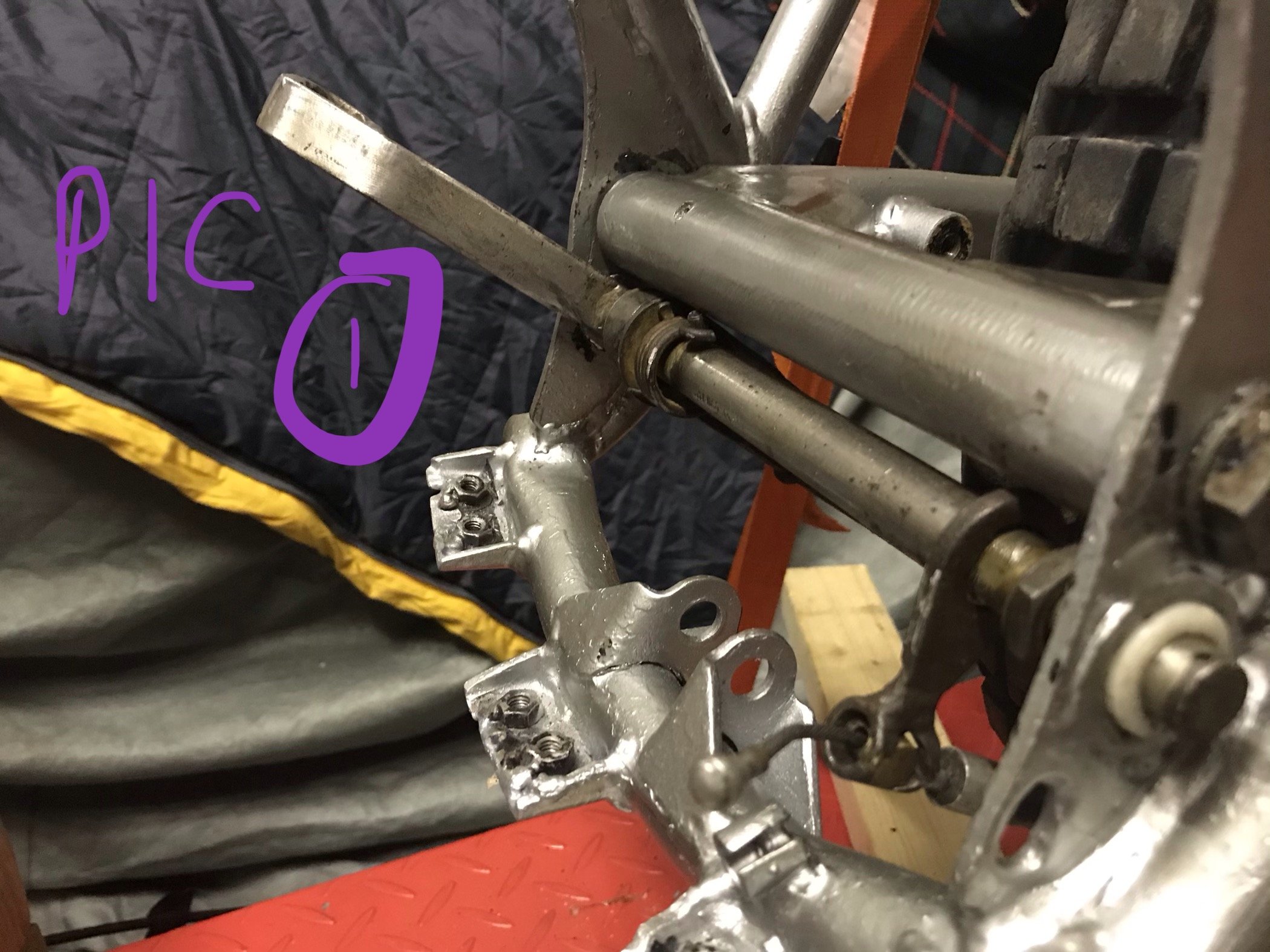

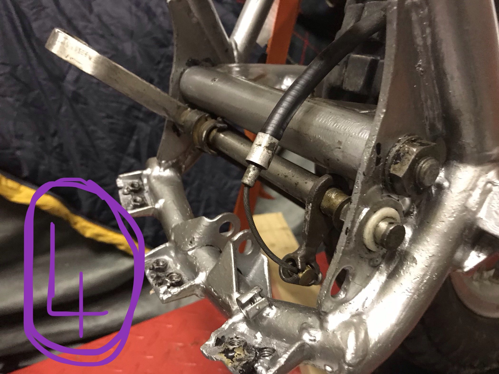

All the components on the shaft attached to the brake pedal were already in place out of the box I got it in.  But when I installed the shaft it would have resulted in the cable being pushed rather than pulled by depressing the brake pedal. Unless I routed the cable over the top of the swing arm and through what seemed a really tight angle which just didn’t seem right .
I took the front cable attachment  ( circled in pic ) off and turned it 180 degrees so it pointed upwards  while Installed ( pic 2 ) .
That would have the cable pulling in a natural sense but results in the brake pedal pointing down way too much before being depressed . What way should it be configured?

This set up is correct the cable inner wire pear nipples hooks into the bracket on the frame then when the pedal is depressed the lever on the brake pedal shaft moves rearward pushing the outer toward the back of the bike.
Because the outer is anchored on the brake plate this movement transfers to a pull of the inner cable which applies the brake.

Your brake cable looks like a MK2 version which is a bit longer than a MK1 cable although it will still work. Rear wheel also looks like a MK2
