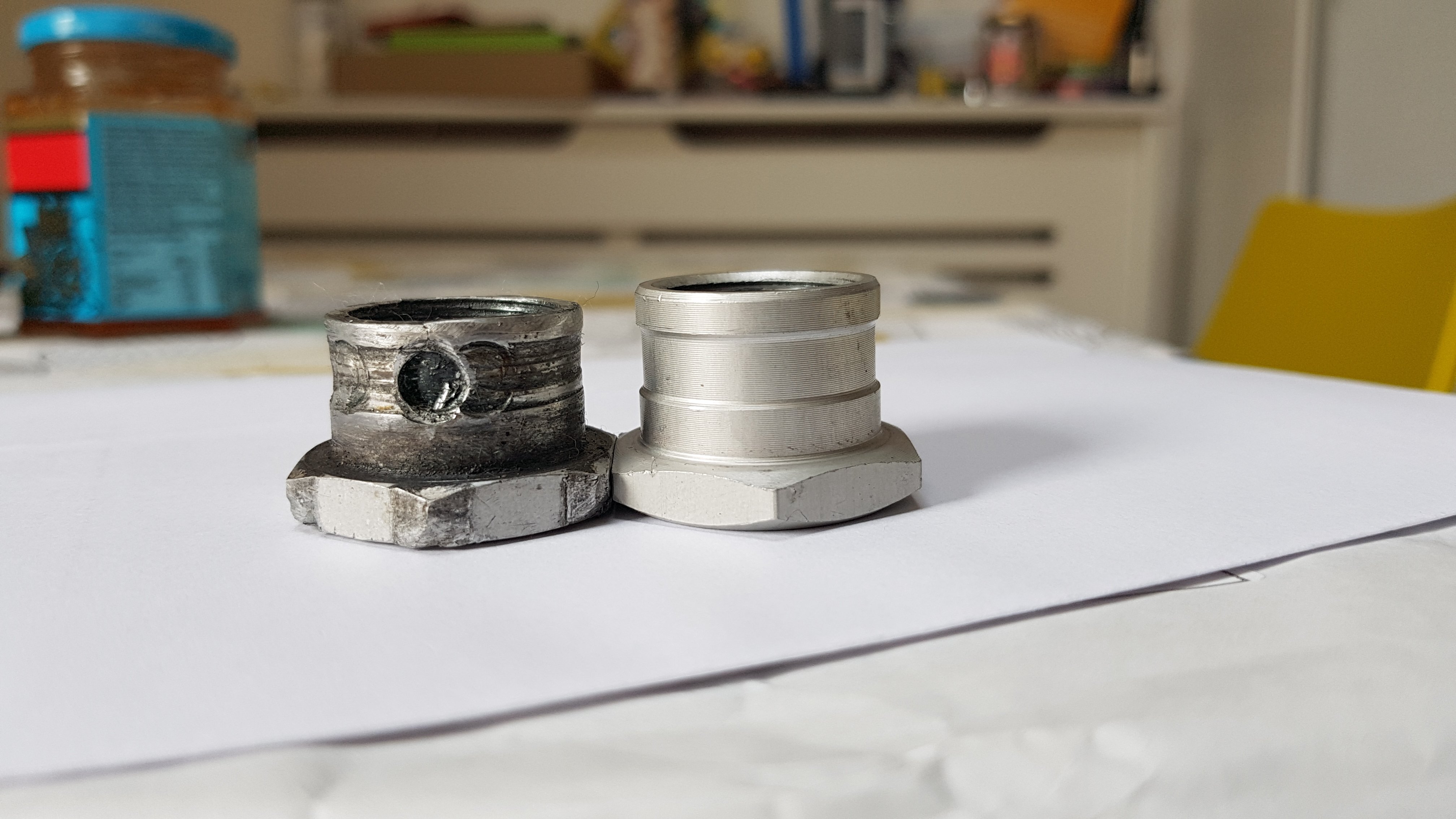

I ordered a new top nut as the previous owner had severely damaged the old one. However, despite being the correct GasGas part and having now ordered 2 from different places, the top nut is wrong. Basically it's about 2mm longer than the one that came out which means it hits the retaining nut before it tightens down onto the upper fork yoke.
I've taken a photo side by side with old versus new so you can see. I've measured the space between the retaining nut and the top yoke and it's about 15mm so there's no way the new nut can work and there's nothing you can do to make it more.

Pop into your local engineering workshop and get them put in a centre lathe and just take 2mm off the nut.
Cost you a couple of quid, but worth it.

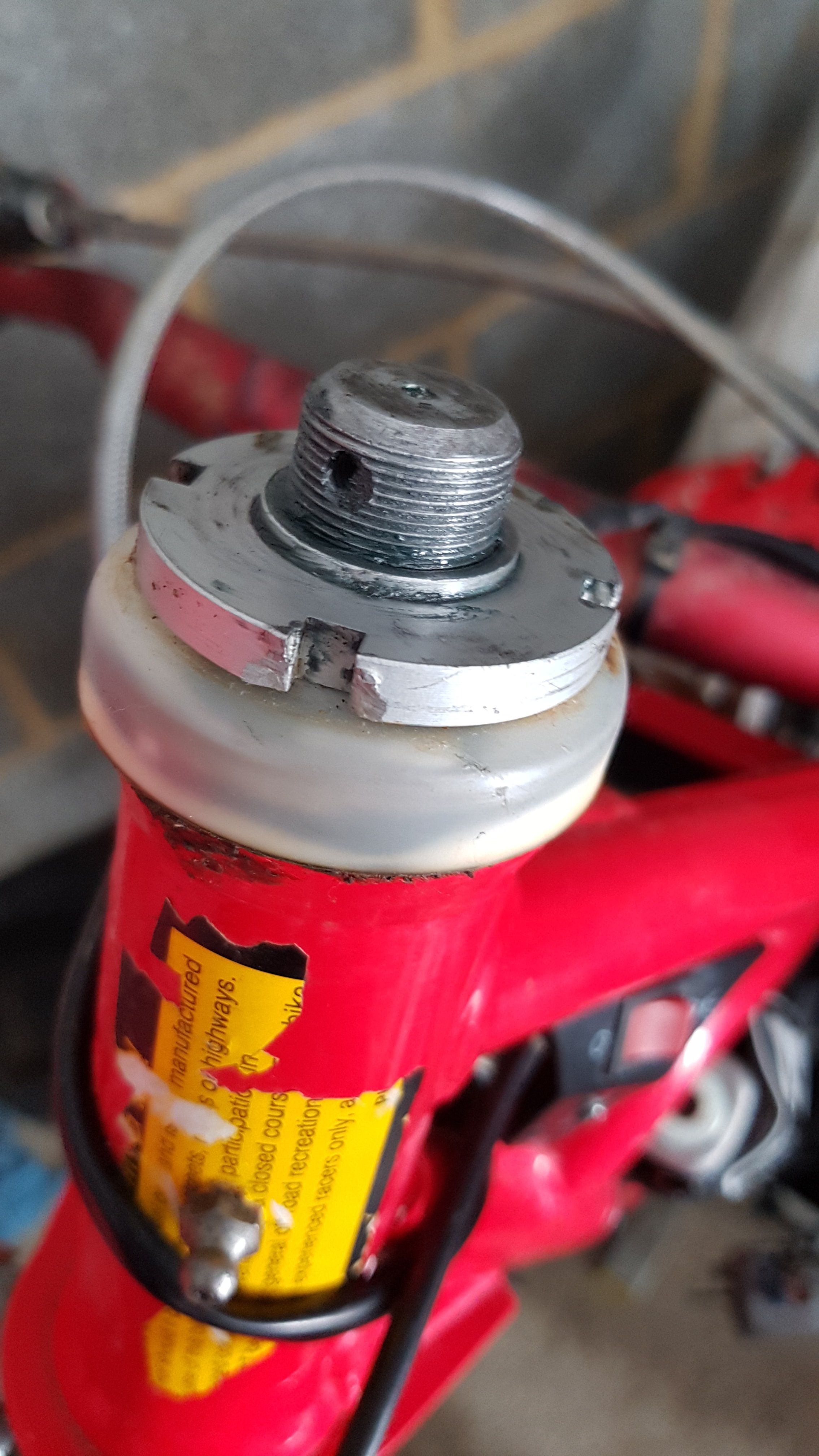

So the top yoke sits on top of this locking nut (the raised bit in the centre sits inside the hole in the yoke to help centre it). The top nut then goes into the stem and should tighten against the yoke and hold it tight to the locking nut. However, as the locking nut is too long it's coming up against the raised centre part of the locking nut before it tightens down onto the yoke.
There's nothing you can adjust as the thickness of the yoke is what determines how far the nut can be threaded down.
The attached pic is the old one before I removed it. Looking at the old top nut it looks like this was filed down to the right length too. All very weird.

Strange system with part of the top nut passing through the yoke.
What is the grove around it and the bolt marks on the old one all about? It looks like the yolk may be fixed to the top nut rather than clamped between the lock nut and the top nut as you'd normally expect. Alternatively a spacer to effectively increase the thickness of the yolk may be missing.
The groove is for a small bolt to stop the top nut coming off if it comes loose.

Yes it seems the only option is to shorten the top nut by around 2mm. Which I can get done and there's plenty of thread so that shouldn't be an issue.
It's just that everything is brand new with correct parts so why doesn't it fit? If they are correct parts then every Gas Gas must have the same issue.
As for the bearing race, that's all fine but even if it wasn't it would only affect the amount of thread available on the stem to screw the nut onto. The top nut would still hit the locking nut as the locking nut sits snug under the top yoke and the top yoke (which is genuine GasGas and new) is a certain thickness. There is nothing other than shortening the top nut or putting a washer under the top nut head (between head and top yoke) that can be changed. There's no washer shown on the parts diagram and very little space for one.

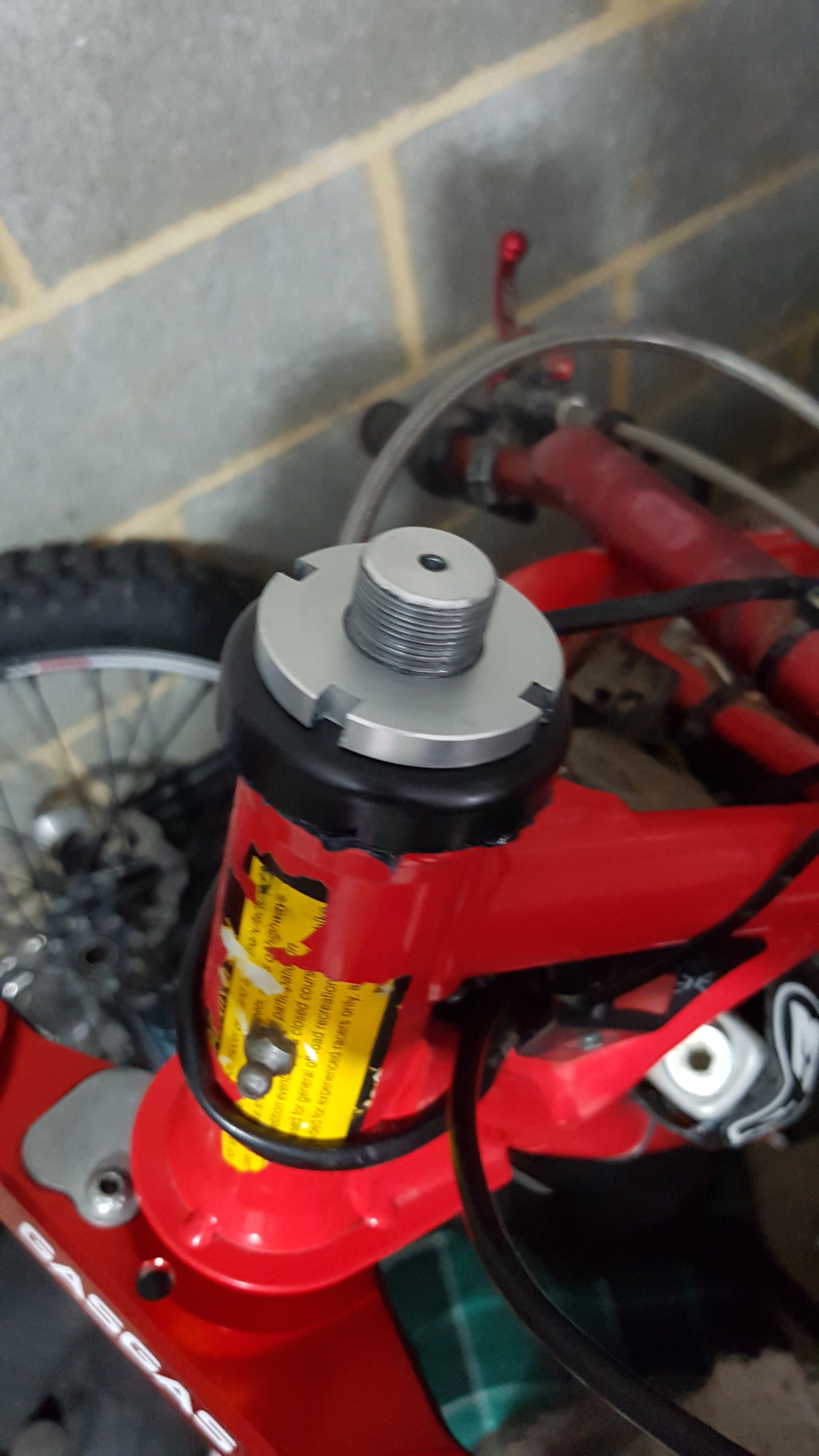

So I've just been out to the garage and had a brain wave while looking at it.
I'd put it back together the way it was when I took it apart (as per previous photo with the top yoke removed). However, what if that's not how it should have been?
So, the plastic cover has a hole slightly larger than the spindle. What if the locking nut should be up the other way? So I tried it, the locking nut raised bit then sits inside the hole in the plastic cover and the top yoke sits on top of the flat part of the locking nut. Therefore when you screw the top nut in it can't hit the raised part of the locking nut and WILL screw down onto the top yoke!
Problem solved!
So yet again the previous owner completely messed things up and cut the top nut down to bodge it to fit.
Anyone know the torque for the locking nut? Want to get it right.
Here's a pic of how it should be.
The locking nut being inside the top yoke centres it.
