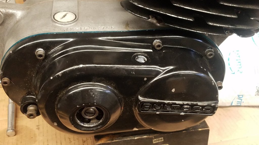

JM 159 clutch case depth ?
My clutch case does not have any clearance and rubs on the clutch centre drum pins and the end of the clutch springs ?
Not sure if I have the wrong clutch centre hub,or the wrong clutch case ?
Year manufacture 1976.

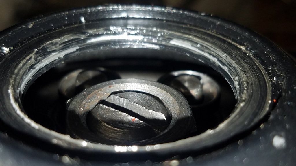

Recently purchased bike.Previous owner had attacked inside of clutch cover with angle grinder to gain clearance for clutch and nearly totally removed thread for clutch adjustment cap ! I have tried another clutch case and it hits the clutch pins and clutch springs,leaving a 6mm gap where the clutch case gasket goes.

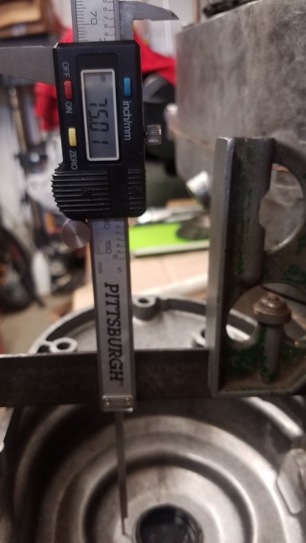

So have eliminated having the wrong parts fitted,but still need to gain maybe 4mm.plus 1mm for clearance=5mm. ?
