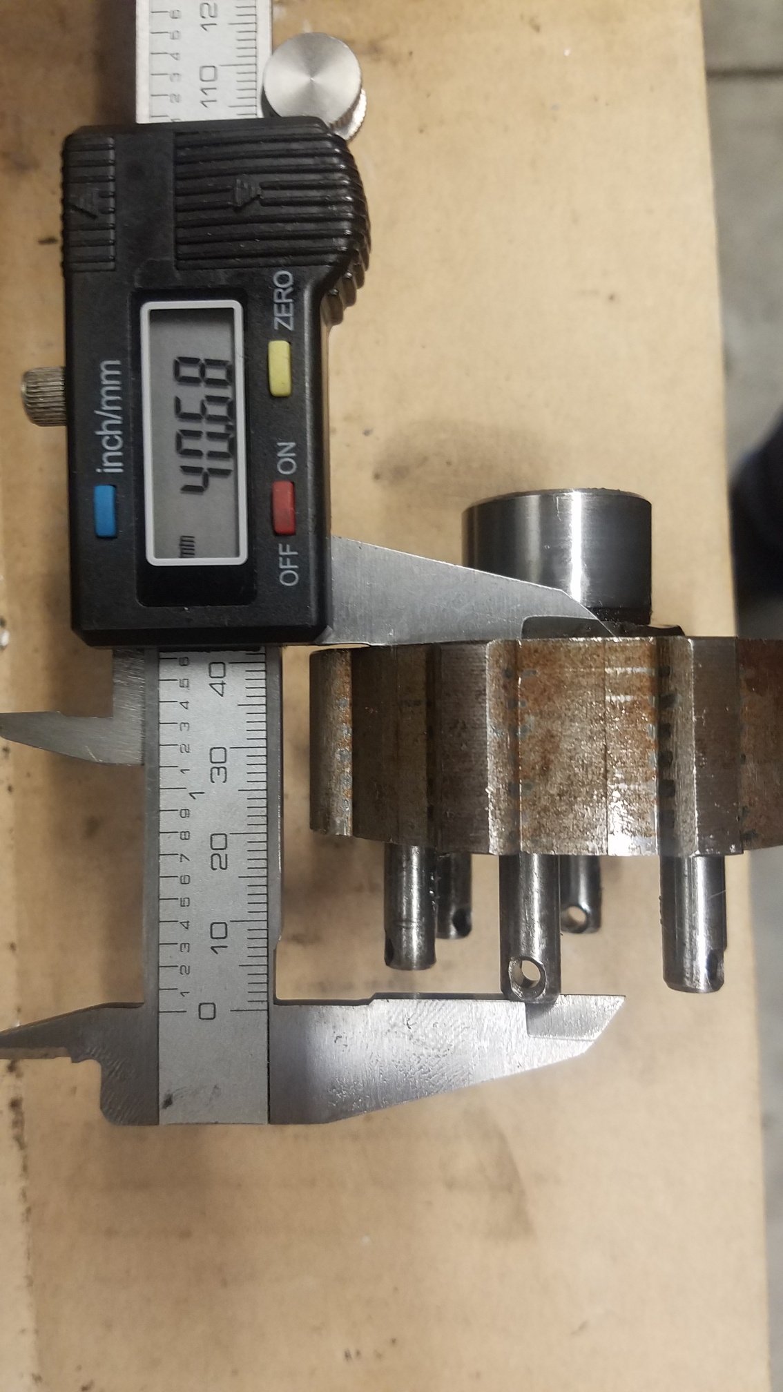

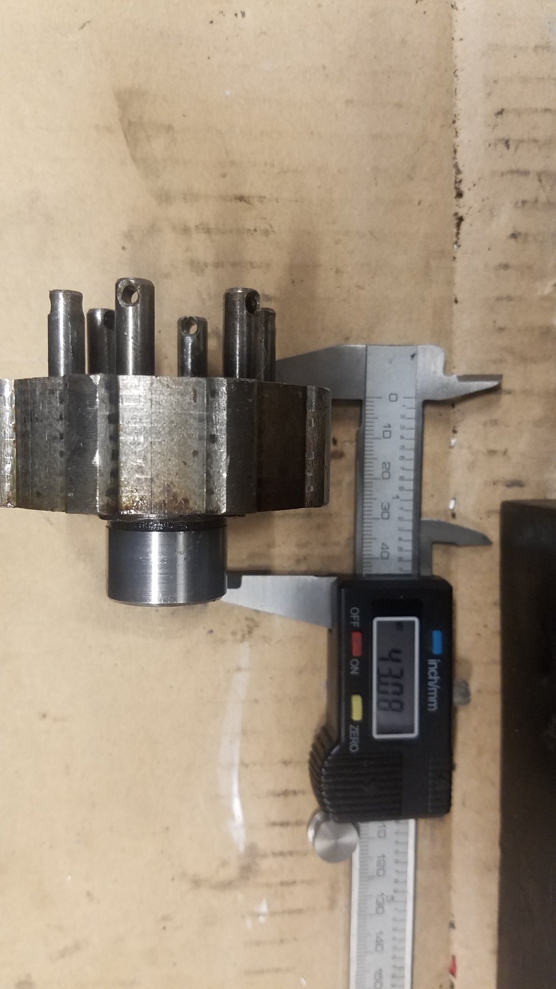

  • I've got a 159 hub in a box of bits so measured it as follows,  overall depth 43mm, depth of the hub where the plates sit 22mm.  depth of the boss at the back 21mm. Pin length 33mm, length of pin show

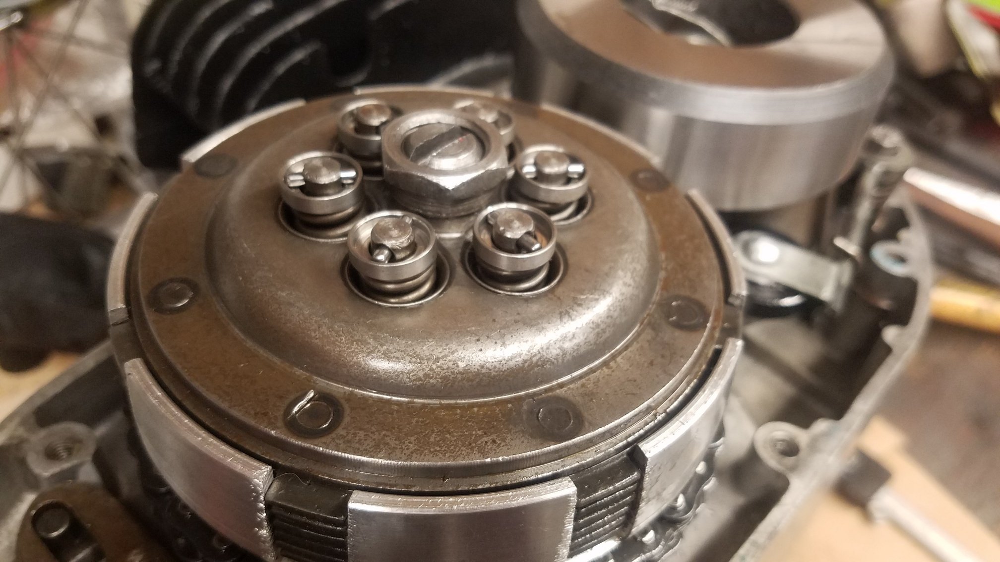

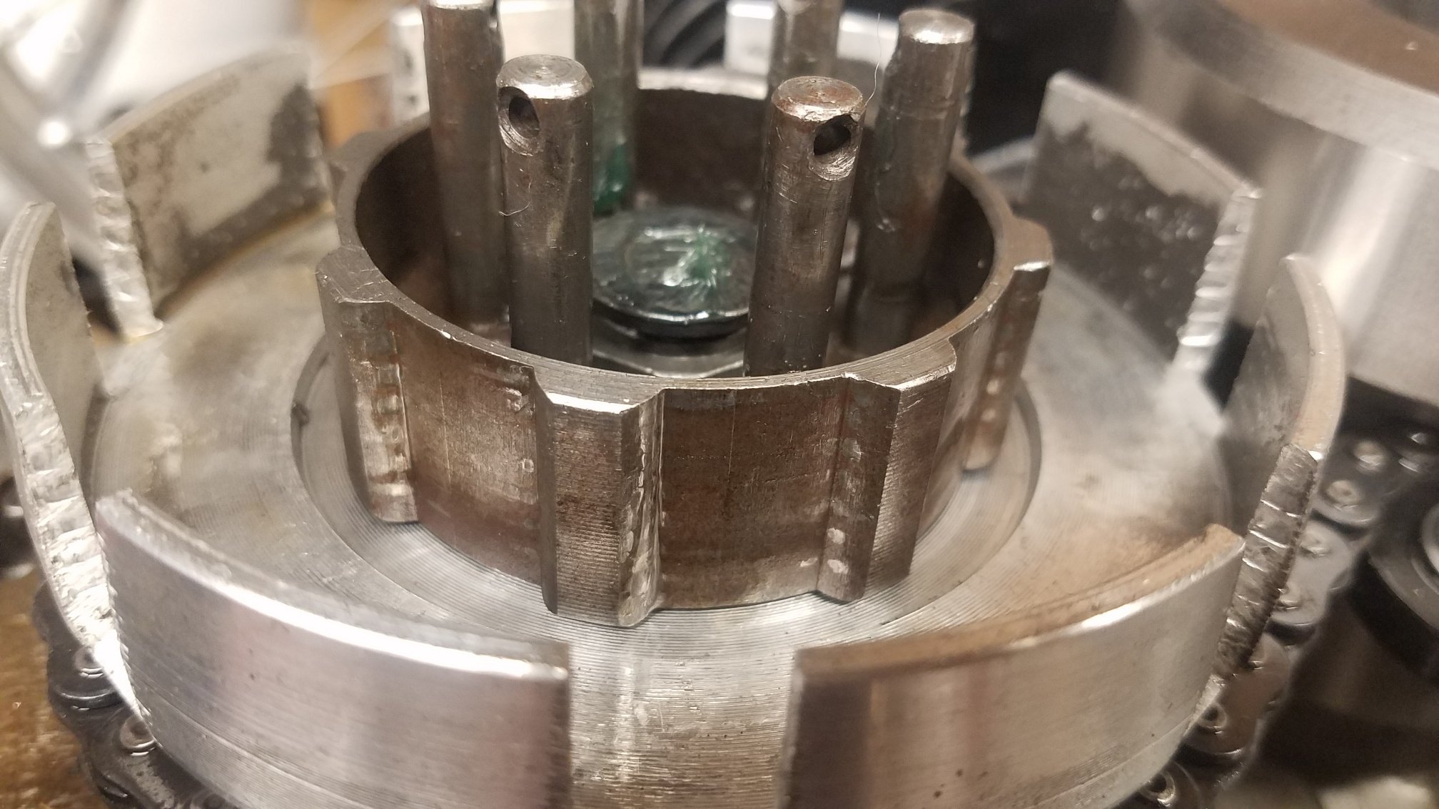

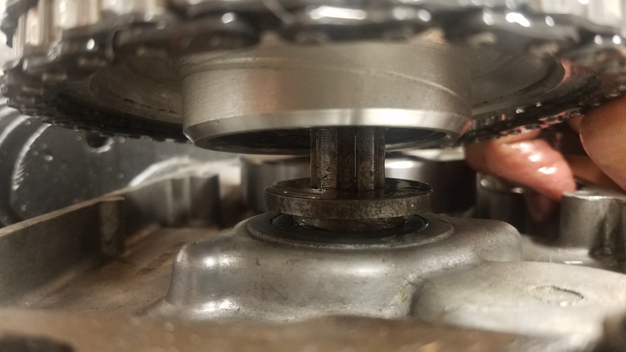

I cracked open the clutch cover last night to take a few measurements and photos (attached).  All seem to be in line with the measurements Woody provided as well as confirming his description of the 159 clutch hub (original to mine, anyway) incorporating studs with pin retainers NOT threaded.

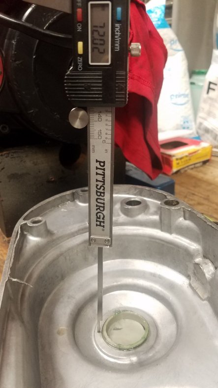

On the off-chance you simply have a weird clutch cover, I did measure mine internally using a straight edge and came up with 72mm taken from the ledge of the threaded access port for external clutch adjustment (see photo). Hope this helps a bit. Good luck!

Can you confirm your 72.02mm. was from the case gasket face to the inner clutch cover to next to the threaded access hole ?
My replacement clutch cover measures only 67.1mm and the old damage original clutch cover measures very similar,allowing for the damage caused by the rotation clutch pins.
So it appears both my covers are 5mm. too shallow.

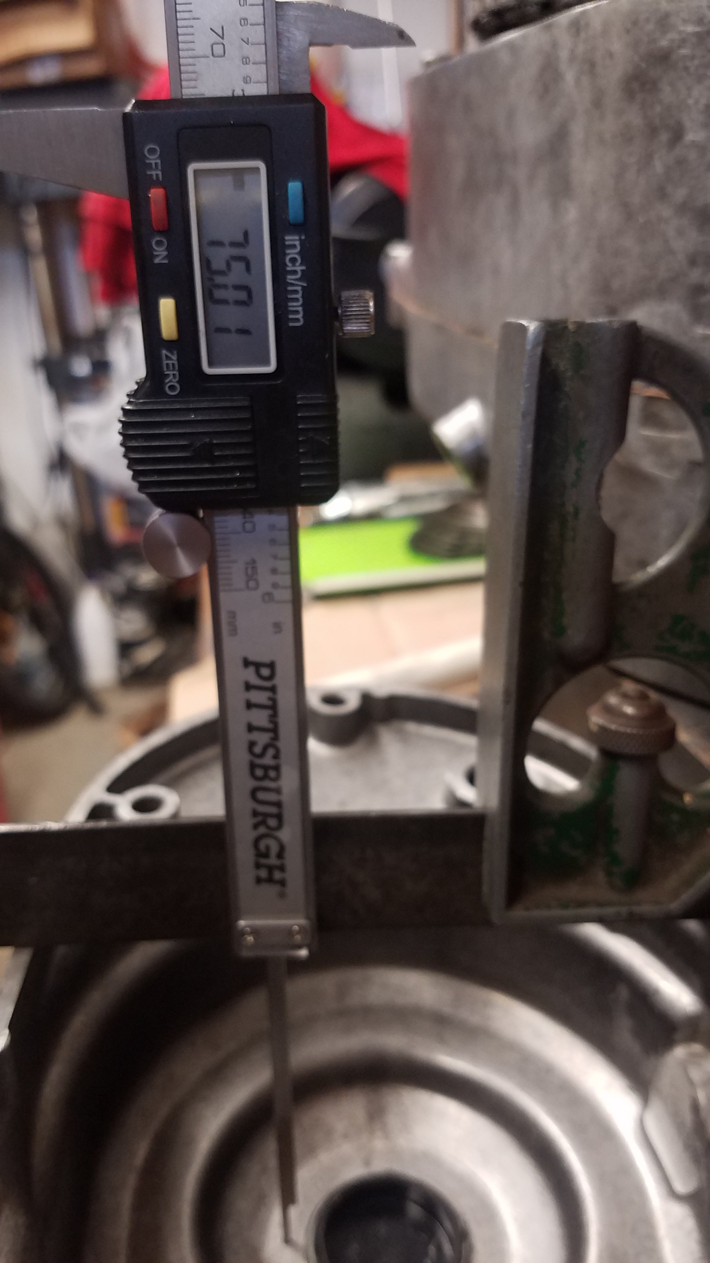

Confirmed - measures from the gasket surface to the point mentioned.  For comparison sake, I also measured the cover from my 199a. As you can see, the factory removed the step that can be seen on the 159 cover, gaining an additional 3mm clearance - 75mm depth total (attached).
Does seem your cover is from another model or lost 5mms worth of material on a sanding table.

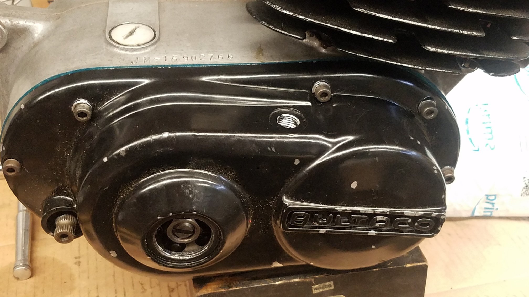

Confirmed - fits perfectly.  No visible gaps - all screws seat correctly.  I've included a pic taken through the access cover to illustrate clutch hub clearance.  No contact there.  When shopping for a replacement, definitely follow Feetup's advice in getting a measurement from the seller.  Shouldn't be too much to ask of the seller if reputable.
