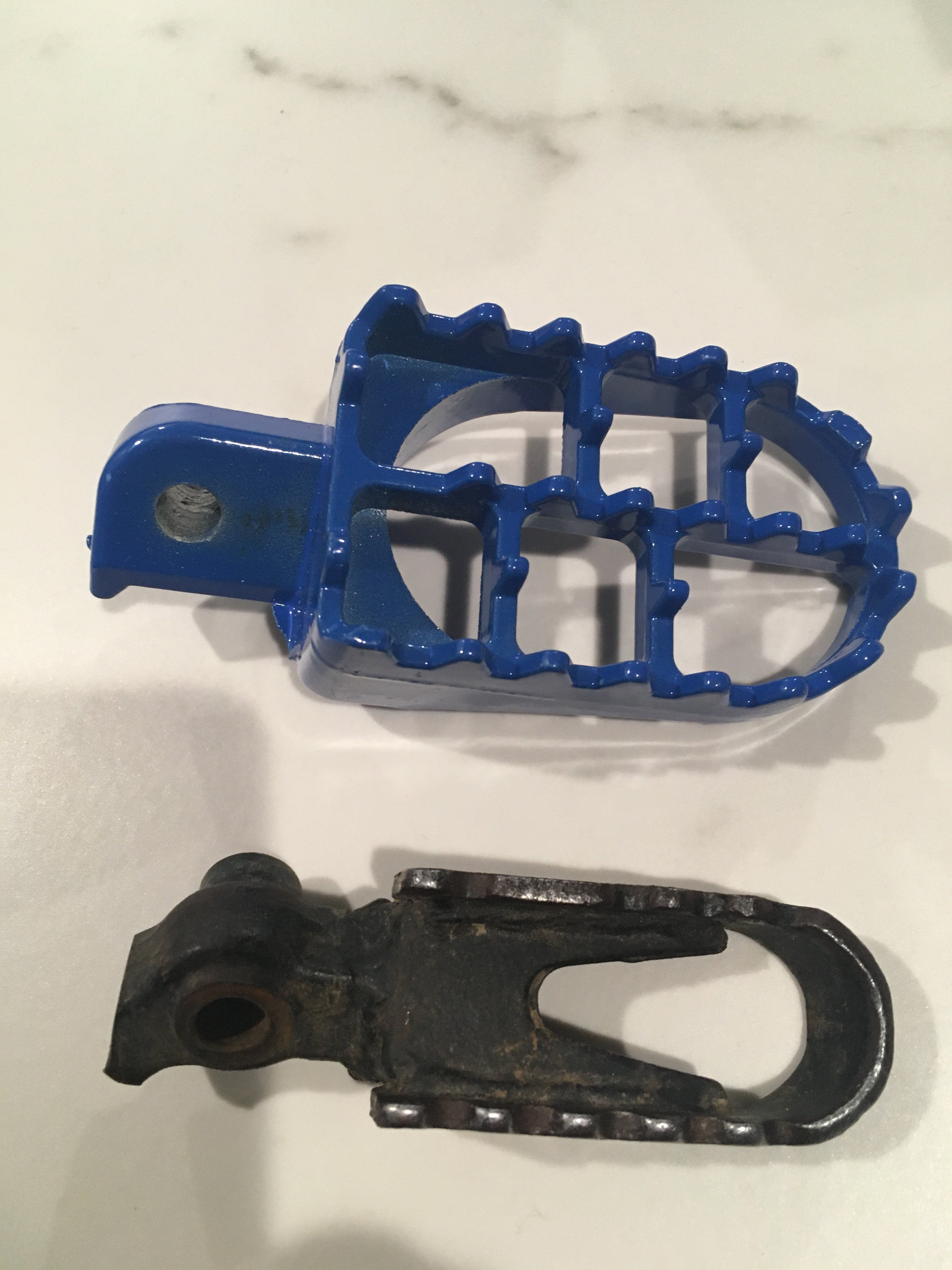

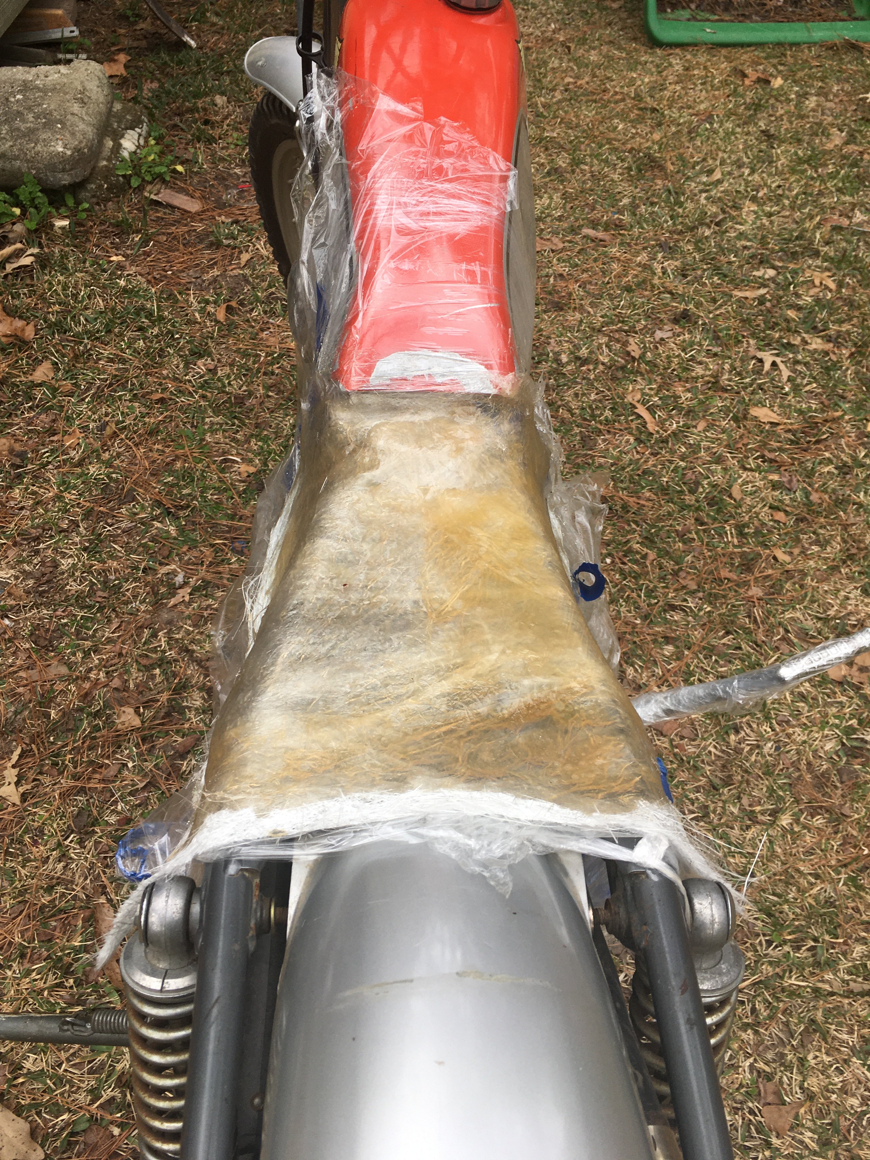

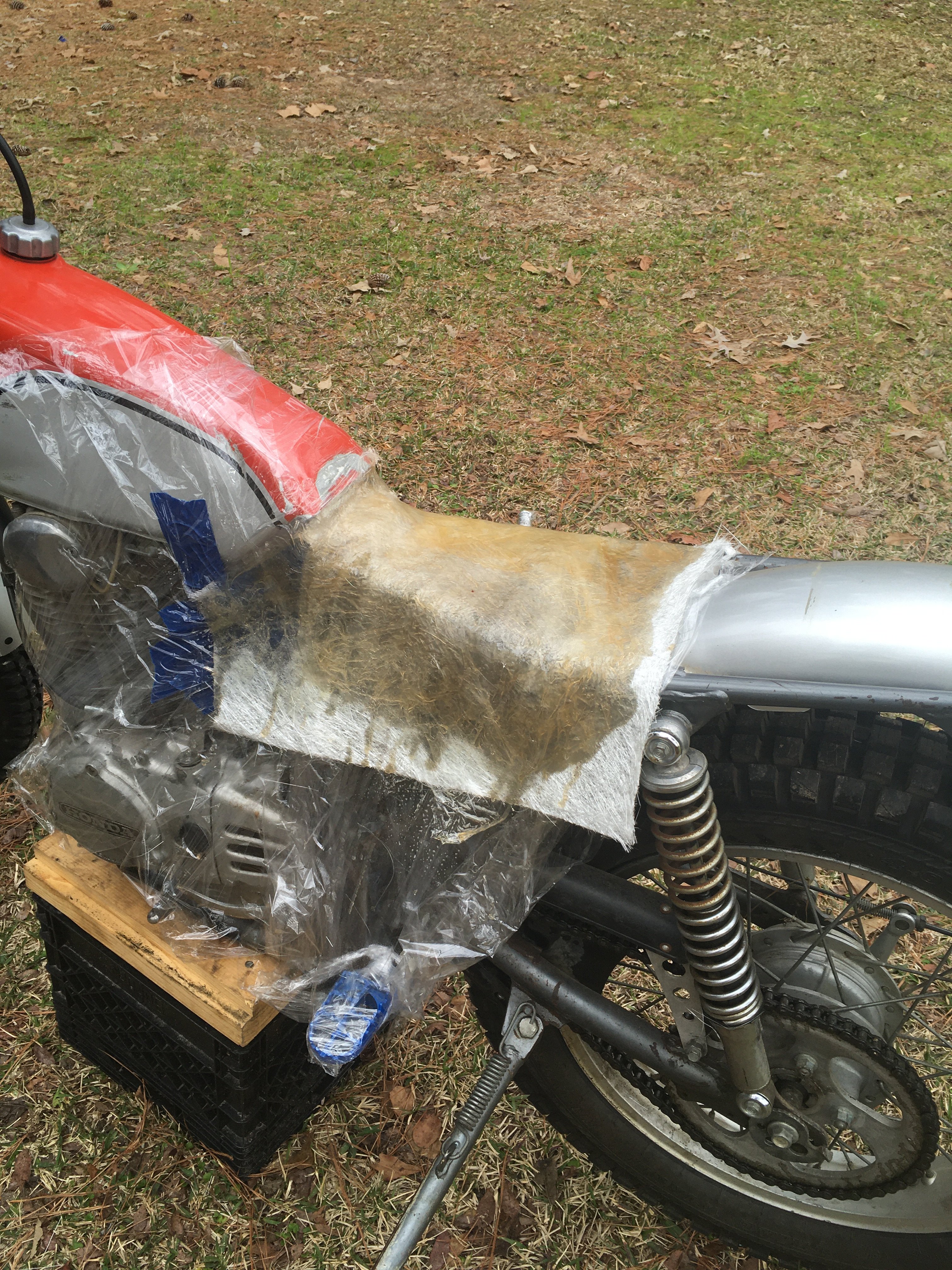

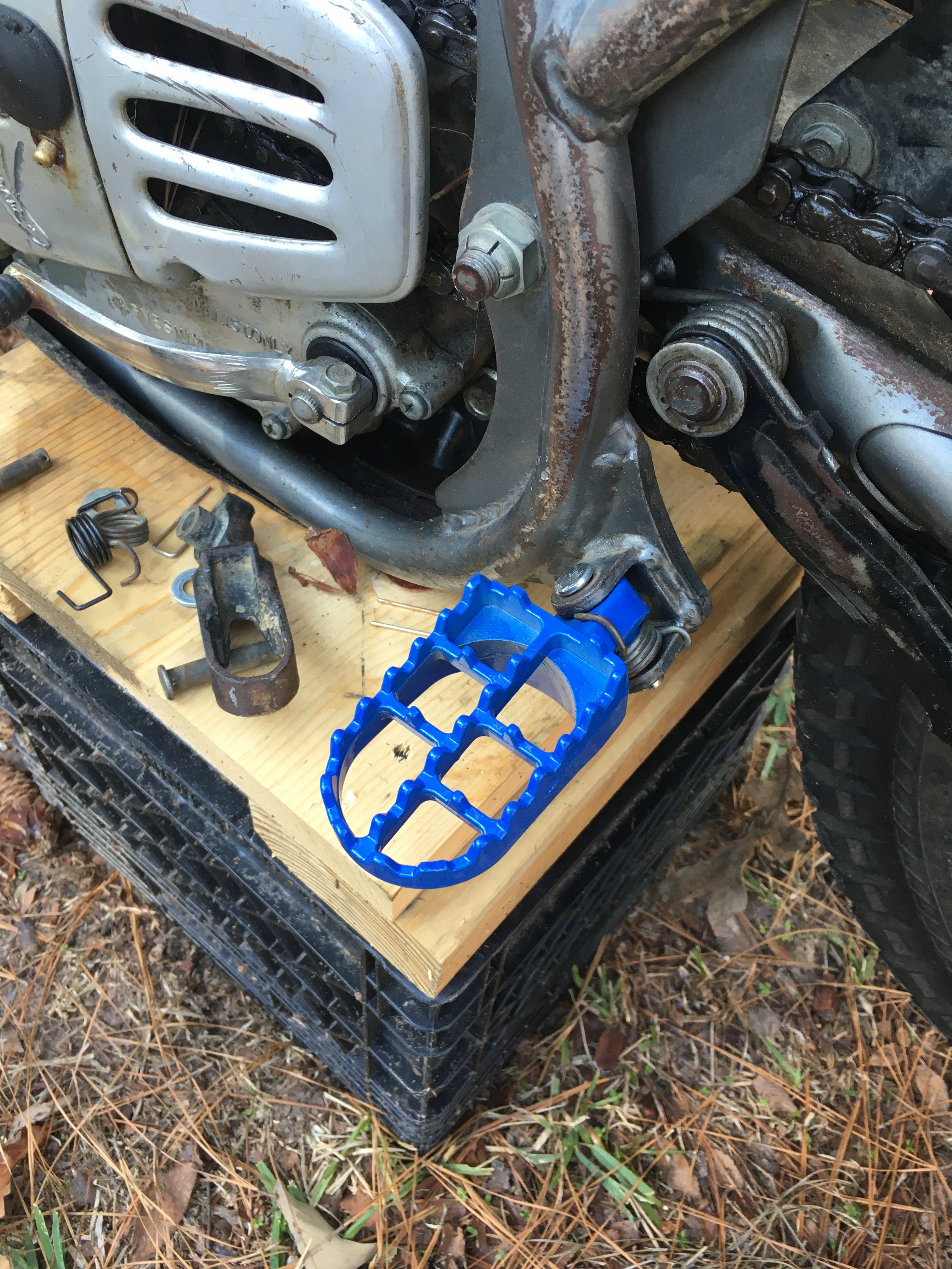

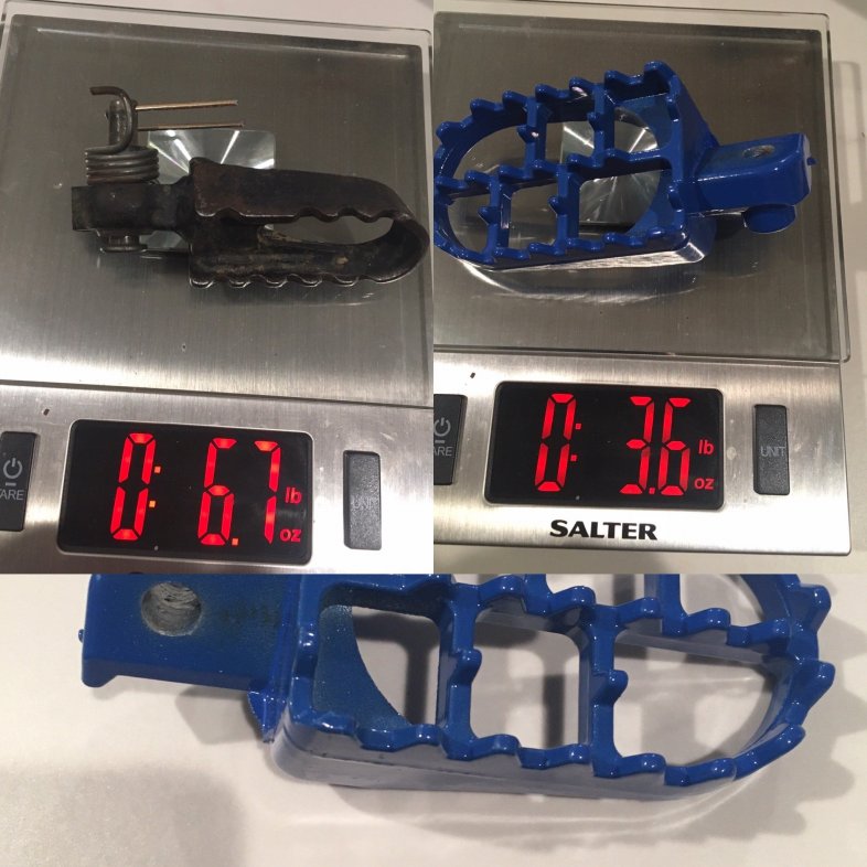

Done  moving the forks up in the triple clamps, replaced foot pegs... for sure a lot less weight with the new pegs...  broke one of the side panels for the 5th time... tired of fixing them so decided to build my own base /side panel unit.. just started today that's with the 2nd layer of fiberglass.. plan to do 4 more layers... next in the agnda do the extender on the clutch arm.....

Well finished the fiberglass project... been a learning experience:-)
Planning on building a 2nd one. I didn't  use a hard surface for the fiberglass to sit on , my first mistake... I had plastic wrap so there is some waves.. and use filler to take waves out..
I was going to put on high density foam for a seat...  but after riding it for a while seems that is fine...
