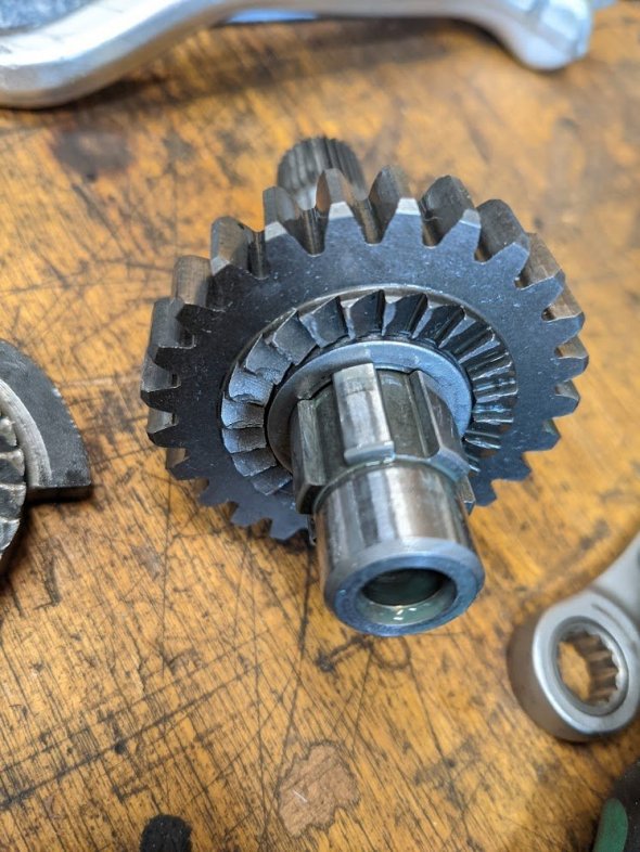

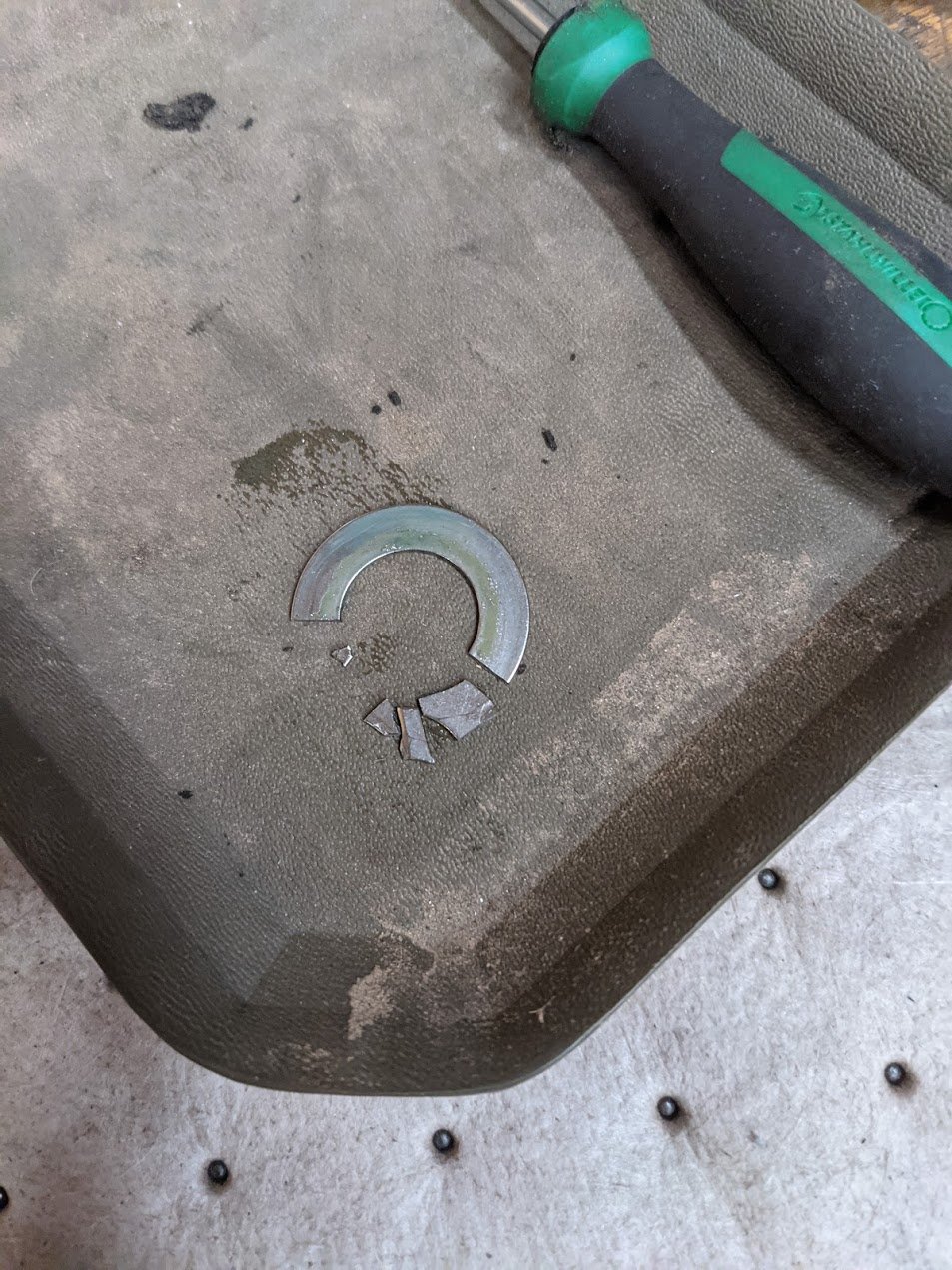

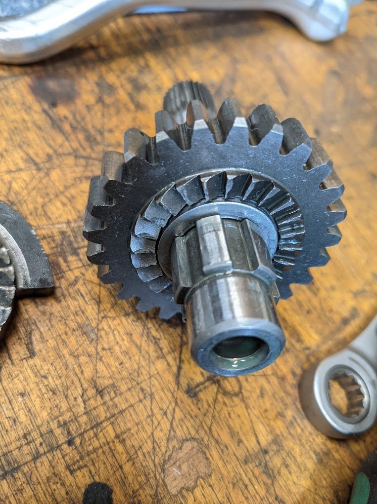

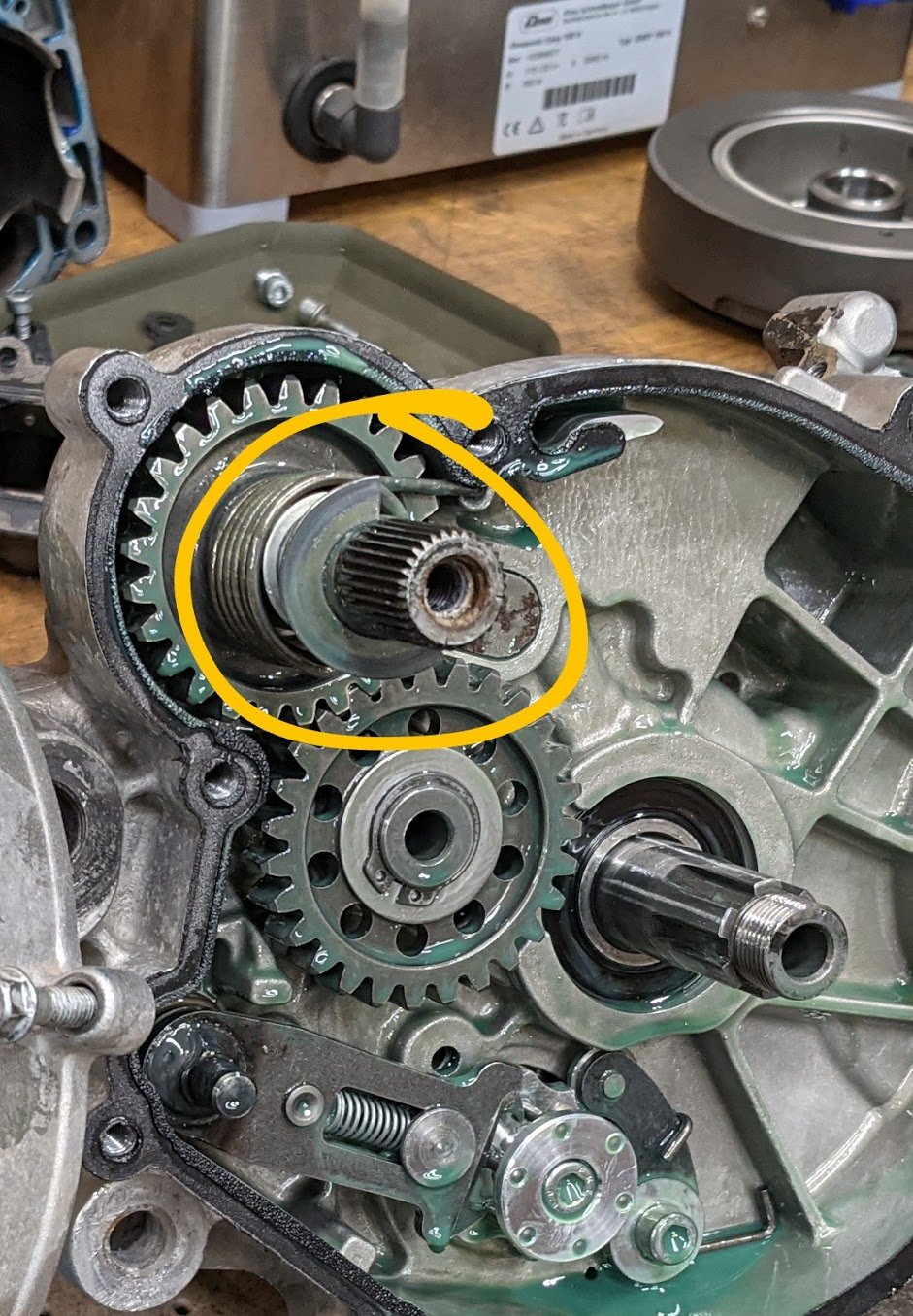

well seem to have found the issue after opening both halves of the case.
Washer of the kickstarter is in half, found about 1/4 of the pieces. There are 3 spots on the main drive gear that are chipped/rolled along with 1 tooth on the clutch basket.  Sticky spot at the top of the stroke is gone, all bearing feel smooth with no play.
We dug around in the clutch side for quite awhile and that's all the bits we could find.  Not seeing anything on the transmission side.
Question now is is the washer thickness sized specifically?  I know it's 1mm but wondering if a slightly thicker one would be okay.   Anyone seen this happen before?
Link to comment

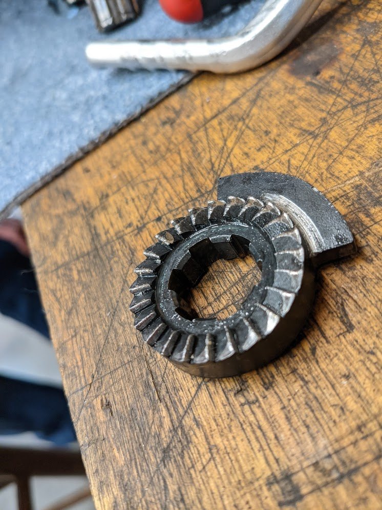

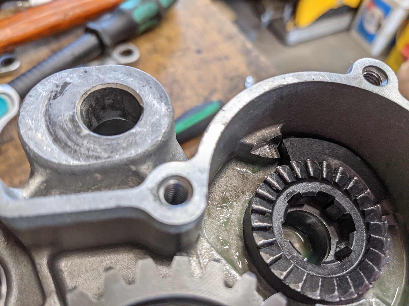

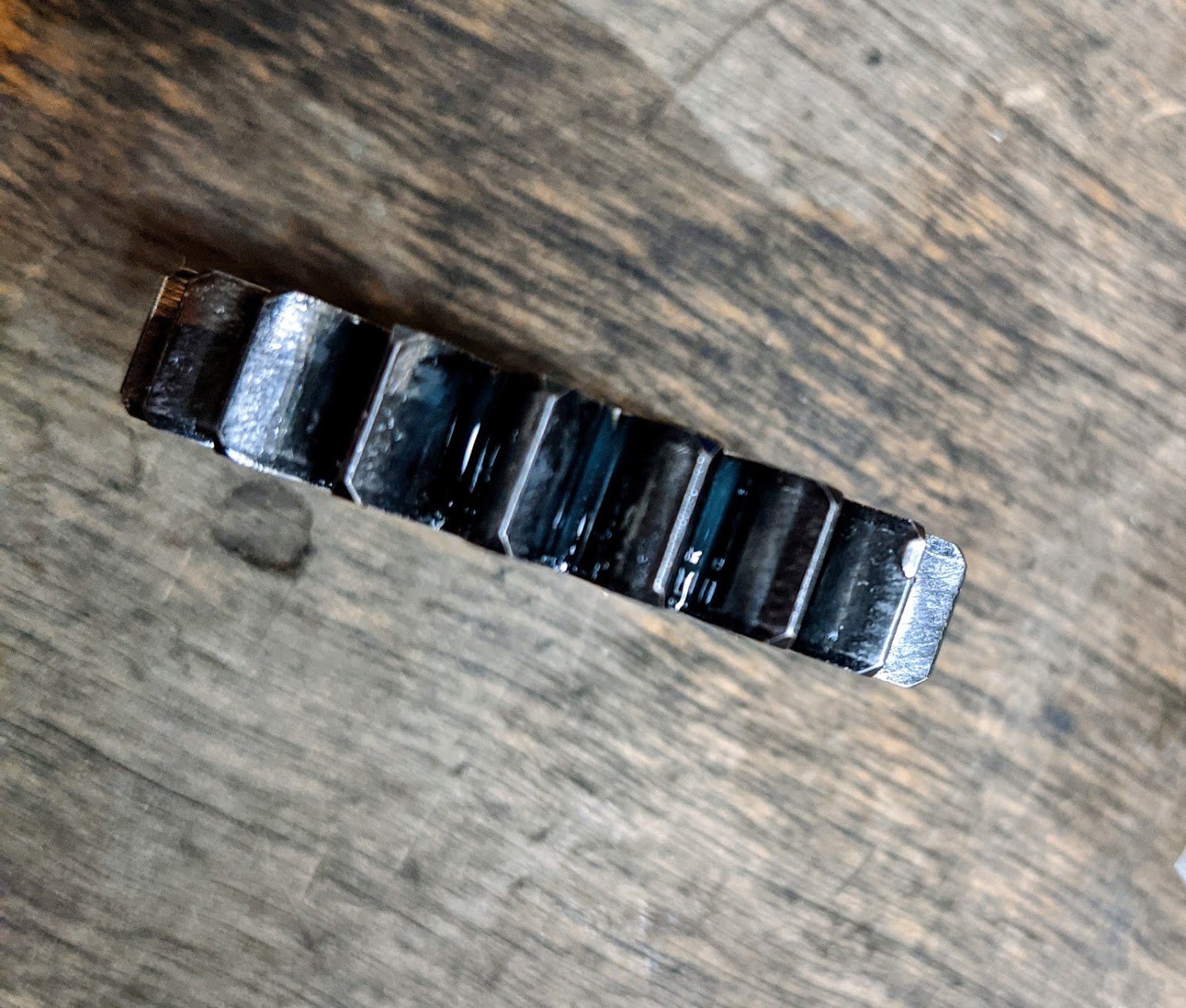

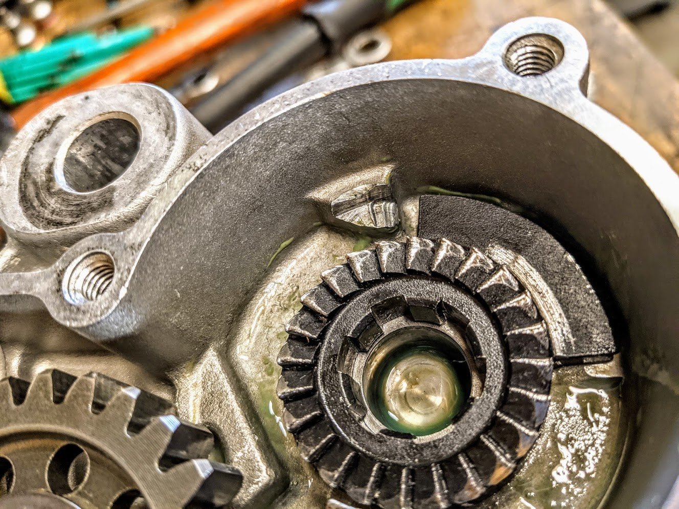

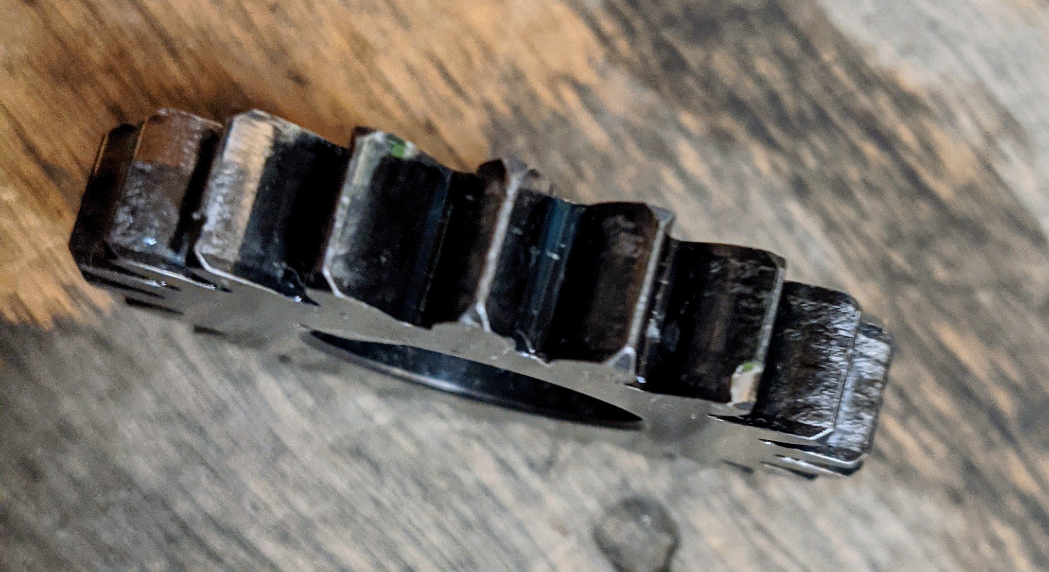

Well not quite the whole issue. Spend a it more time on it this morning.  Kick starter gear and rachet gear are jacked up.  Looks like the tab on the case that stop the rachet gear broke and allowed it to ride up and get jammed in the engaged position.
Anyone know if the case is machined here or did the tab brake off?
Link to comment
  • 2 weeks later...
got around to getting the fix ready yesterday.  Cleaned it up with a end mill and then drilled straight through.  Tapped for a 5/16-18 bolt/stud.   Waiting on parts to show up now.
