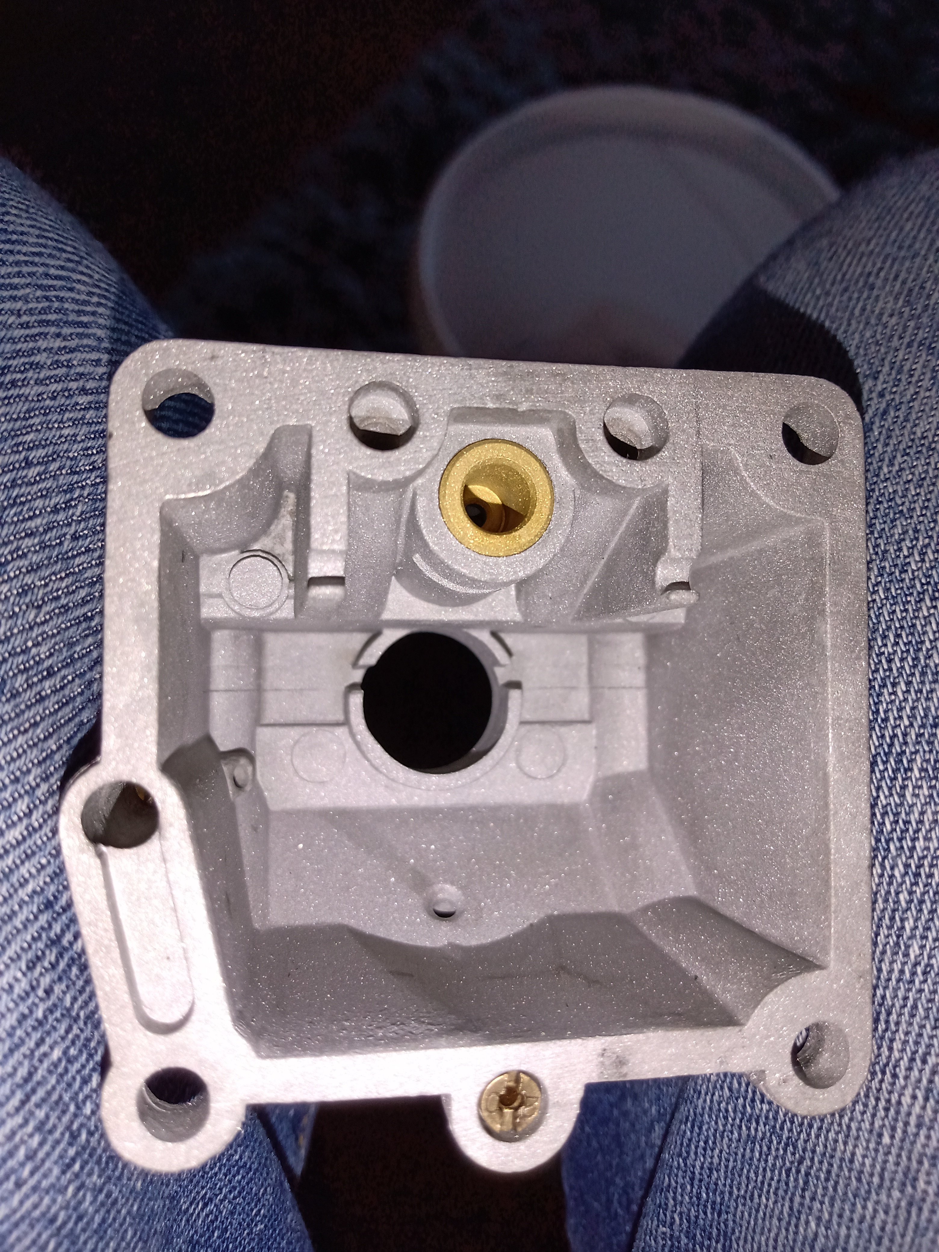

Many thanks for that advice. I will stick with what they recommend. Im not sure if you can help me or anyone else on the forum as I'm rebuilding a Amal carburettor for the bike. I've had the carburettor sonically cleaned and have purchased like for like replacement service parts. My question is on the jet pilots. There is a original 0.40 and a 0.20 in the original float chamber that I have purchased like for like. From the photograph could someone confirm they are in the right place. Many thanks again, Andy. 0.40 at about 9 o'clock, 0.20 at 6 o'clock16089030910232290552066905577896.thumb.jpg.cf118adcfc6c401011f35dd95e92ffcc.jpg16089030910232290552066905577896.thumb.jpg.cf118adcfc6c401011f35dd95e92ffcc.jpg16089030910232290552066905577896.thumb.jpg.cf118adcfc6c401011f35dd95e92ffcc.jpg
Their placement is correct. Size 40 jet at 9 o'clock and 20 at 6 o'clock.
That's great news, thanks, I know I don't know you but the advice today on Christmas Day is very appreciative. Hope you have a wonderful festive period, keep safe, Andy
