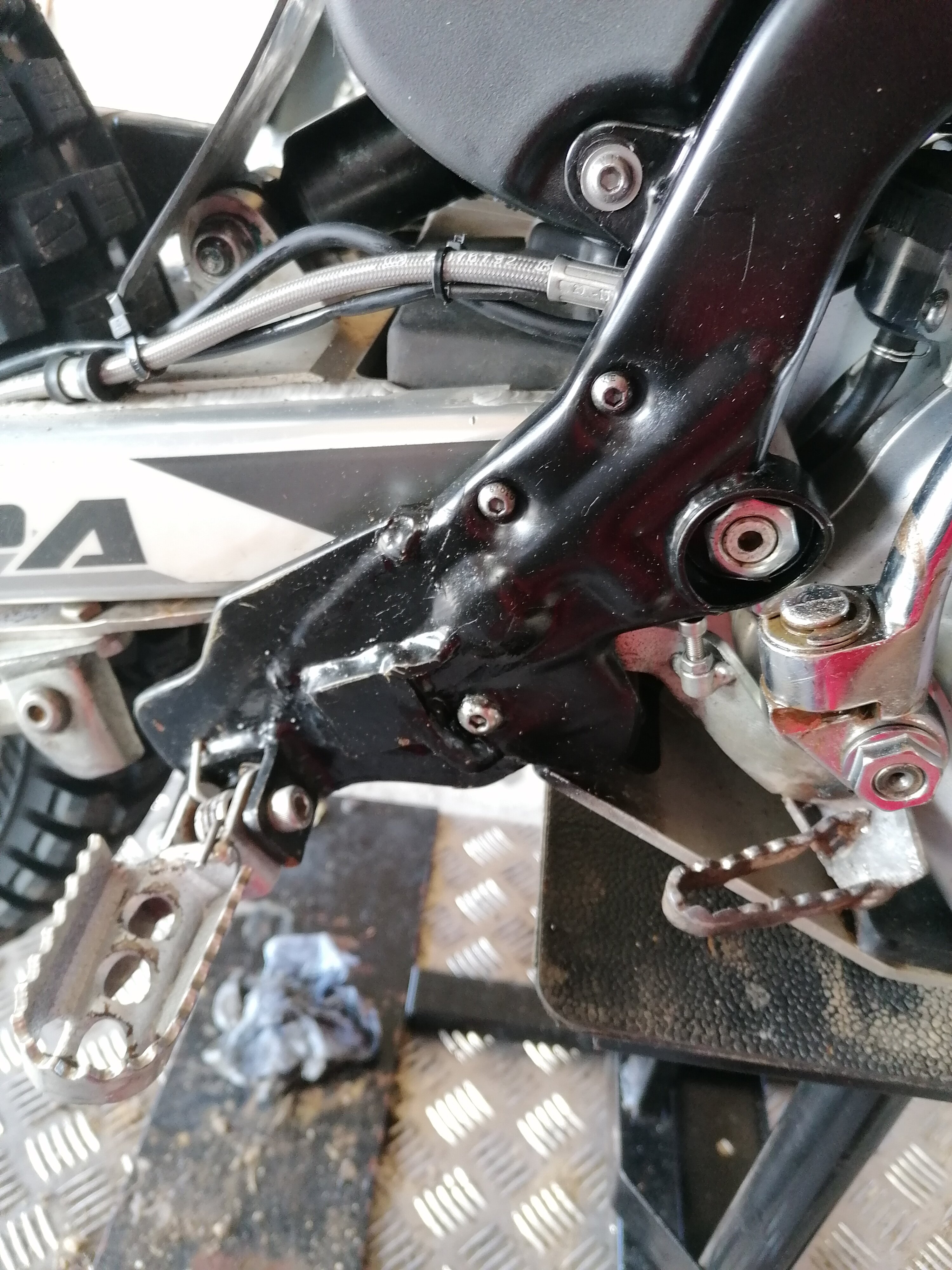

Has anyone replaced the rear brake lever on a ty125f? Mine's had a clout before I bought it and it's mangled. I've tried straightening it but it fouls the kick-start lever when kicking over. Does it need the lever specific to this bike, or will a replacement from such as Apico for other Scorpas fit? I've also found out that the original owner has spent a bit of money on this bike before he used it. The carb has been rejetted to Birkett recommendations, exhaust debaffled, and footpeg placement moved further back than standard. This was pointed out to me by Peter from Non Stop Trials. It's such a neat job that I never noticed it. What other modifications are there for this bike I wonder? But first and foremost.... What rear brake lever will fit?

Got no response, so bought a new original part.

Hey Waynetod, I'm trying to find a replacement brake pedal for my uncle's 06 tys125f, can you please give me any sources you may have to order one? Thanks! :)

I got mine through Non Stop Trials. I thi k they get them from Nigel Birkett. I don't think they e changed the design, but best to ask.
