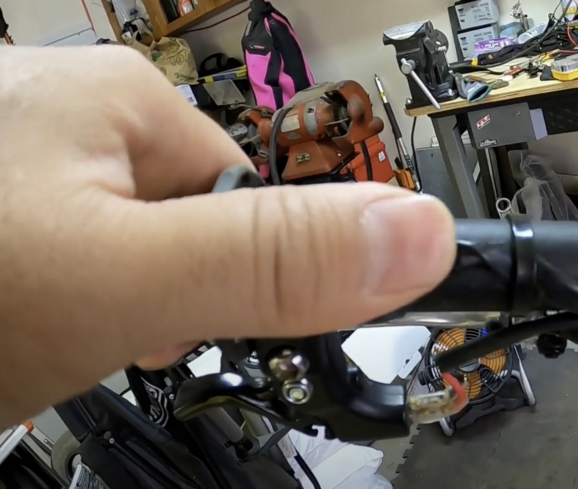

Really cool that you came up with the connectors. Thanks! I have attached a pic I grabbed from one of John's (Ka Uila Motors) YouTube videos. Look below his thumb and you will see a mini-lever style trigger-switch that he is using for his region braking. He is selling the whole setup, plug-n-play ready as an alternative to a push button. To me, that is the solution that makes the most sense. Being skilled in electronics, I want to save the cost by assembling my own. However, so far, all of my search efforts to find a trigger-switch like that have turned up nothing. Danged if I can find one!
If you look close, there appears to be a cutout for a cable in the lever. Maybe it's a clutch or brake lever with  safety or brake light switch.

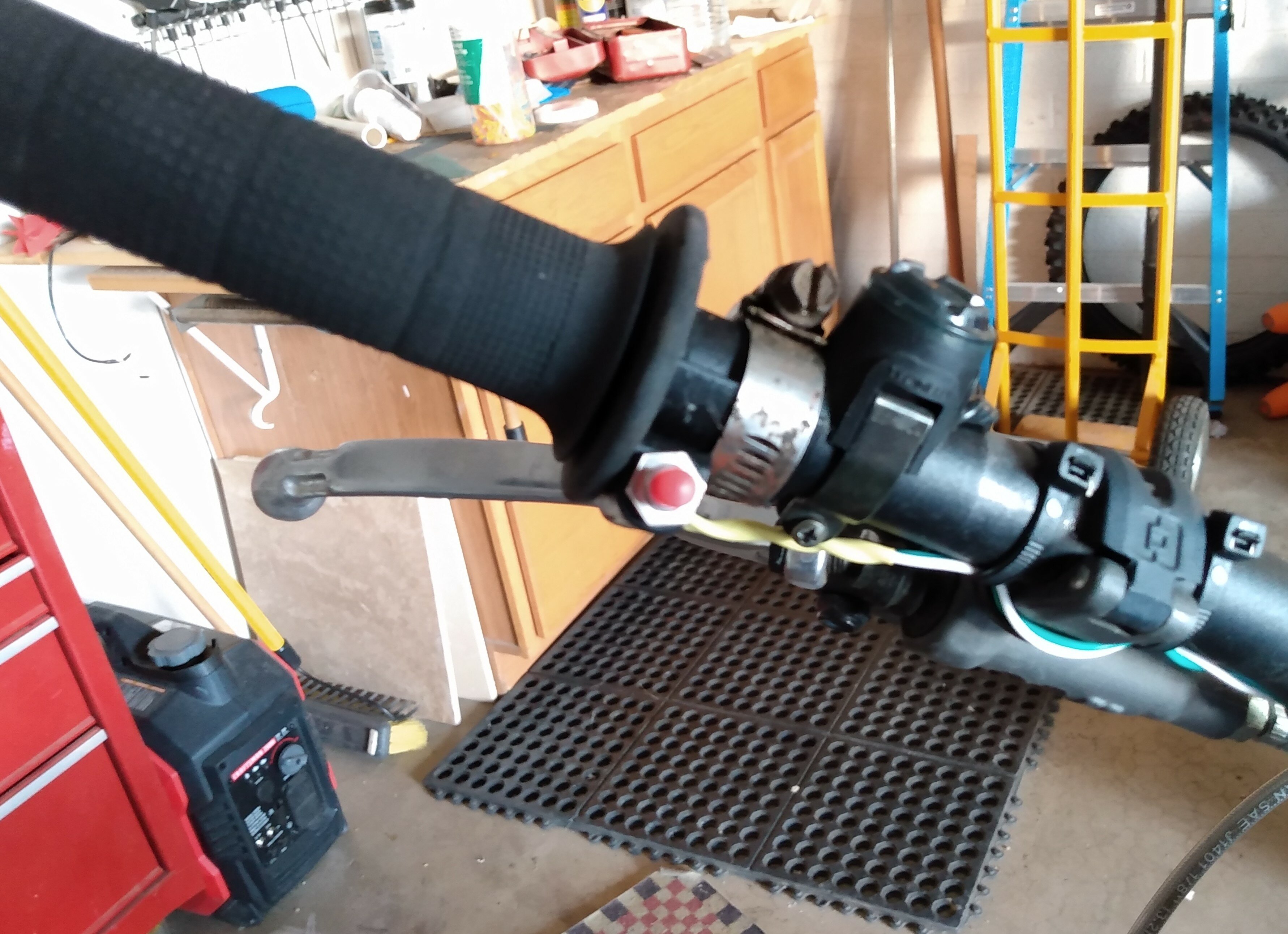

Attached photo of a temporary FRB button under the right side handlebar. Home brew. Attached photo of the dongle on the EM Race 2021. Measured voltage between red wire and black wire on dongle using a Klein tools MM300, DC voltage 20V range ,is 4.8V.  Blue wire to black wire measured 0V, black wire to exposed metal of frame of motorcycle measured 0V. According to the video on Central Powersports Distribution web site the FRB switch when closed shorts red wire to blue wire (red and blue reference the attached photo of dongle). Attached pdf is the datasheet for the connector needed if you want to build your own FRB switch.
My experience with FRB: The drag created when activated is noticeable.  If my experimentation using it at various speeds and slopes of hill is accurate, and I am prejudiced wanting to believe the following because it seems to be correct from physics, the regen drag is proportional to velocity, and cannot cause the rear wheel to lock. I would like to read other riders experience.

I've had a couple of practice sessions with the fixed regen now. I certainly wouldn't want it every time the throttle shut off. It provides quite a lot of braking and does lock the wheel on a slippery surface. It also provides more braking than needed when just check braking to control speed on a gentle descent. It's possible to  modulate braking to some degree by doing a sort of cadence braking.
I am using one of John Uyehara's levers. The position of the lever under the clutch lever is good but I am having to school myself not to ride with a finger over the lever. The spring on the lever is so light that it's easy to apply the brake by mistake, usually at the most inopportune moment. I might try a thumb button instead, but I would rather find a stronger spring for the lever.

I really like the button under bar I’ve been using. If I want less regen, I can just slip the clutch a bit while holding in the button. With the location- that is pretty easy to use.
