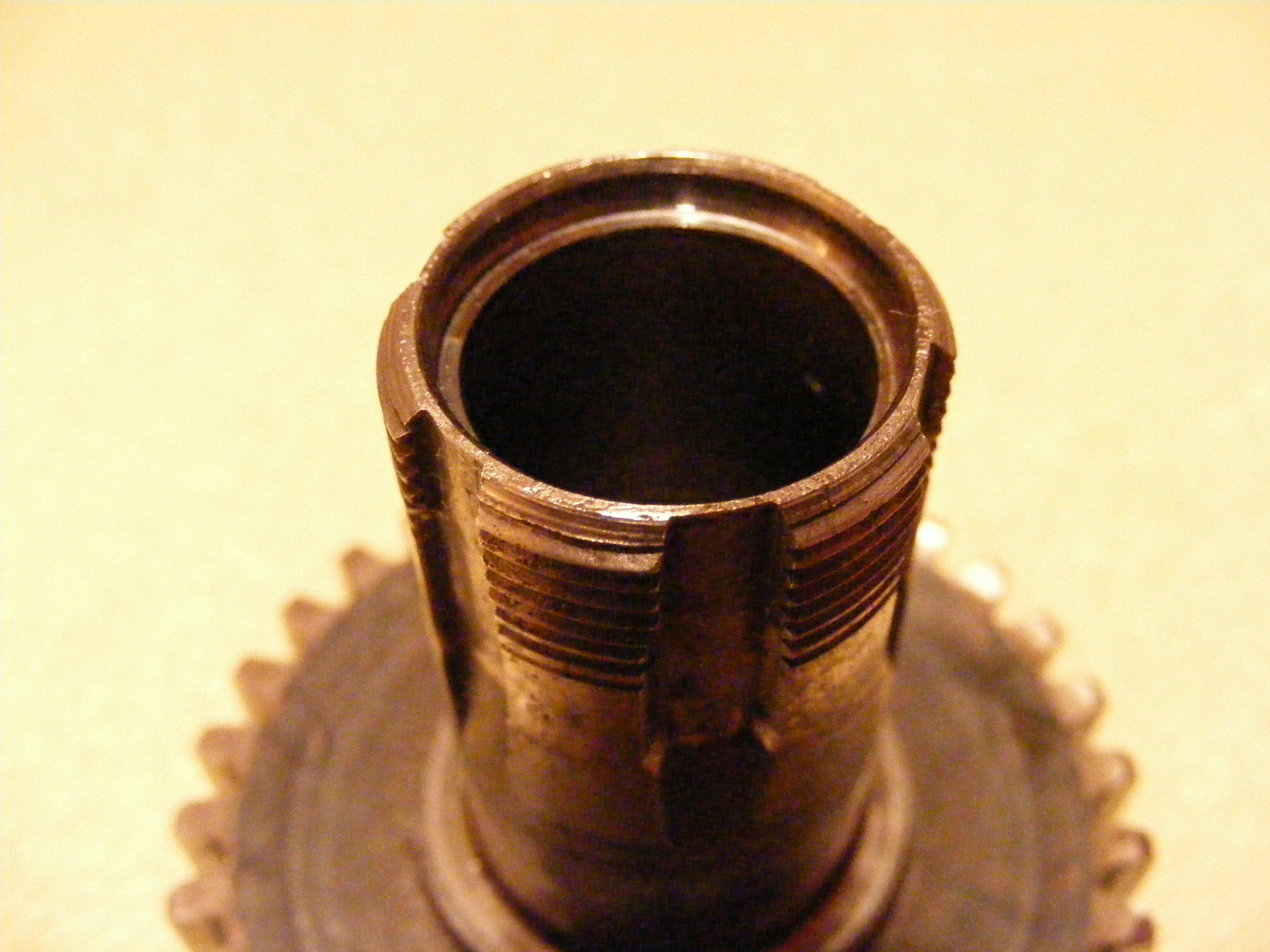

16272360438404153989677471381909.thumb.jpg.48f7d3481fed8255ee02ac3a7e3bc8bc.jpgThanks Lorenzo, I was hoping it was my eyesight but I don't think the remnants of a seal are there.I've tried feeling for an edge with an engineer's pick but can't feel anything.There is a slight bevel on the inside of the threaded end of the sleeve gear but otherwise the I/D of the sleeve gear is 18mm all the way through.Unless there was a recess for the seal I don't see how a 20mm seal will fit?

The sleeve gear you have appears to be an earlier variant, which would have had 2 bronze plain bushes..........and NO oil seal..... It doesn't belong on a 191.

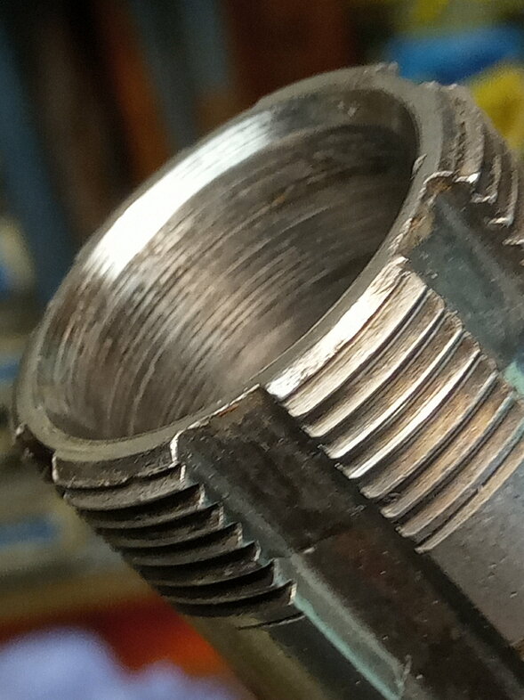

On 5-spd. Sherpas,  the early type sleeve gear bushes were replaced  from mod. 124 onwards with needle roller bearings and the 20mm. o.d. seal #160-031 and this arrangement continued to the end of production as far as I know..
I've dug out a mod. 124 sleeve gear so you can see what yours should look like: (ignoring the worn sprocket splines)
..1201051808_Sherpamod.124sleevegear004.thumb.jpg.d017225d6f74146438f259d860dea8e3.jpg
As far as counterboring your existing sprocket,goes,  it looks to have suffered some significant scoring to its bore. If your new needle roller bearings are to enjoy a worthwhile  service life, the bore needs to be very smooth. (see above).
To save yourself lots of further grief, you may do well to check off all the other gearbox parts against the parts book; some earlier (or later) parts will interchange and work, many will not. Who knows what mechanical mischief it may have suffered in the last 40-odd years ?
