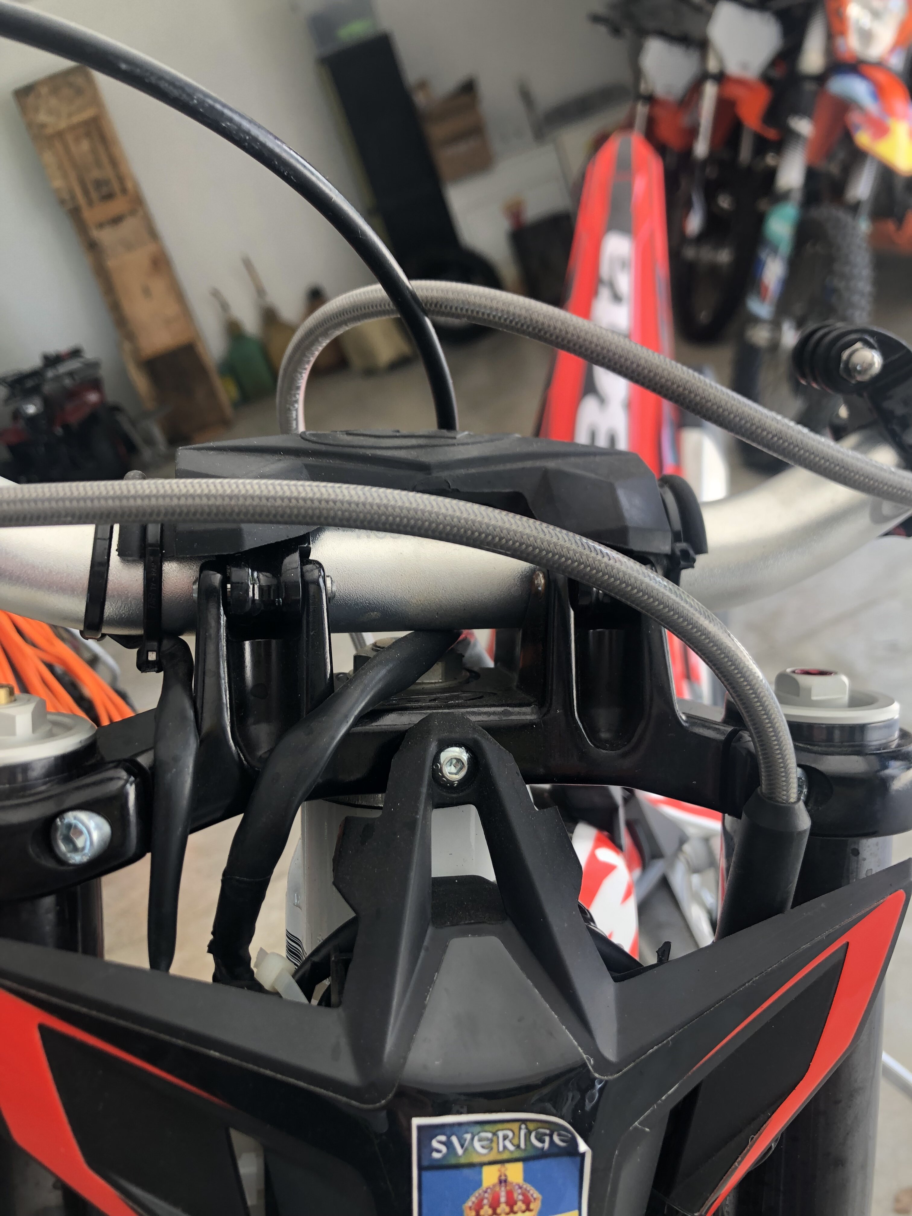

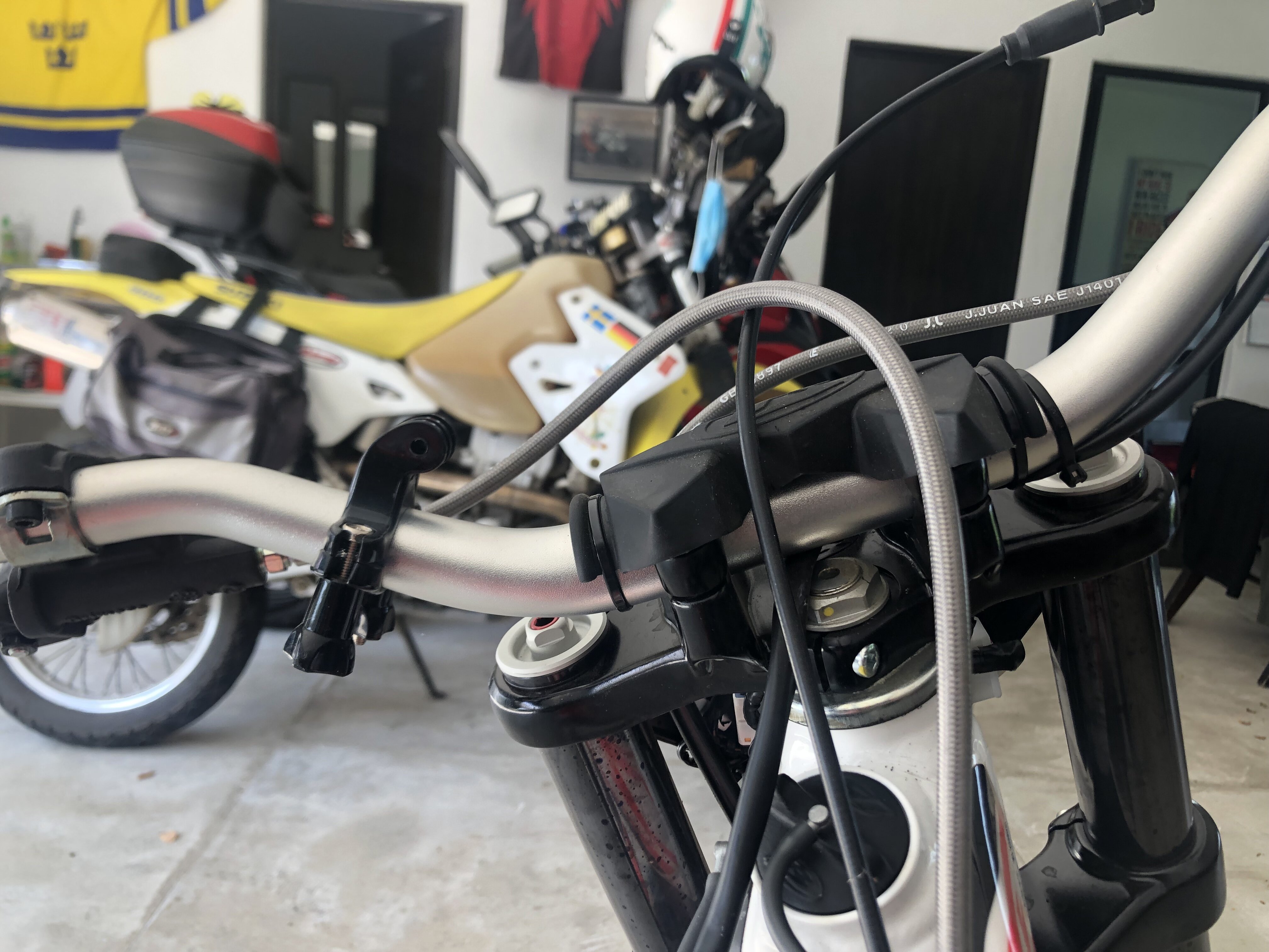

Hi and thank you for the input, yes initial thought but the bar mount on the beta is not the norm. its a hinged clamp,

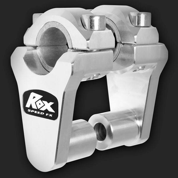

You could try the universal bar risers off flea bay, they clamp into the existing mounts and then the bars clamp on top, the have removable  inserts to allow for normal or fat bars
Bar risers are not an option, look at the pics he's put up of the Beta hinged clamp which is integral of the top triple clamp.

If the current clamps are bolted to the top yoke, an option would be to ditch them and replace with conventional bolt on clamps.

pretty sure this is what greychapel meant. They would work with the hinged clamp
