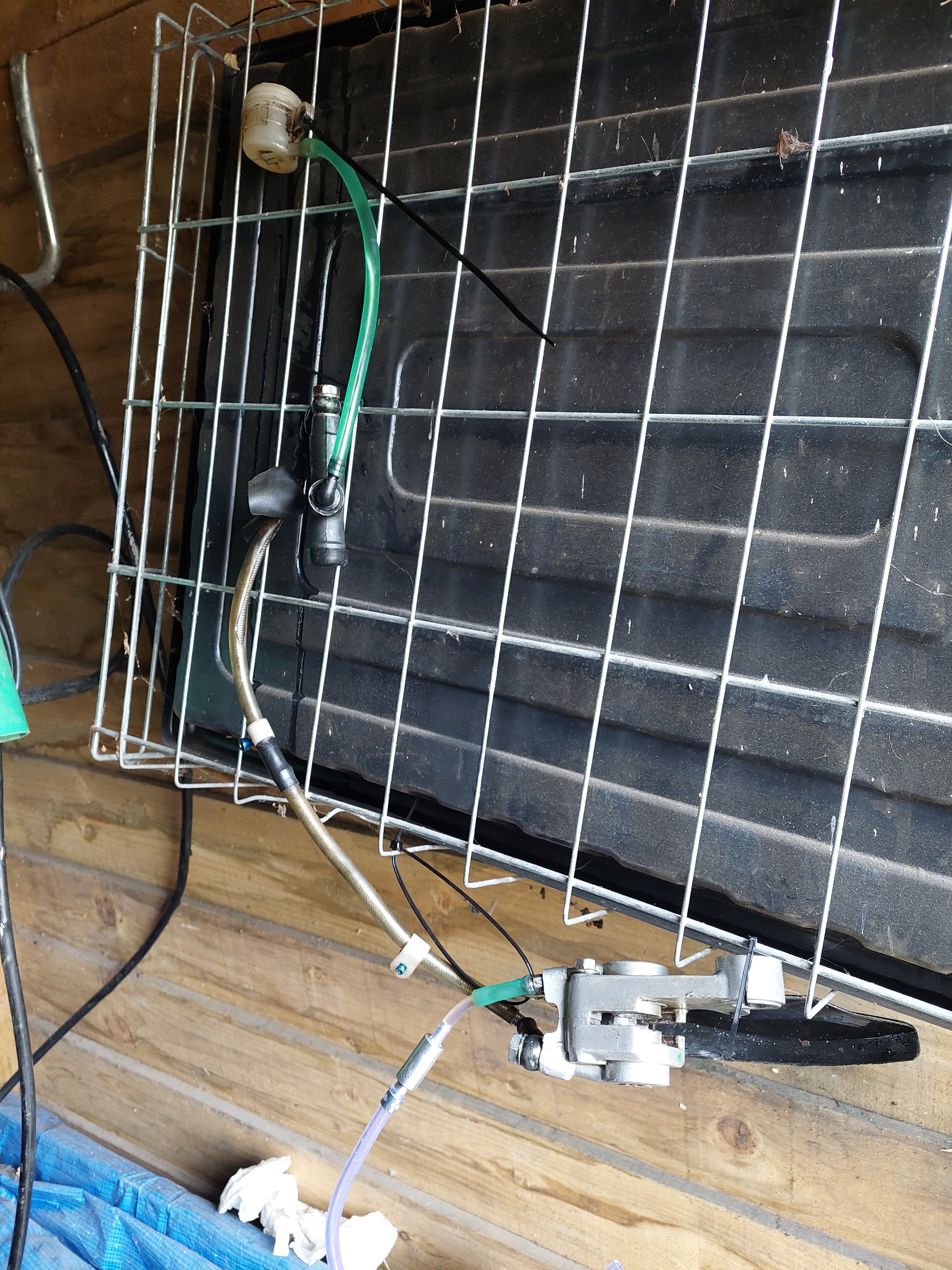

I'm back from skiing now so time for an update.
Before I went I tried lifting the front of the bike and bleeding having tried lifting the rear which I never thought would work as there's no logic to it.
As it was I left my bike for a week with the front lifted with an obvious air bubble in the link pipe,that was still there when I got back FFS.
In summary I have tried every method possible together with new parts,but this mornng I took the whole system off and bled it as described in the video by lineaway.
I think the angle of the parts is vital.
Bit of a ball ache getting it out in one piece but this method as shown in the vid worked first time,I'd have taken the ****ing engine out if I'd know it would work.
Thanks to all that have given advice.

This is how I hung the system,the air escaped almost at once i didn't even use the one way bleeder once I'd hung it.
