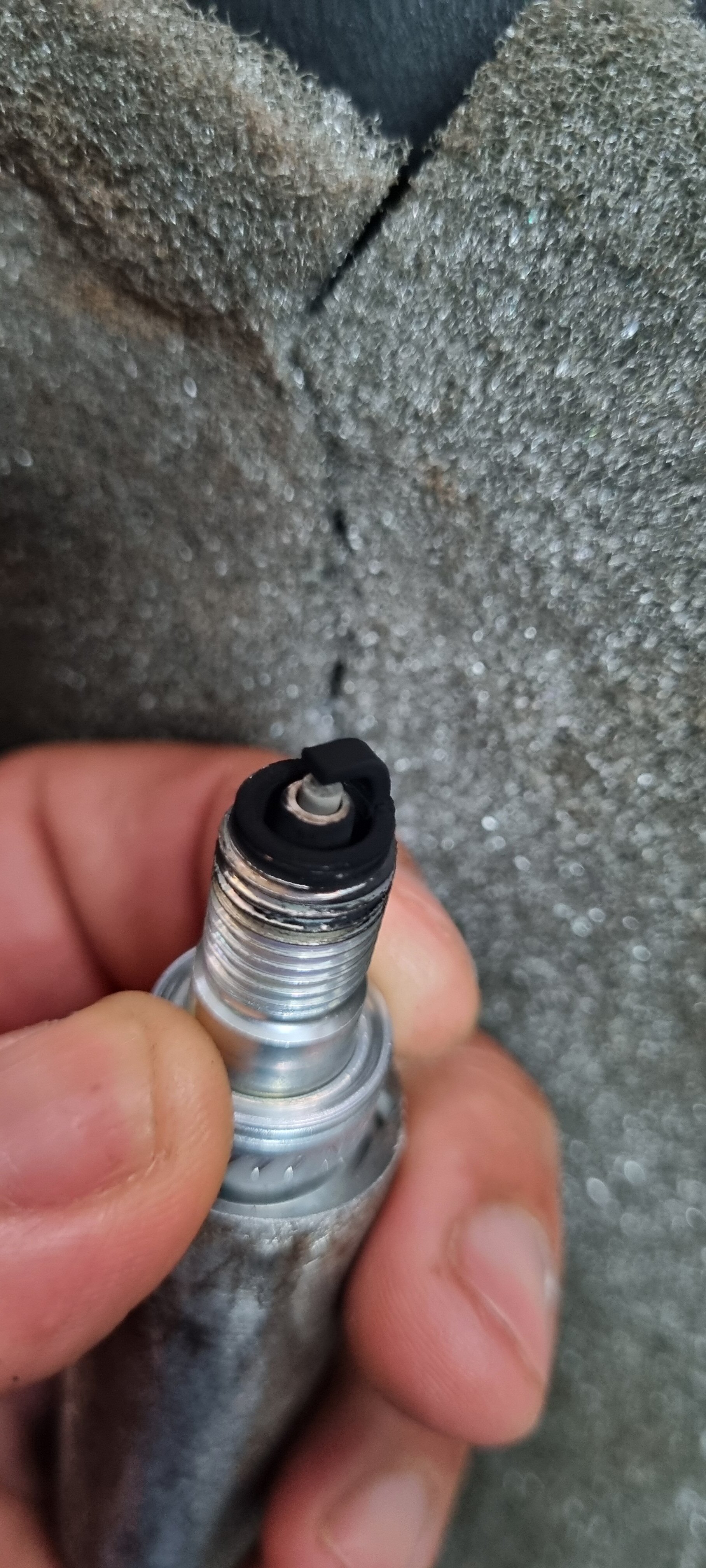

I return to the topic since I have a similar problem, the bike is new, 301 model 2024, delimited with a race kit with exhaust without catalyst and P71 ecu. The bike starts more or less well when cold and hot (first or second kick) but it has a hard time maintaining the idle speed, especially when cold, with irregular idling and backfiring. The operation is correct, the motorcycle runs well but when you release the gas the idle is erratic with some backfiring. It smells a lot like gasoline. I have removed the spark plug in the state that I provide in the image. totally black. I have regulated the idle speed and it regulates it regularly but it fluctuates erratically with some backfires and desynchronization of the idle speed regime. I have changed to 98 gasoline with 5 percent ethanol, there is no other in my area. any ideas?

thanks for responding. I had read that the optimal idle speed was 1800 rpm. Right now I don't have a tachograph but I estimate that it will run around 1800 rpm but it works irregularly, on the first burst of gas it smells like gasoline and after 2 hours of use this is what the spark plug looks like. I have been told that some of the 2022 and 2023 models came with a fuel pump problem that prevented them from starting hot. There is even a scam about it. Mine starts well when cold and hot, my problem is unstable idle and backfires more when it's cold than when it's hot. I understand that your motorcycle, with the idle speed above 2000 rpm, has a stable idle speed without failures? With those revolutions don't you have the electric fan running all the time? Mine is another thing that I detect, that the fan is activated practically all the time and has very long cycles.
I bought my tach, before my bike showed up. After 8 months after a bad weekend of the bike running like crap, I finally installed the tach. I have not had a problem since. My idle is set above 1800 when it starts and I do not touch the throttle until after it reaches above 2000. I would replace the plug. I also had to replace the plug cap as it was bad also.

I can't even imagine how a 4RT engine could be making that much carbon, unless the sump is pumping engine oil into the intake or the air filter is over saturated with filter oil and it's sucking that into the intake, or an intake valve guide compromised.  Does your engine eat oil?
