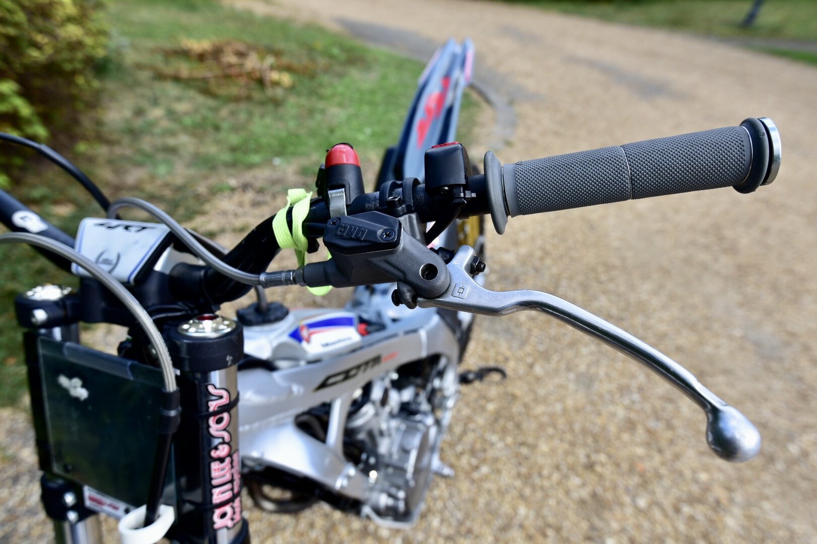

September 1, 20224 yr So my new 4RT has come with braktec Master and slave cylinders fitted for both the front and rear brakes. I am assuming hay these are not fitted as standard to a normal out of the box 4RT? My question is relating to the free play in both levers, that is the vertical movement up and down, not the travel of the lever in normal use of the brake and clutch operation. So I would like to know if they all have so much free play? I can only describe it as wobble, it seems to be too much to me, perhaps about 25-30mm of vertical free play in each lever? I assume they have a brass bushing as the bearing inside the actual lever, but do they perhaps need spacers on the top and bottom? It would be nice to hear from anyone who has the same brakes on what yours are like? Thanks in advance, and sorry if it’s a dumb newbie question! Edited September 1, 20224 yr by Nigelpugh Spelling mistakes by me!

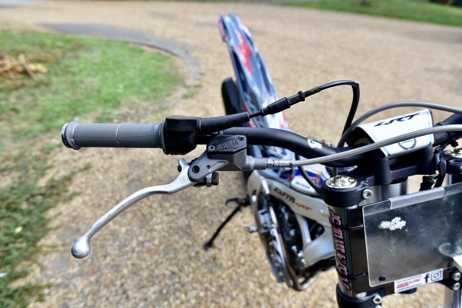

September 1, 20224 yr Author 3 minutes ago, Nigelpugh said: So my new 4RT has come with braktec Master and slave cylinders fitted for both the front and rear brakes. I am assuming hay these are not fitted as standard to a normal out of the box 4RT? My question is relating to the free play in both levers, that is the vertical movement up and down, not the travel of the lever in normal use of the brake and clutch operation. So I would like to know if they all have so much free play? I can only describe it as wobble, it seems to be too much to me, perhaps about 25-30mm of vertical free play in each lever? I assume they have a brass bushing as the bearing inside the actual lever, but do they perhaps need spacers on the top and bottom? It would be nice to hear from anyone who has the same brakes on what yours are like? Thanks in advance, and sorry if it’s a dumb newbie question! Should’ve posted a picture to show the levers , so here you go! Edited September 1, 20224 yr by Nigelpugh Wrong pictures
September 1, 20224 yr Author Sorry don’t know why it keeps adding all of my pictures! Still not used to the quirks of posting on this forum!
September 1, 20224 yr Author Quick update on this, I had some spare time today so unbolted the brake lever. The Allen headed bolt is threaded at the bottom and also has a lock nut on the outside. I removed the lock nut, and unthreaded the bolt to take the whole brake lever out. Brass bush and a nylon bush on the other side both in place, no signs of excessive wear. So replaced the lever and tightened the bolt up, which seems to pinch the body closer together and then put the locknut back in place. All good now slack removed, a very simple job in the end!! Edited September 1, 20224 yr by Nigelpugh

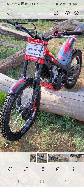

September 21, 20223 yr Before I even started my bike ( I got it in the crate) I had stocked up on a lot of CSP parts. So I installed new triple clamps, skid plate, levers, s3 titanium header. And many bling items in red that I will list later. After this pic was taken, I replaced all the original plastic. Edited September 21, 20223 yr by lineaway

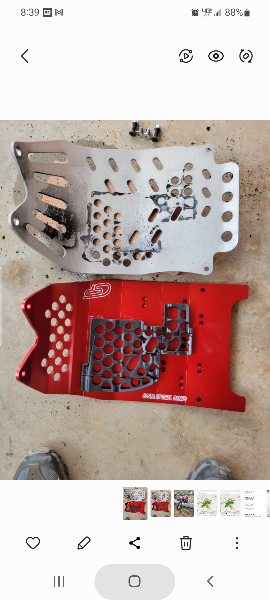

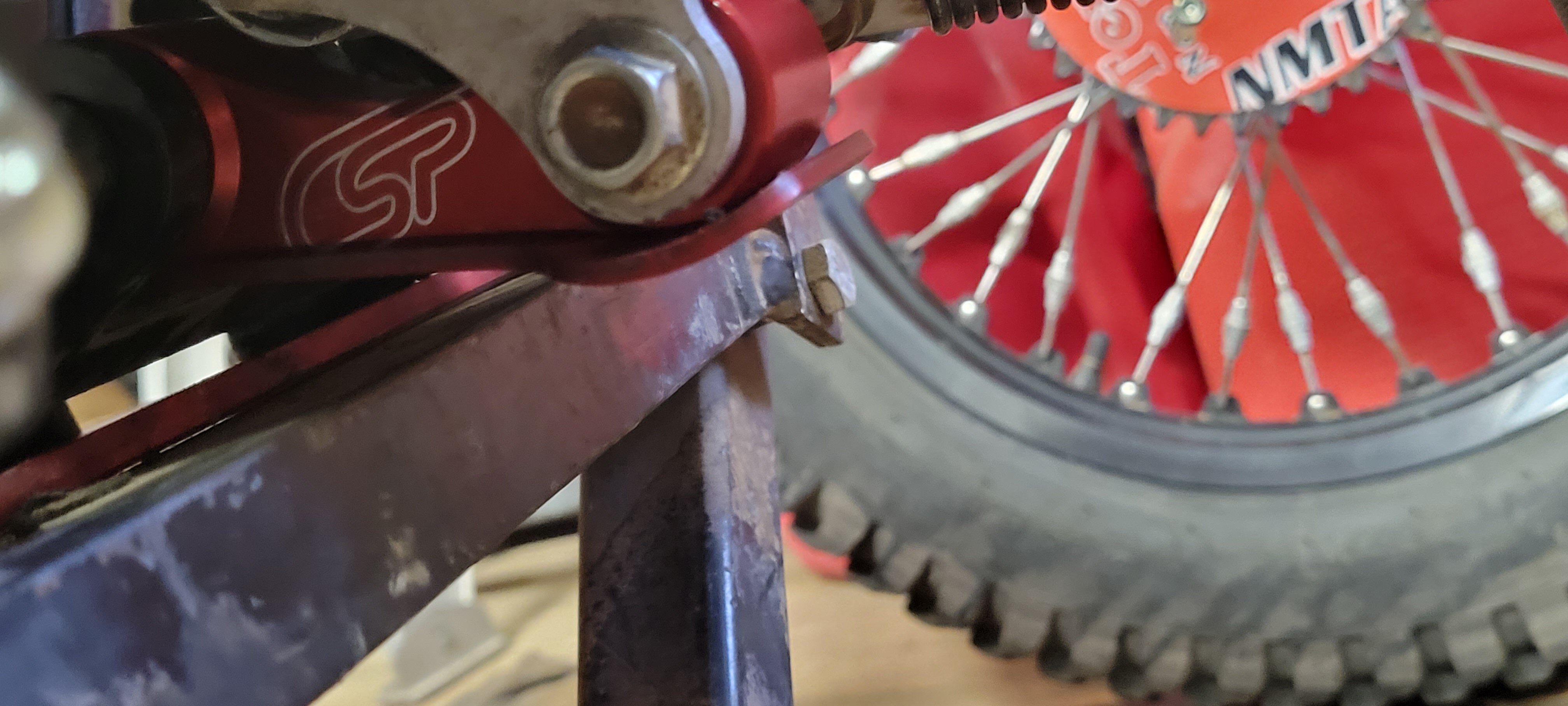

September 21, 20223 yr I went with the stronger skidplate and cut the plate rubber to make oil filter changes easier. I also put longer skid plate bolts in the rear, to never have to remove the skid plate during a oil filter replacement. Edited September 21, 20223 yr by lineaway

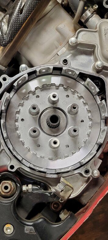

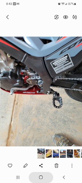

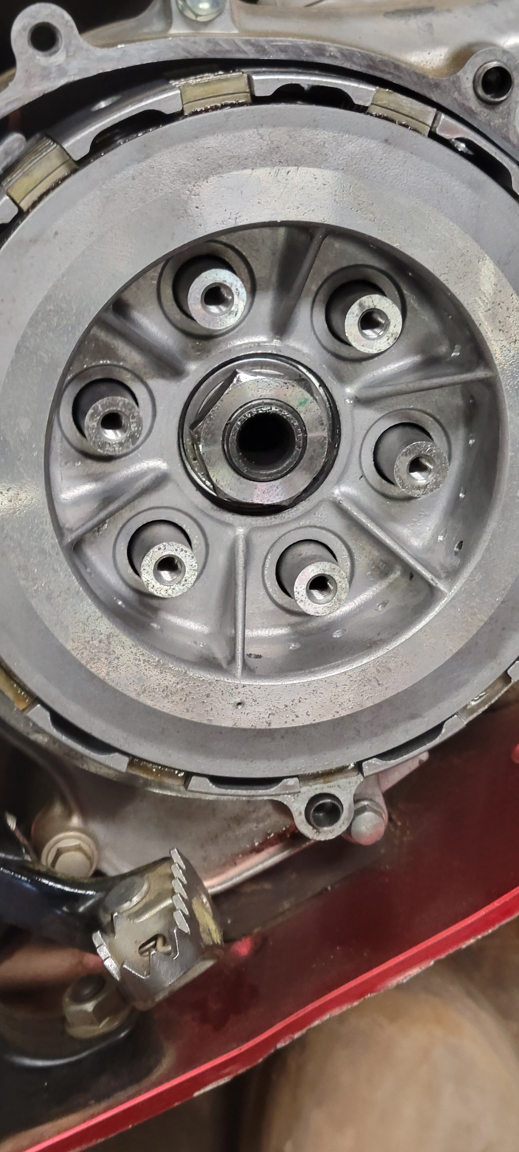

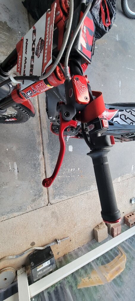

September 21, 20223 yr CSP parts. Triple clamps, skid plate, case saver, m/c lids, Timing bolt, both oil fillers, gas cap, axle nut, swingarm bushing covers, dog bone and dog bone skid plate, lever adjusters. S3 PARTS Header pipe, curve foot pegs, bar ends, digit levers. Jitsie 9 tooth counter shaft sprocket, 38 tooth solid red rear sprocket. TRS Gold front caliper with matching AJP large resivoir M/C on brake and clutch. Replaced magnet with ATV racing teather. Went to EBC friction plates and Apico dimpled steel plates. Apico aluminum fast throttle tube. Modded my clutch basket for better oil flow to the plates. 48 added holes. Now I run dexron 6 with a great feeling clutch. No more using Elf oil for me.
September 21, 20223 yr The skid plate, front caliper and the clutch mods would be about the only thing I would do, if I ever get another Montesa. Everything else was just bling, besides the gearing change. Edited September 21, 20223 yr by lineaway
