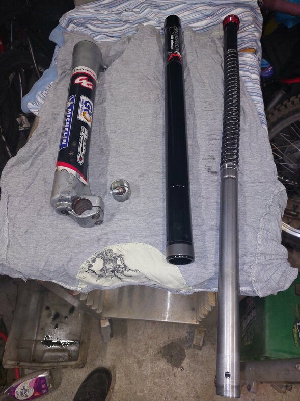

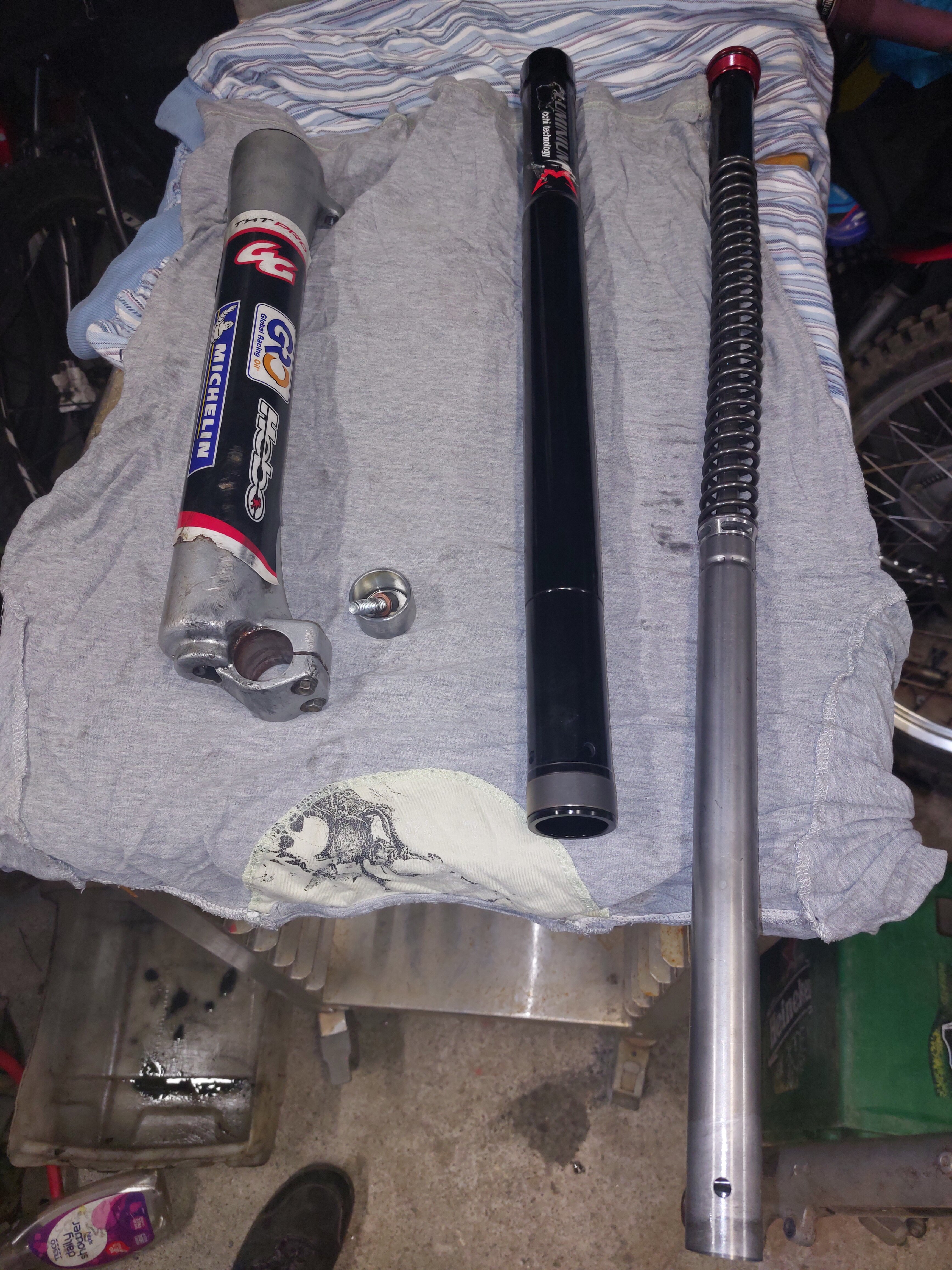

September 30, 20224 yr Author OK so here's what puzzles me.... I fully stripped the rebound side. Pushed the rebound piston up and down loads in fresh air ie all the oil removed Reassembled and re built bike expecting a clunk, but nothing. All works fine ??? 😕 confused

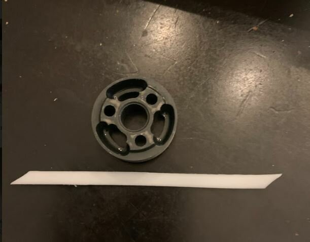

February 24, 20233 yr So I finally solved my rebound "clunk" issue. Guess what it was? The teflon sealing bands on the mid valve and "bleed piston". Thanks to Paul Amott at The Hell Team for posting this video and providing specs on how to make your own teflon bands (since you can't buy them anymore). I was pulling what hair I have left out trying different bleeding procedures without luck. Can't believe it was something so simple. Paul is so knowledgeable, he also told me that when gas gas was selling the wave washer (BT280614101) they wouldn't bend them. Only Marzocchhi did that and of course they are out of biz. Anyway can't thank The Hell Team enough, really glad I finally solved it. My new hand made teflon strip Here is link to Paul's part 2 of the service of Zoke forks
February 24, 20233 yr Author What is the noticeable difference when you fixed them? Obviously no rebound clunk but does the rebound work a bit better,? Thank you
February 24, 20233 yr Hey Gary, use a flat 1mm washer but make sure you bend it down the middle a little so it pushes the other washer up against the valve. I haven't ridden the bike yet but it was really soft/springy before because of all the air in the cartridge. Will post reply once I ride it!
April 3, 20233 yr Feels much better! I believe the worn "seal bands" and resulting "clunk" on the rebound fork was having the same effect of way too much air vs oil. So now instead of it feeling like it had very little to no rebound dampening, it is well controlled and compliant on obstacles. Very happy I FINALLY figured it out after years of bleeding the closed cartridge different ways.
