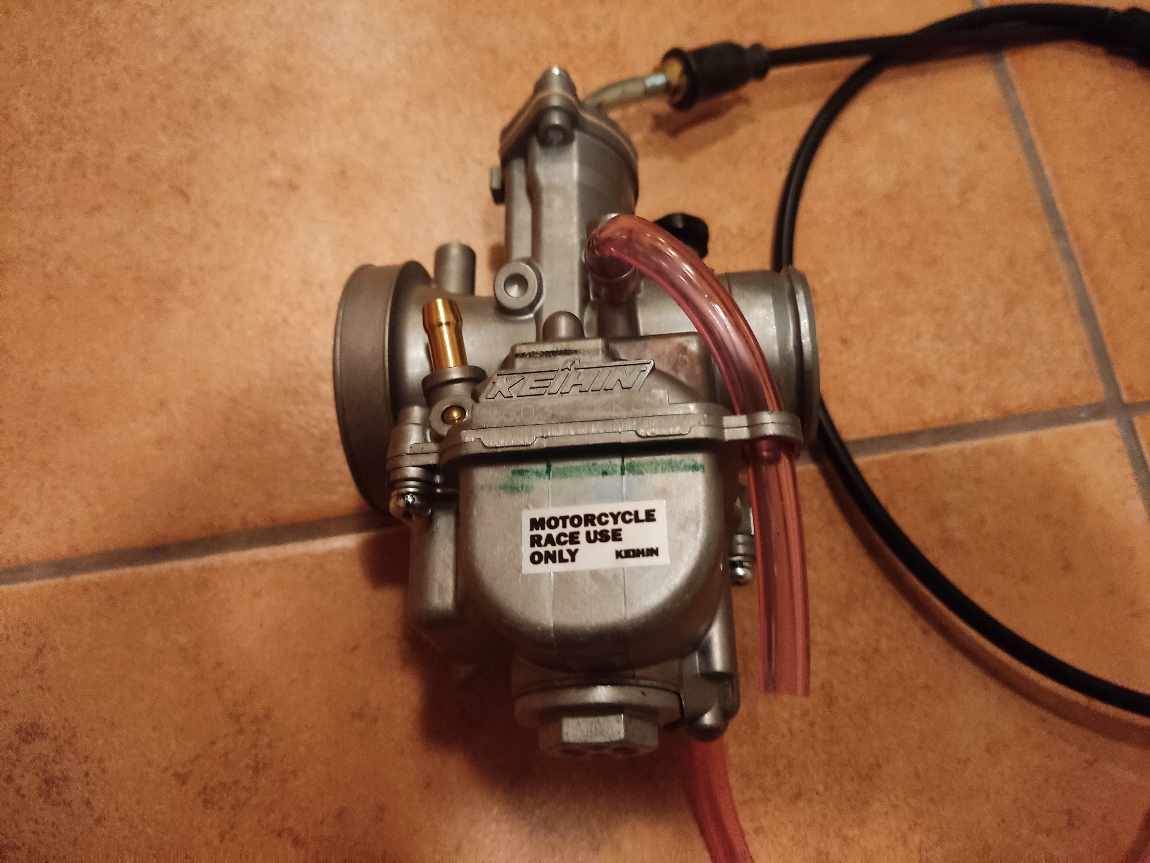

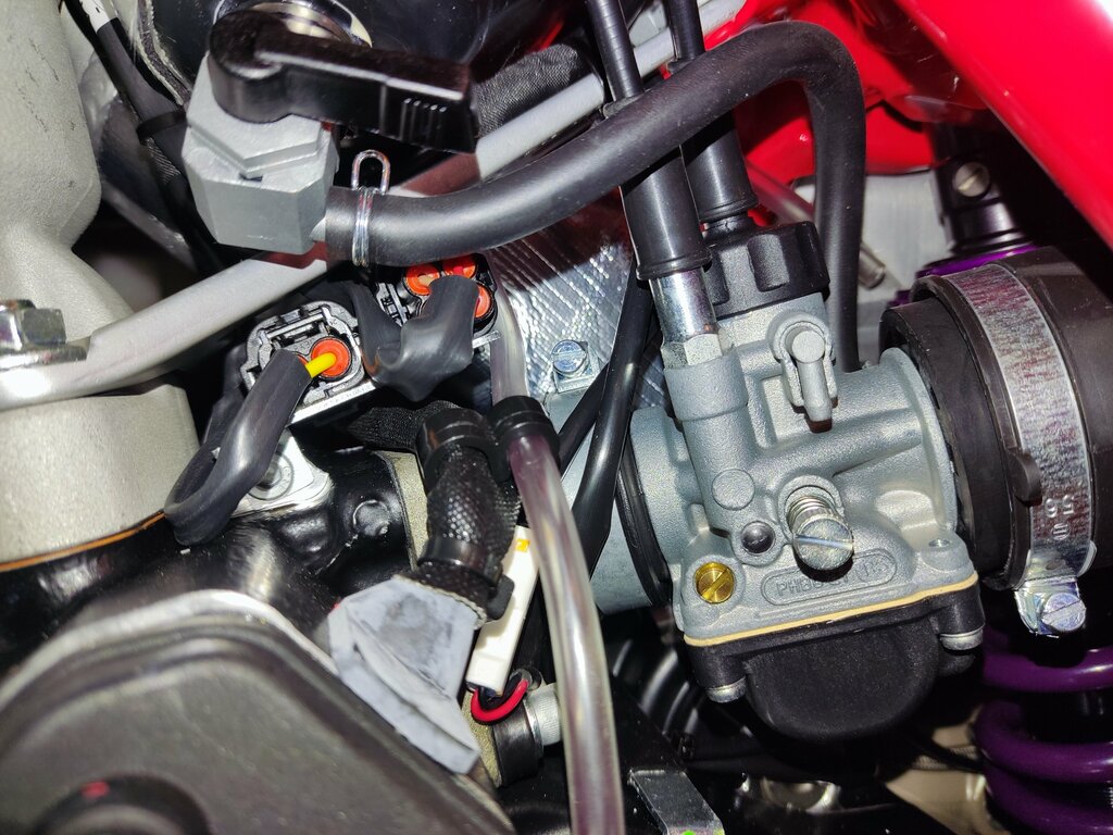

they look a bit different, size similar. Road legal one has 2 cables coming off it, racing one only throttle.  jets probably different as well,   When I remove it I will post pics.
below are pics or racing carb and road legal which is currently installed.
Wondering why throttle cable is also different?    on the racing one in the end is a ball not cylinder.
Well, the top ones a Delorto and the bottom ones a Keihin, so they'll take different cables ... if it was me I'd stick to the Delorto, rebuilding Keihins is a massive pain in the backside
But I guess performance is much better with Kehin, that's why they put both in the package.
