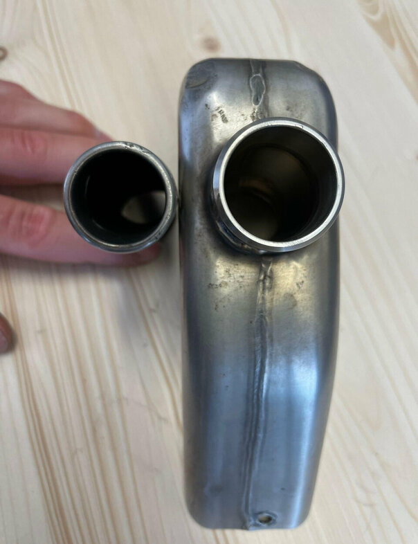

luct4 Posted April 3, 2024 Author Share Posted April 3, 2024 I'm also going to do a modification for the exhaus and see wath the benefits are. Quote Link to comment Share on other sites More sharing options...
