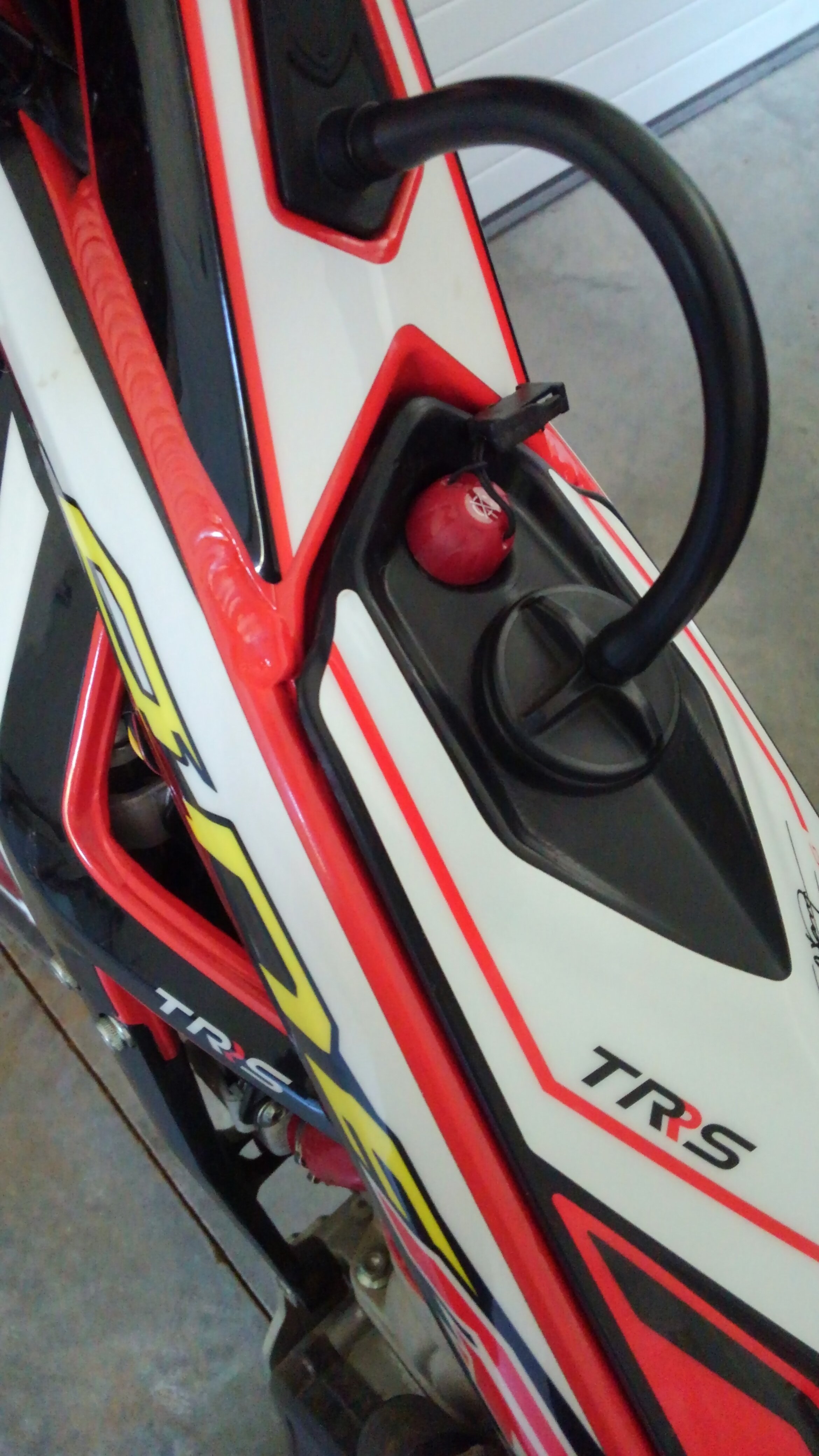

December 9, 20232 yr The elastic can be replaced with boot lace to stop. . . Well, use your imagination I was given a small magnet to stick on the frame of my GG . Makes an excellent back up. A friend lost a lanyard from my spare bike. We never found it. Must try find a place to stick it on my TRS, but steel is hard to find on it.

December 10, 20232 yr 8 hours ago, F5Dave said: Must try find a place to stick it on my TRS, but steel is hard to find on it. This works for me:
