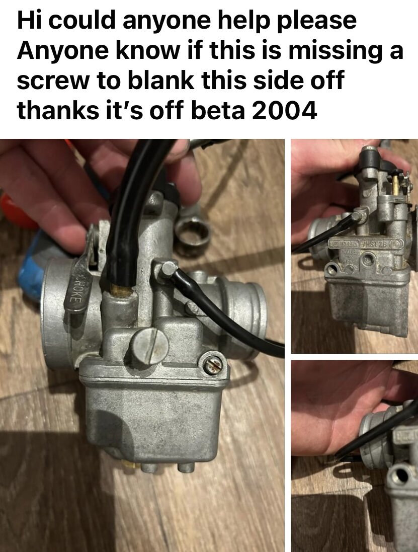

Hi just wondering if anyone can help I have a beta 125 2004 trials I went out today and revs stuck on full and I pulled kill switch no joy still didn’t cut out so had to put ht cap off checked carb and throttle in fine not stuck not nicks in cable slider hits bottom carb fine soon as I start it just revs up full any ideas thanks

First off that is not the stock carb. That vent line, does it have a hole in the middle? If not cut iy in half, its not venting. Take the carb apart and blow contact cleaner threw that hole to verify.
Hi thanks for reply I did search the internet and said was stock carb ? I’ve cleaned the carb throttle nice responsive everything working good nice and clean now just unsure if there is ment to be screw in the hole with threads thanks
Hi thanks for reply I did search the internet and said was stock carb ? I’ve cleaned the carb throttle nice responsive everything working good nice and clean now just unsure if there is ment to be screw in the hole with threads thanks and the vent line has hole cut
@Branny Beta OEM is usually a Mikuni carburettor. you cannot go wrong with blanking that hole on the VHST  carb you have fitted to your Beta  as it is only for use with bikes that have the exhaust mid box on the right hand side of the bike for example a GasGas.. just plug it with something .

Although that carb may well not be original, if it's been running fine previously with that carb, then you don't necessarily need to change it for an original carb - just find out if it is a fault with the carb that can be repaired - like the missing blanking screw that has been suggested.
