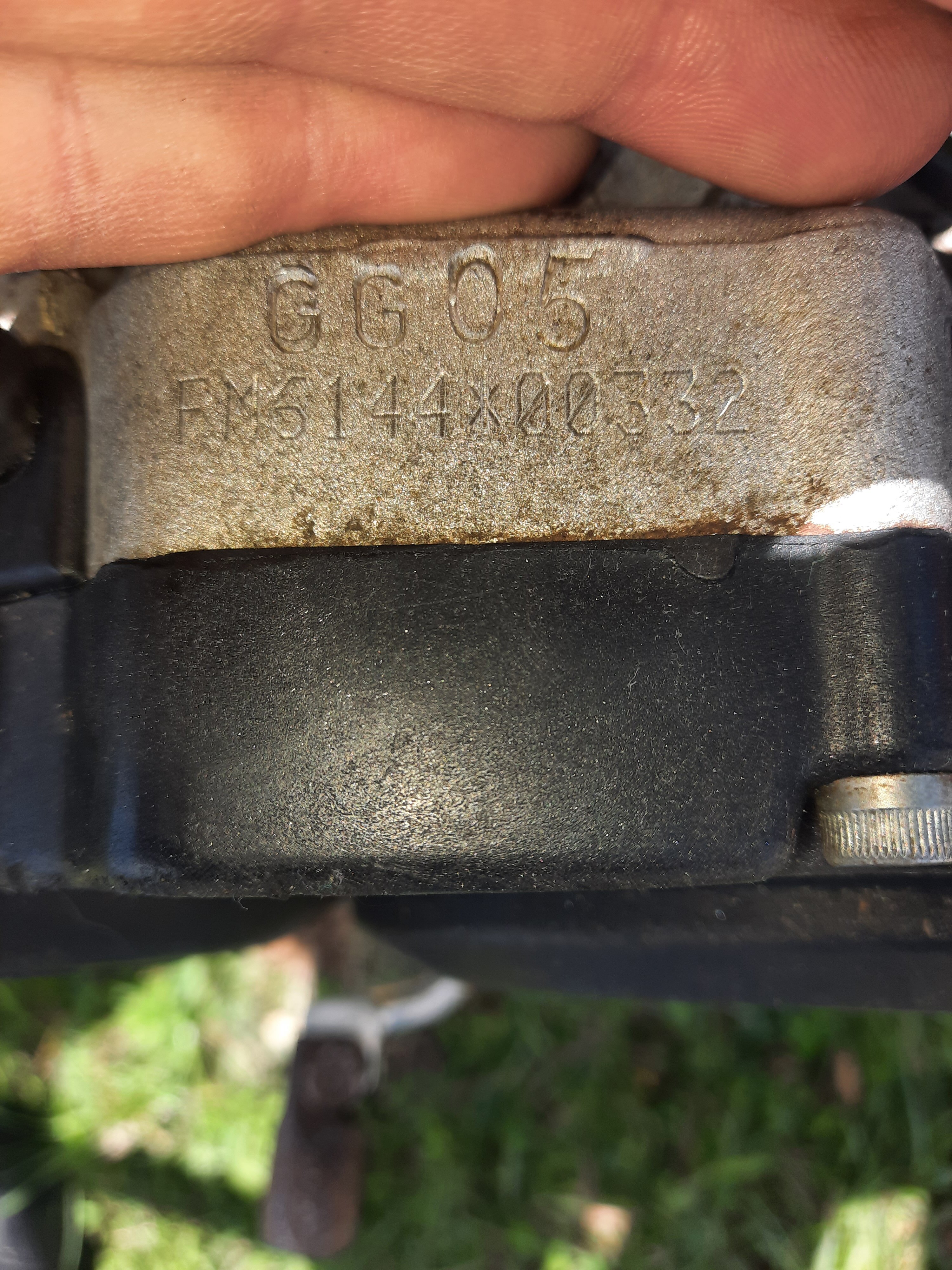

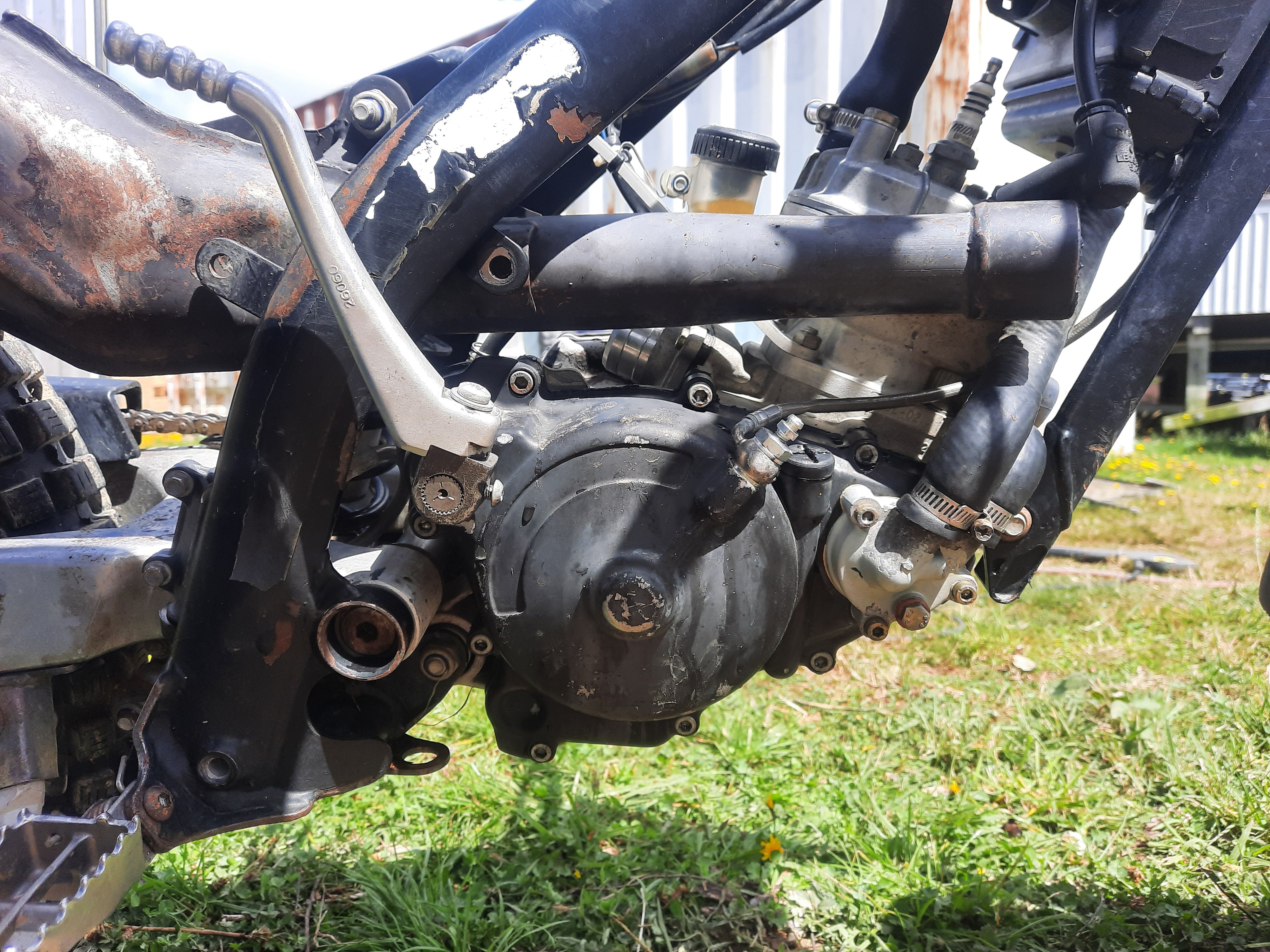

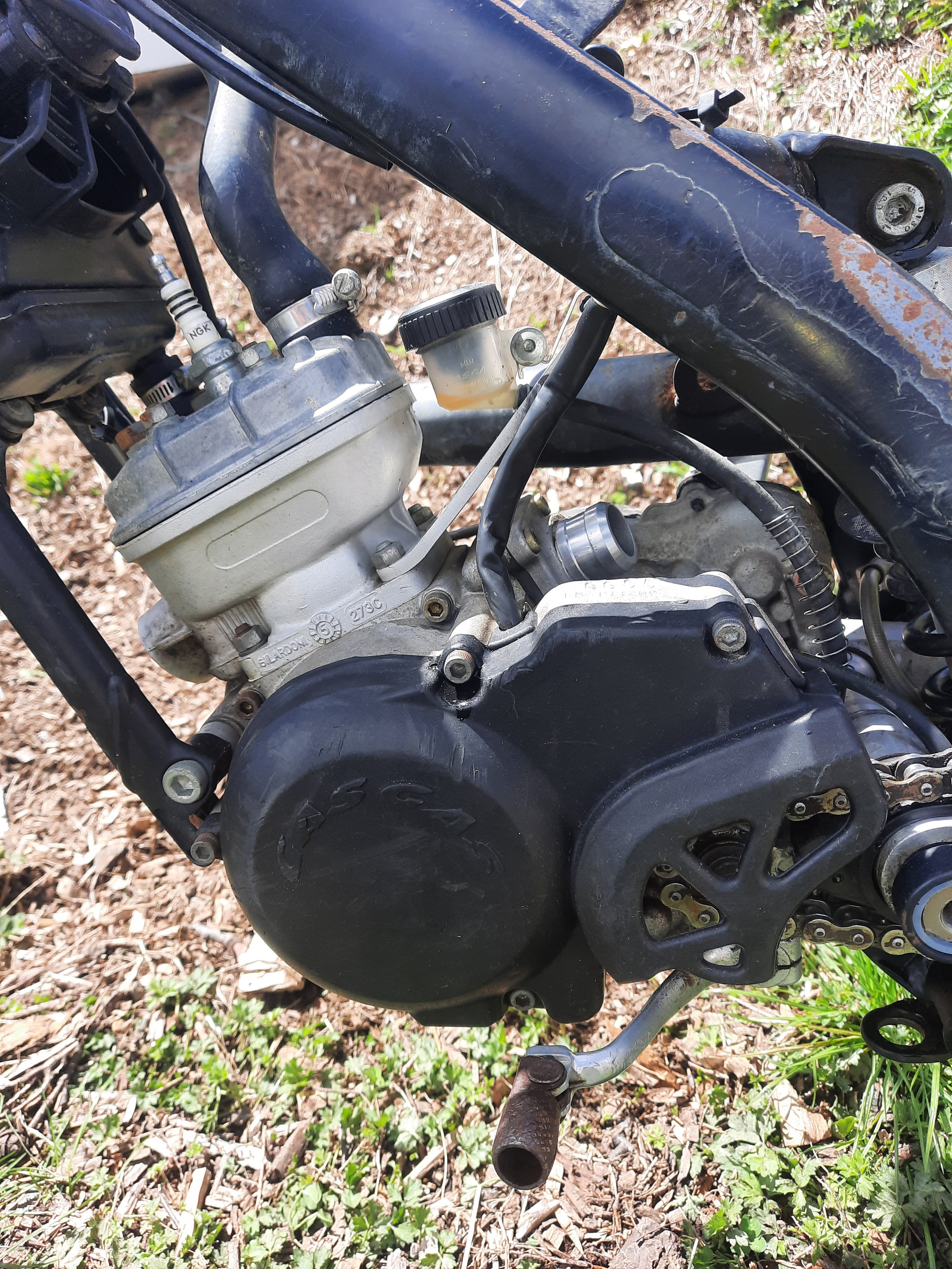

trialsdan773 Posted March 3, 2024 Report Share Posted March 3, 2024 Hi. Iv got a gasgas 50 txt rookie, 6 speed. I'm trying to figure out if the engine is a 50cc or a 65cc, as online these engines are a, franco morini m-65c motor. Can anyone shed some light. Thanks Quote Link to comment Share on other sites More sharing options...
Brappo Posted 4 hours ago Report Share Posted 4 hours ago This is a 50cc since the cylinder code is 273C. The franco morini m65-C engine has the cylinder code 273E, pinasco 74 has the code 273A, italkit 74 has the code 273D and polini has the code 305. The code is printed on the right side of the gilardoni writing on the cylinder. Quote Link to comment Share on other sites More sharing options...
