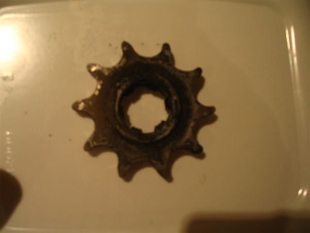

Here ya go, not a great photo, but may give you an idea:
This is totaly knackered. Took it too far really, but this was clicking like hell towards the end of the trial.
Put a new chain on it and chances are it would crunch and take the ends of half the teeth off.
Yeah mine looks a bit like that, gonna replace the whole lot, front, rear and chain
Will let you know if it cures it.
Cheers! :thumbup:
