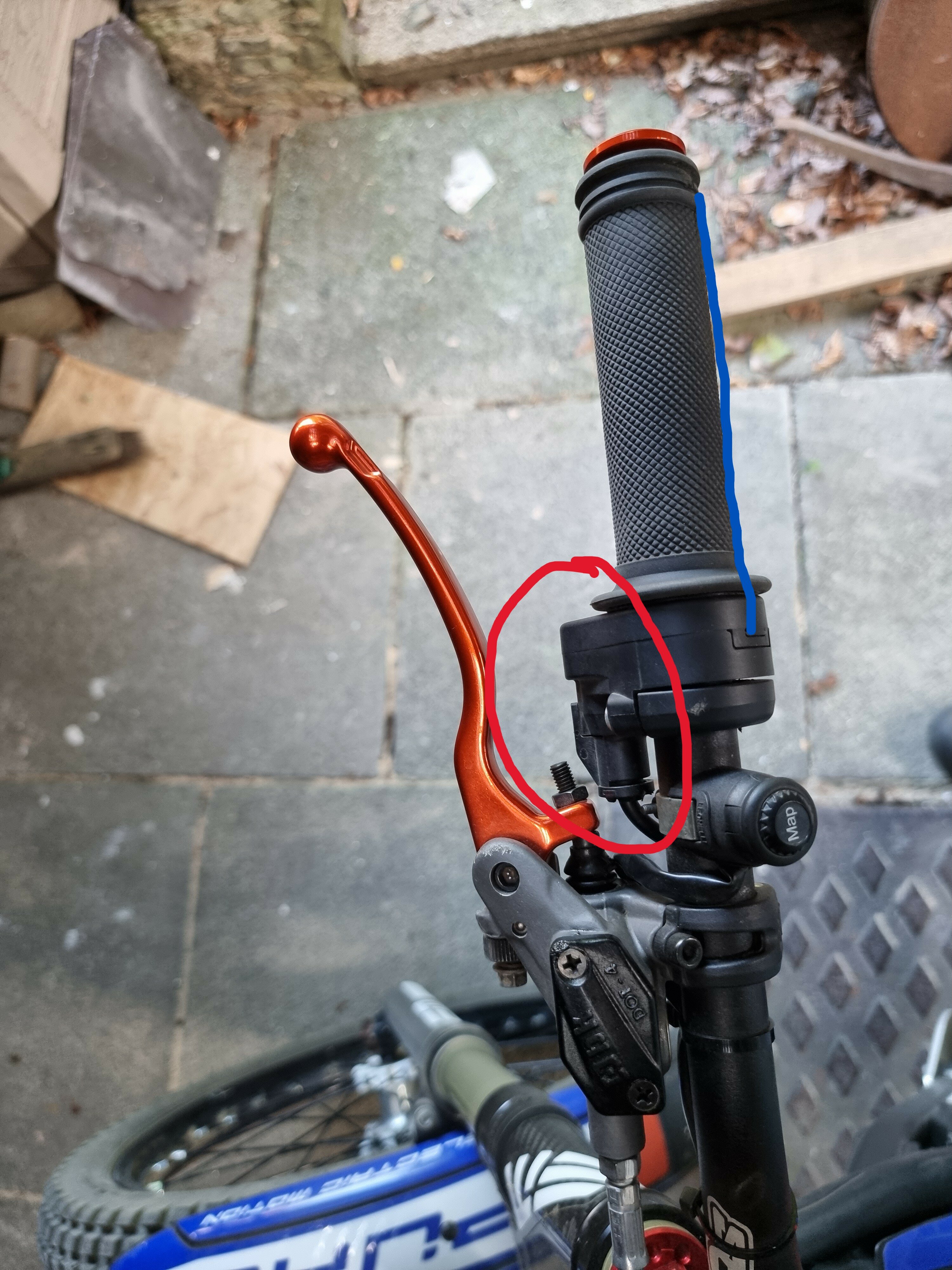

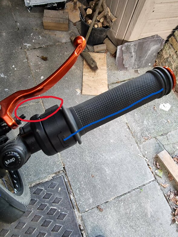

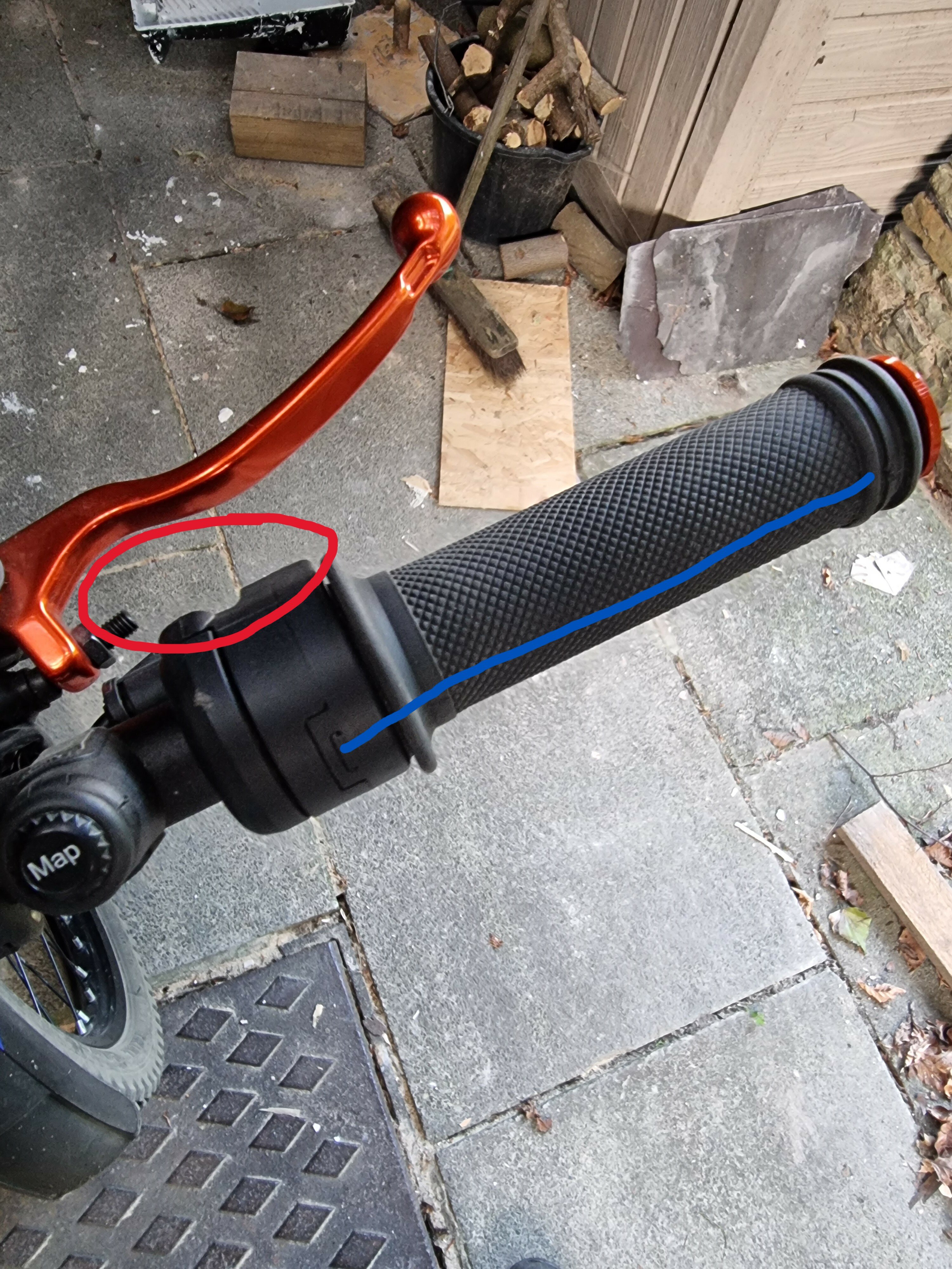

WIX-ONE Posted May 13, 2025 Report Share Posted May 13, 2025 I'm asking the question first before i attempt to open it up. Is it possible to adjust the rotation of the throttle so the housing with the wire can point in a different position. I'm thinking this has been done to my throttle already as the open and closed positions differ from the other bike i have and this one will clash with the brake adjuster if i put it in the position i need it. Currently the closed position lines up with the clip on the housing body (blue line) whereas i need it to be the open position lining up with the clip so the main part of the housing points down rather than being where it is clashing with the brake lever. I hope this makes sense, pics attached to try and help Quote Link to comment Share on other sites More sharing options...
konrad Posted May 13, 2025 Report Share Posted May 13, 2025 All you need to do is loosen the two screws that clamp the throttle to the bars. Rotate the entire throttle assembly to the position you want, and tighten the screws. Quote Link to comment Share on other sites More sharing options...
WIX-ONE Posted May 13, 2025 Author Report Share Posted May 13, 2025 Thanks mate On further inspection its another case of me making something far more complicated than it is Quote Link to comment Share on other sites More sharing options...
