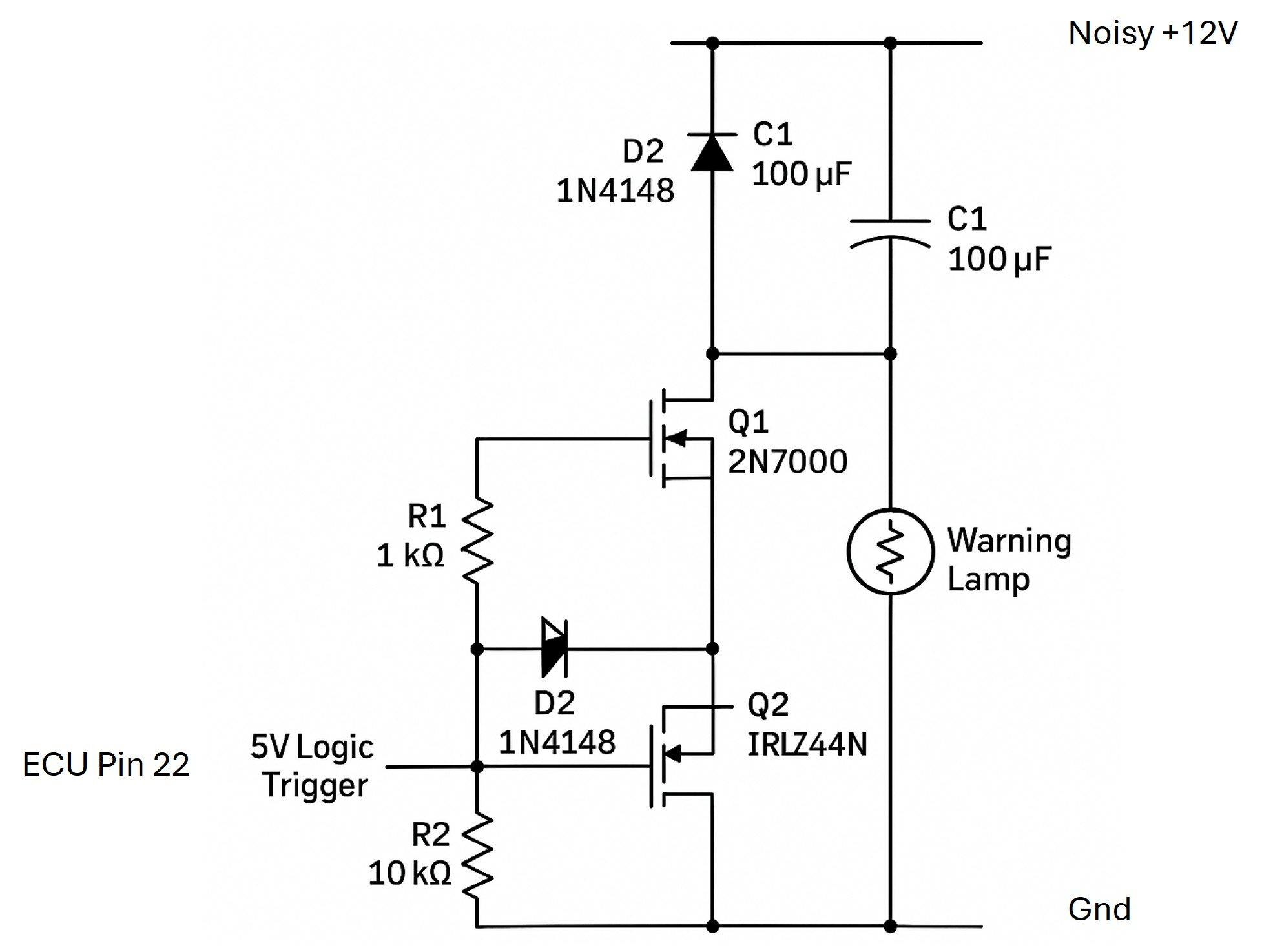

tinwelp Posted June 29, 2025 Author Report Share Posted June 29, 2025 This should work with a high impedance input from PIN22. I'll build it in the coming days and see if it is a viable solution. Cheers... Paul Quote Link to comment Share on other sites More sharing options...
konrad Posted June 29, 2025 Report Share Posted June 29, 2025 (edited) 6 hours ago, tinwelp said: Am I correct to assume the 5V is relative to the ECU ground on PIN10? Yes, but I would advise caution. Pin 22 is driven by a component (Rohm SP8K22 dual N-channel MOSFET) known to have failed on at least 3 Explorers. This renders the ECU useless. I don't know of any trials model to which this has happened. I assume there is something about the Explorer wiring harness/easy start that's causing the failure, but I don't have one to investigate. Edited June 29, 2025 by konrad spelling Quote Link to comment Share on other sites More sharing options...
konrad Posted June 29, 2025 Report Share Posted June 29, 2025 5 hours ago, tinwelp said: This should work with a high impedance input from PIN22. I'll build it in the coming days and see if it is a viable solution. Cheers... Paul May I ask where you got that design? Was it done by an A.I. chatbot? Quote Link to comment Share on other sites More sharing options...
tinwelp Posted June 30, 2025 Author Report Share Posted June 30, 2025 I hear you. It's very much not important, so if the risk is high, it's off my list of stuff to do. The design came from my son... he claimed to have designed it, but I'll ask. Looking at it now with a more critical eye, I see several errors and issues, so probably best to junk it and start over. Cheers... Paul Quote Link to comment Share on other sites More sharing options...
