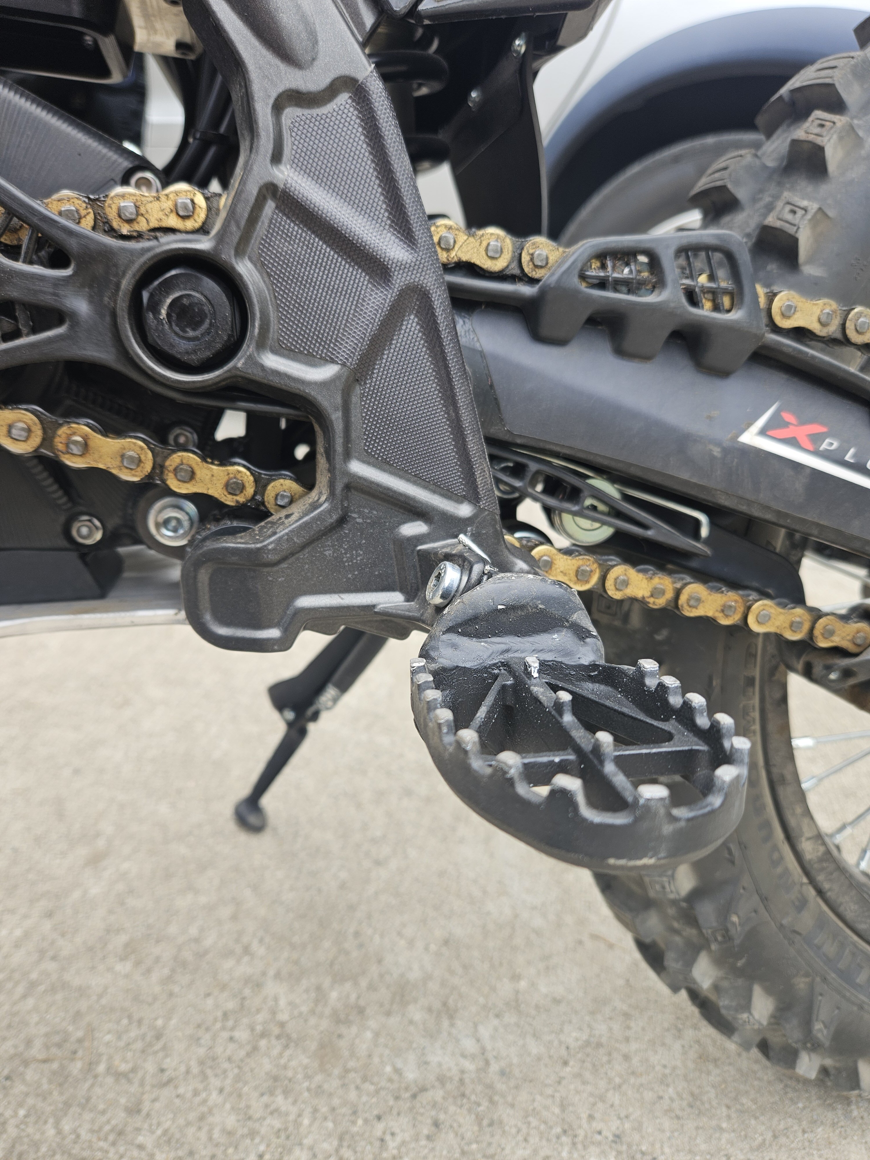

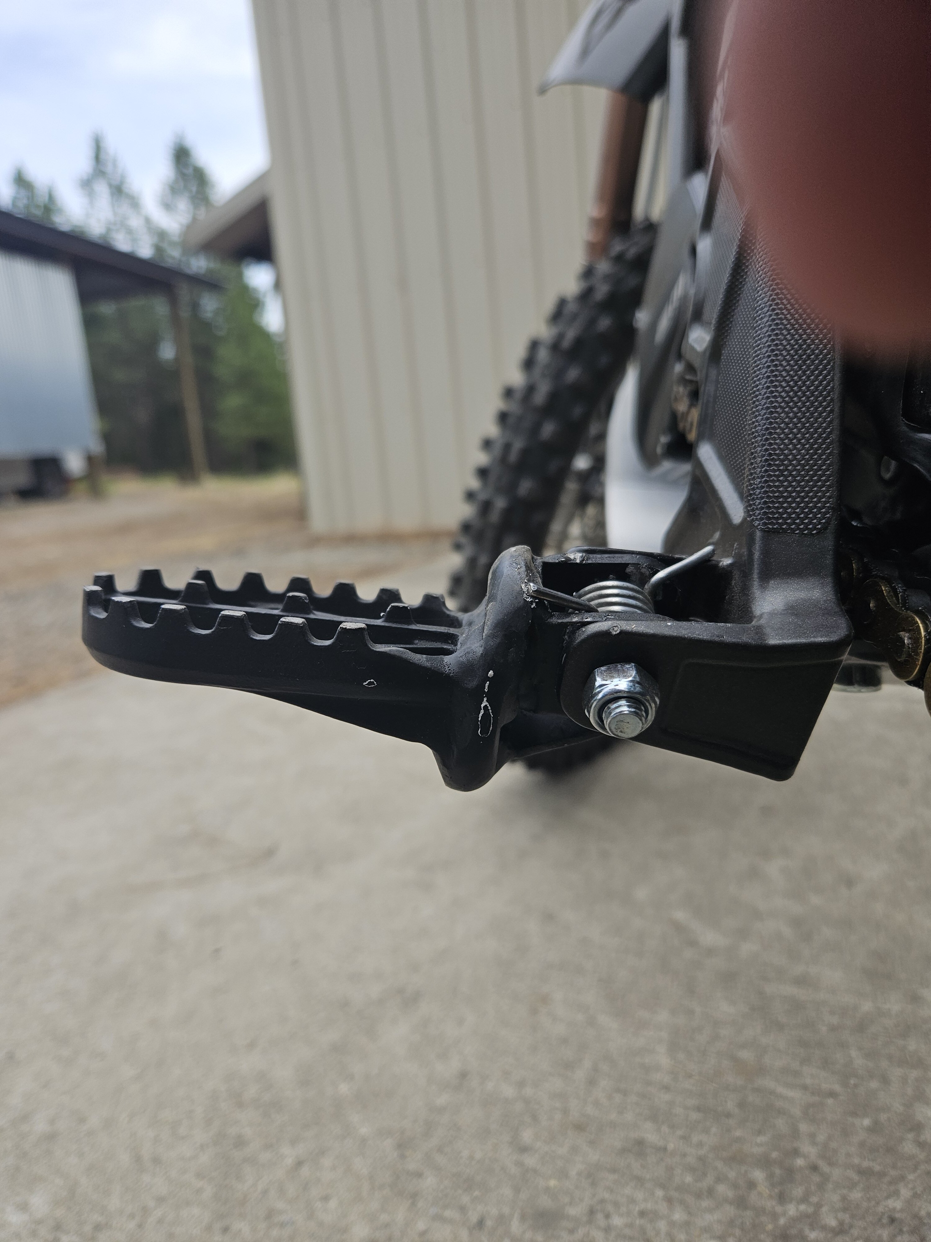

motovita Posted July 5, 2025 Report Share Posted July 5, 2025 Here are some footpegs that i cobbled together. They are crude and heavy but allow me to try different peg placement, they are about 1/2 inch (12-13mm) forward and lowered the same amount. I also did away with the forward slant of the stock pegs. They are much more conducive to sitting on the seat and transitioning between sitting and standing, they affect ground clearance very little. They are a big improvement for me, I hope to have a nicer set made, I'm happy with the forward position but I'd like them another 5-8mm lower. 1 Quote Link to comment Share on other sites More sharing options...
