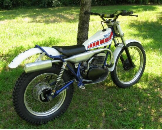

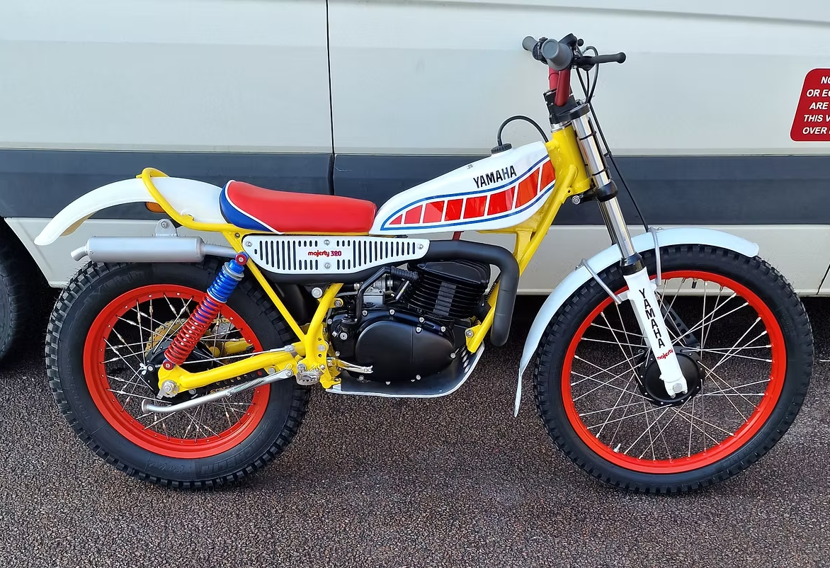

onefunride Posted July 29, 2025 Report Share Posted July 29, 2025 I really like the looks of the Shedworks Tank/Seat combination; however, I can't figure out if it is compatible with the 1974 TY250? I struggle to understand what is compatible with the rear fender that uses the fiberglass seat pan. In all the pictures I see it seems the models are later versions, with a different rear mudguard and I can't find this other mudguard for sale (I have the short mudguard where the air box is part of the rear mudguard). Is a different rear fender needed for this to work? Is the stock air box compatible with the Shedworks setup? I also see majesty style aluminum tanks that look good, they seem to use a different rear fender as well. I am trying to cut weight, have a more "sleek/narrow" look and feel to the bike. Thoughts? Which would be considered better, or is there another option to clean up the bike? Thank you Glenn Quote Link to comment Share on other sites More sharing options...
feetupfun Posted July 30, 2025 Report Share Posted July 30, 2025 (edited) For a slimmer look, you could fit the later model seat and rear guard. For an A model frame, this would need some frame tabs added for the seat mounts. The A model airbox is compatible with all known seat/tank/mudguard options. What you wrote about the airbox forming part of the rear guard applies to all TY250 twinshock models. The A model (and B model which was not sold in the USA) rear mudguard arrangement going from front to rear has airbox then seat shroud/fairing then short plastic mudguard. The C, D and E models have airbox then long plastic mudguard. If you want to use the Shedworks tank/seat, you will need to buy a later model rear mudguard. As for buying a later model (long) rear guard https://www.inmotiontrials.com/product/ty-250-rear-mudguard-white/ If you want it to feel lighter to ride, replace the standard exhaust with a WES exhaust. The later model TY250 fuel tank is made of aluminium and is lighter than the steel A model TY250 tank. Edited July 30, 2025 by feetupfun 1 Quote Link to comment Share on other sites More sharing options...
onefunride Posted July 31, 2025 Author Report Share Posted July 31, 2025 Feetupfun, thank for the clarification, it shed some light on my confusion. I do have the WES exhaust, and a few other items installed already. I have the forks setup using the InMotion aluminum damper rods and Trials France magical springs. I have an original fuel tank that is in fantastic condition, I am nervous about smashing it up, which sent me down the path of looking for a different fuel tank and possibly a weight saving in the process. The Shedworks tank and seat assembly looks fantastic, but it gets quite pricey to ship to the US. Interestingly, according to the internet the A version was lighter than the later TYs. Possibly a Majestic tank, long fender, and a late model seat with fiberglass pan could be a good option. Something like the attached pics. BJ Racing has a tank seat combination that looks much like the Shedworks, but I think it is all fiberglass and does not have the inner aluminum tank. http://bjracing.com/id121.html hard to tell. Quote Link to comment Share on other sites More sharing options...
