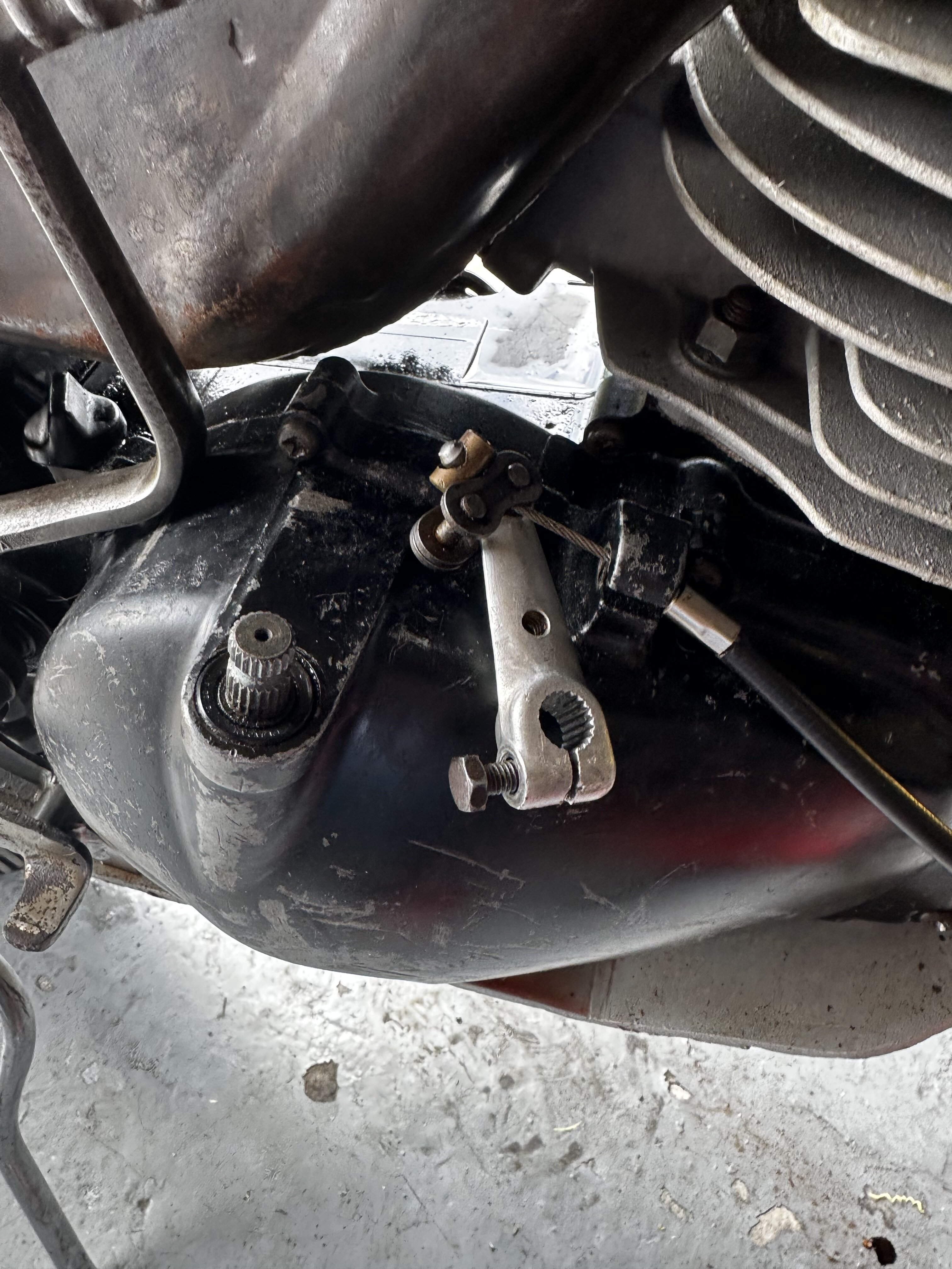

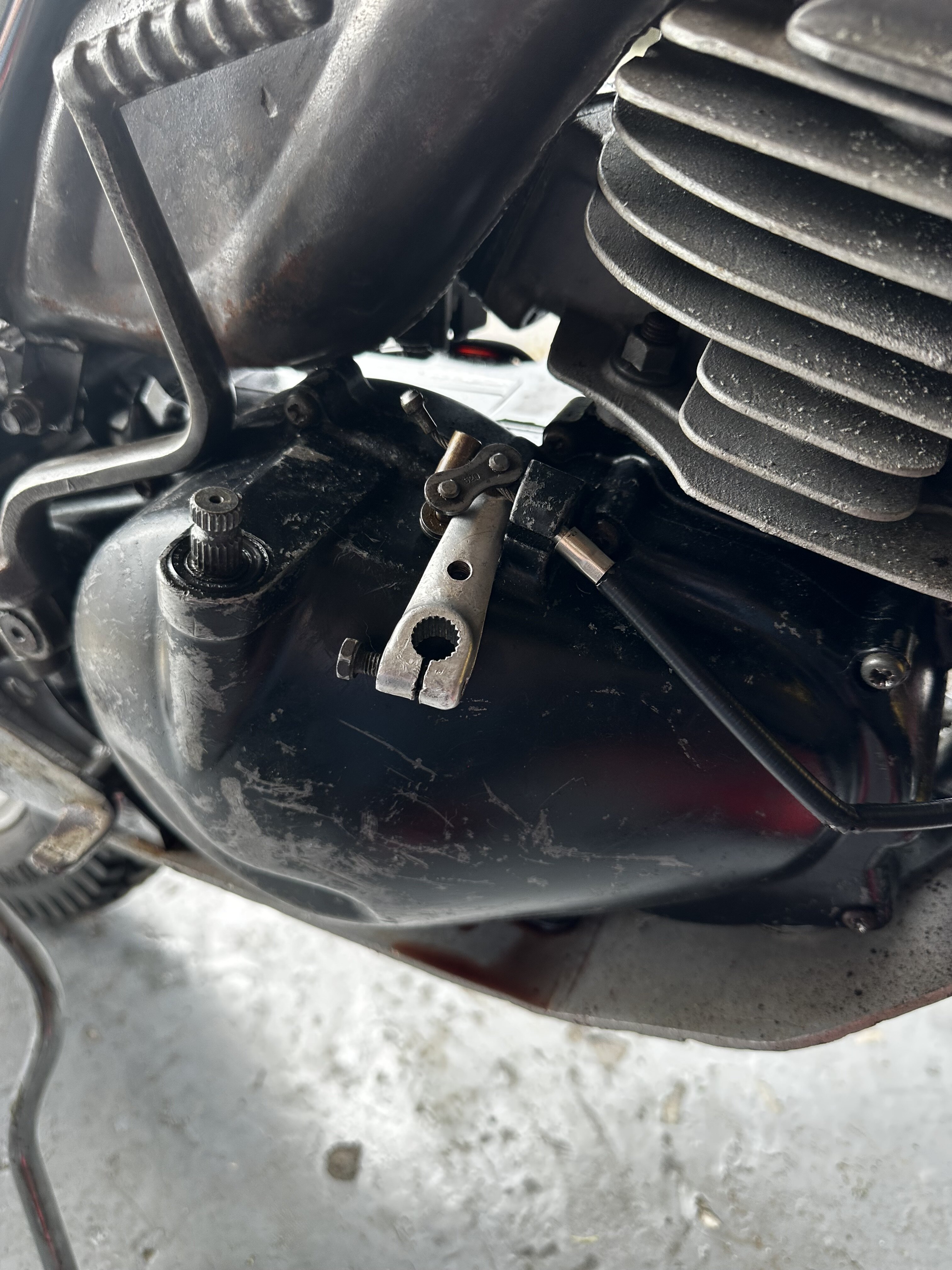

Beamishjersey Posted March 14 Report Share Posted March 14 Have issue with the set up of the clutch arm. Is there a process to line it up properly. Quote Link to comment Share on other sites More sharing options...
lemur Posted March 14 Report Share Posted March 14 The clutch cable is suppose to have a clevis on it where yours has a chain master link, your cable repair makes the cable too short, plus the bike will never work as good as with a new and correct cable installed, there is a visible kink in the one you have. Easy enough to find pictures on the net showing the correct clevis setup. Quote Link to comment Share on other sites More sharing options...
