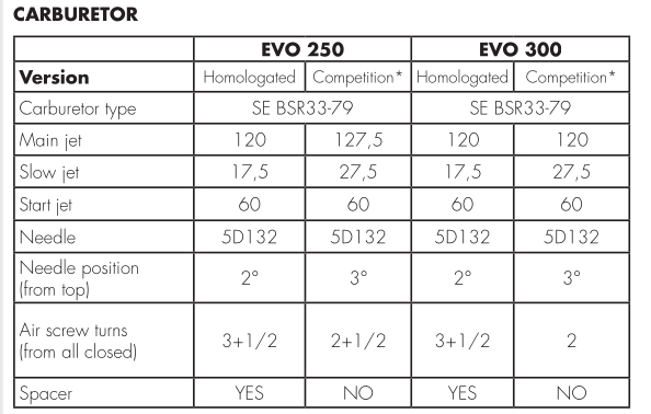

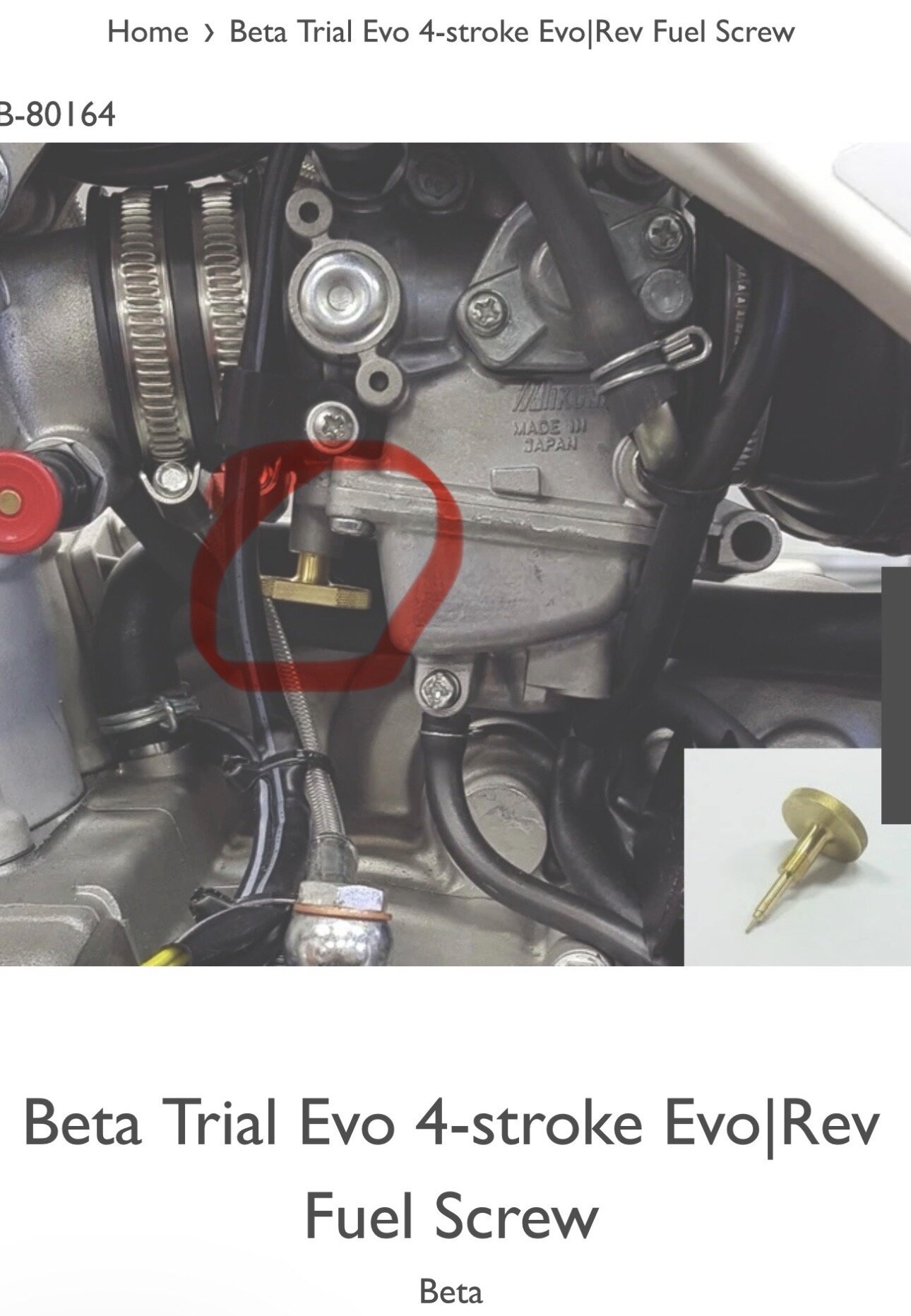

I have a problem with the carburetor on my beta evo 300 4t 2009 mikuini bsr se 33-79 I can't combine the gasoline and air The engine stalls at low speed Can you tell me how to fix it
