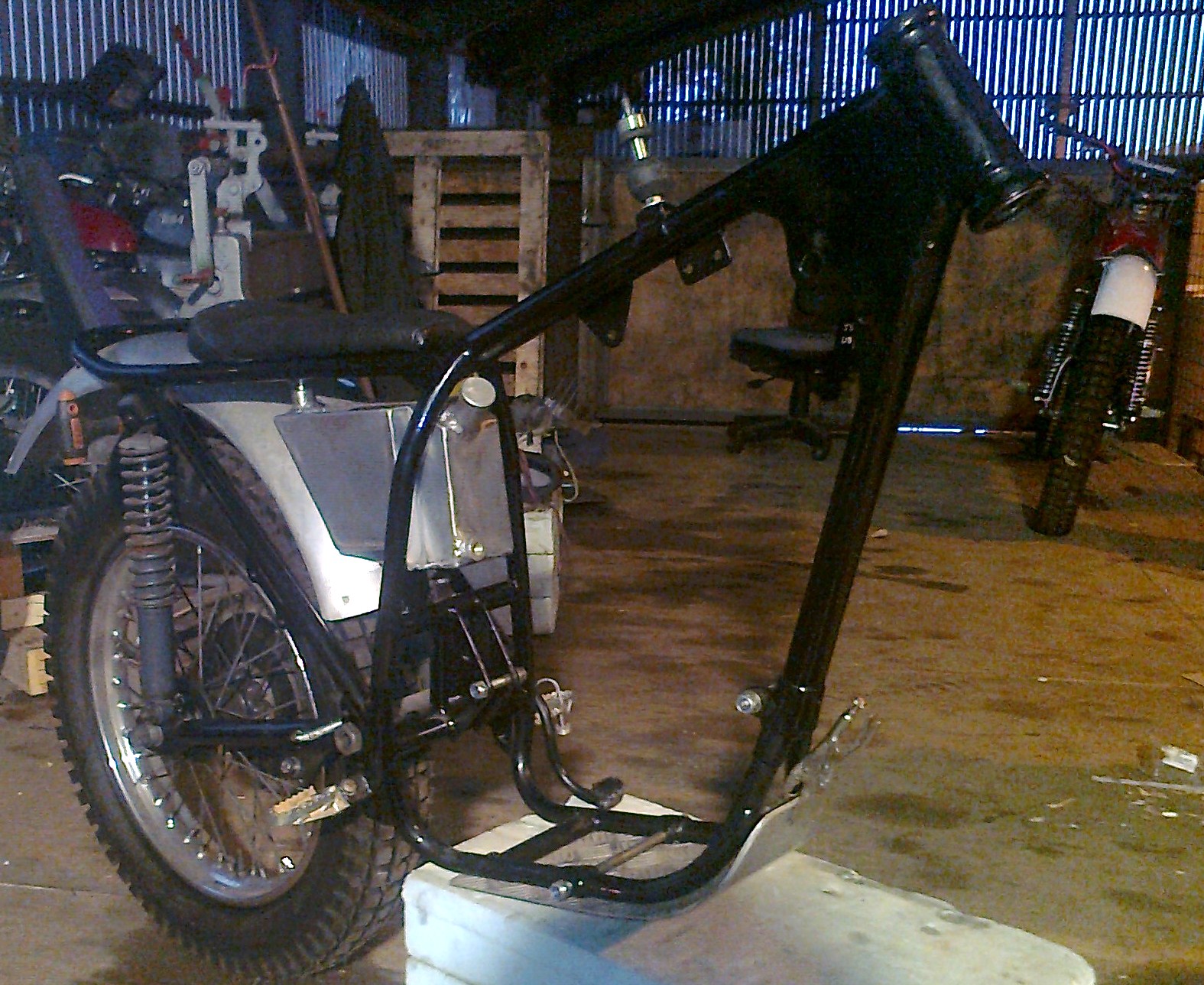

To narrow the frame you pull in the two seat down tubes to a narrower section at the top, you have to cut the tubes, take a small amount out, heat the tubes to pull them back in and then reweld. I will take a picture of one done today for you.

Picture has promised.
Regards Charlie.

Hi Charlie, New to this site. Can you help me, is the frame pictured legal for the Scottish Pre 65 Trial, thanks, Iain
