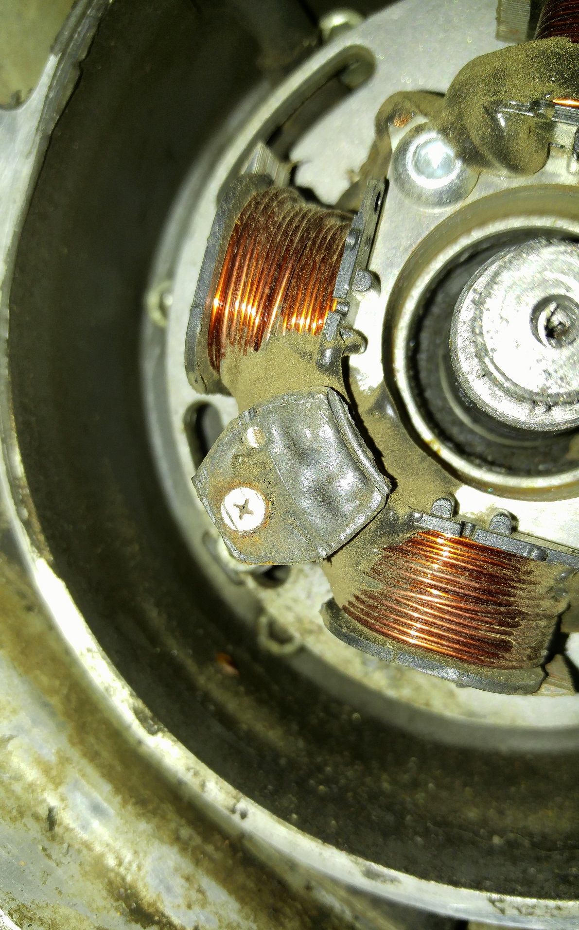

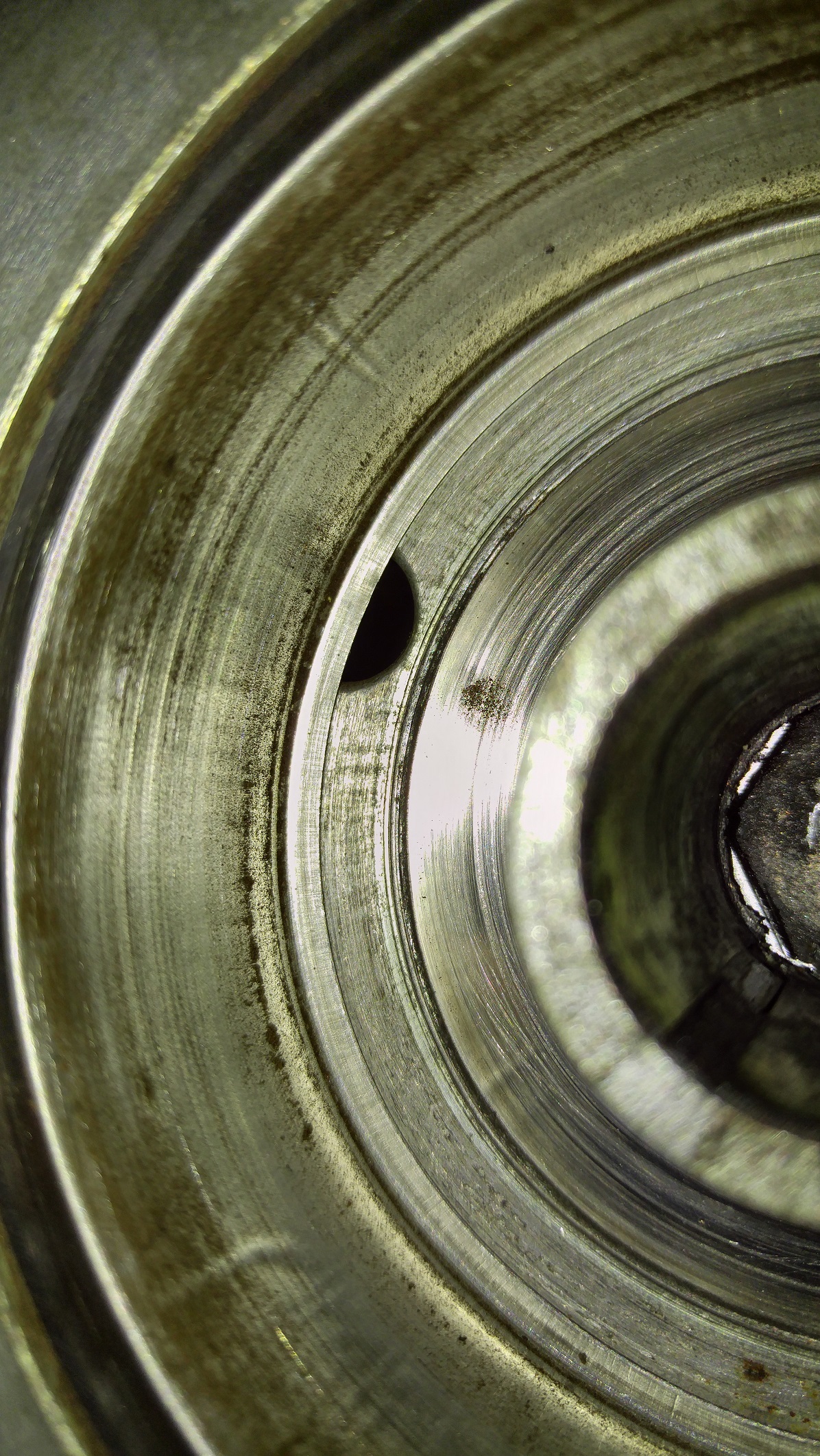

I'm finally home and ready to fix this bike! I pulled the flywheel today and it looks to me like the hall effect sensor has been rubbing on the flywheel. Does this look normal to you lot? Should the flywheel have the little ridge shown in the pic, partially covering the semicircular hole, or is this the result of the rubbing?

AHA! I think I found the problem. Sheared flywheel key.

Good that's something simple
In answer to your question about the partially covered hole in the flywheel, that is normal
